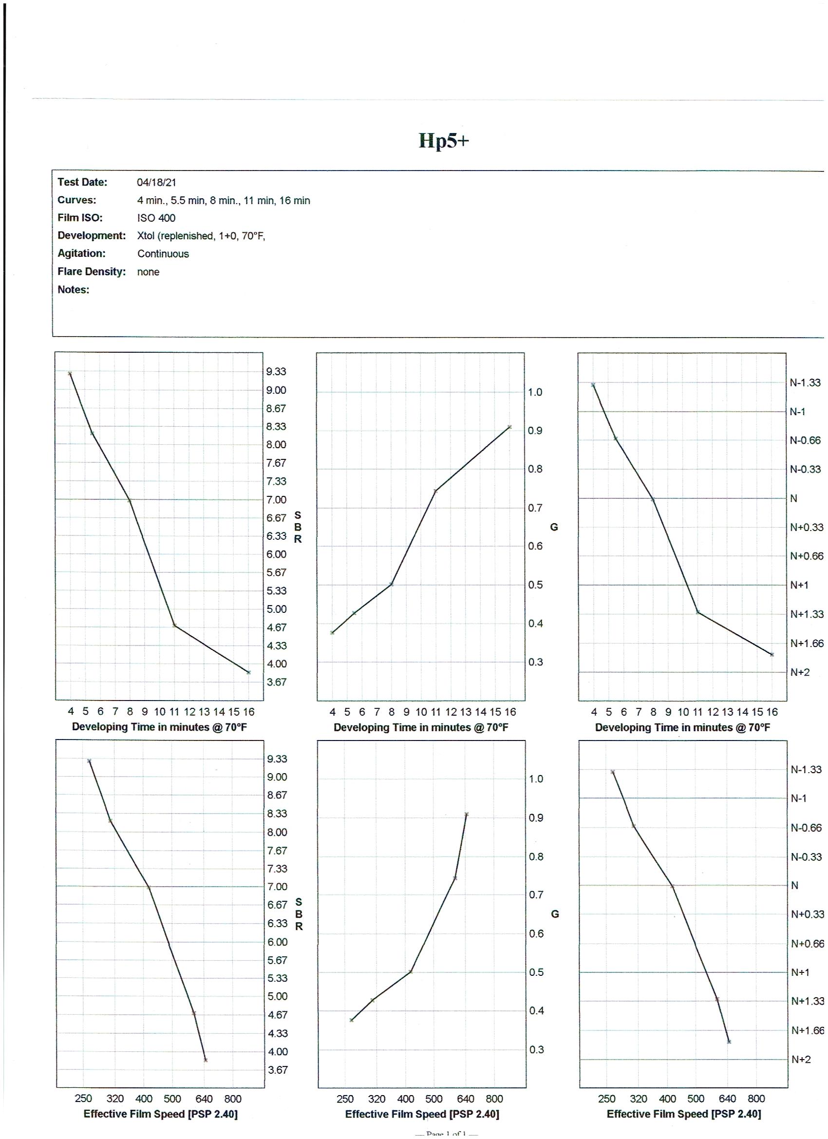

Here are the charts it gave me in replentished Xtol and HP5. Ignore the 70F temperature, I did it at 20C ( 68F)

The nice thing is all I need to do is meter the brightness range of the scene I want to photograph and then from the charts it can tell me the effective film speed for that particular situation, and the contrast index and developing time.

The practical result is my negs are much more consistent and easier to print since I started doing this. I also found for my methods anyway, that the Ilford recommended HP5+ developing time in Xtol was nearly a stop less than it should have been. I was losing shadow detail due to underdevelopment.
I gained a lot of useful information for the modest cost of 5 sheets of 4x5 film and some time.

I wasn't diluting Xtol. Recommended time at ISO 400 is 8 min, at ISO 800 it's 11 min. For the contrast index that is considered normal, I needed about 10 min.
