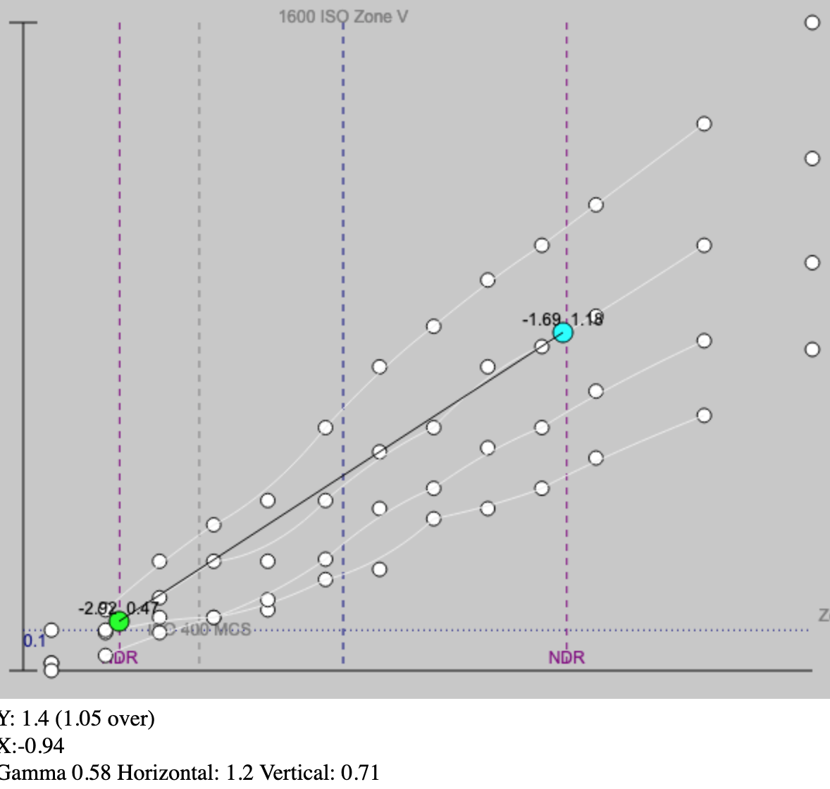

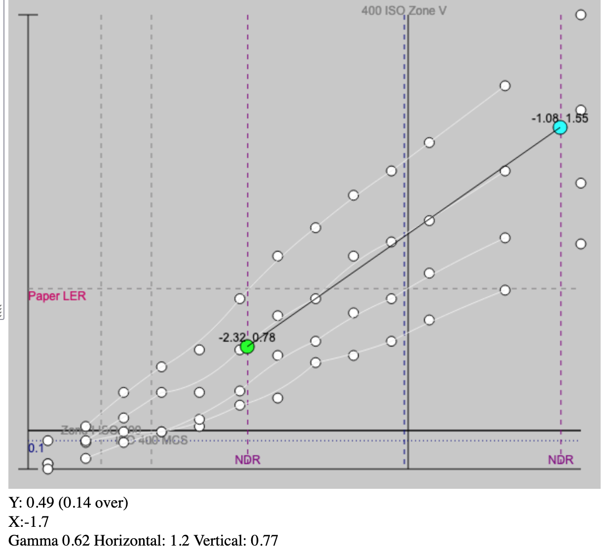

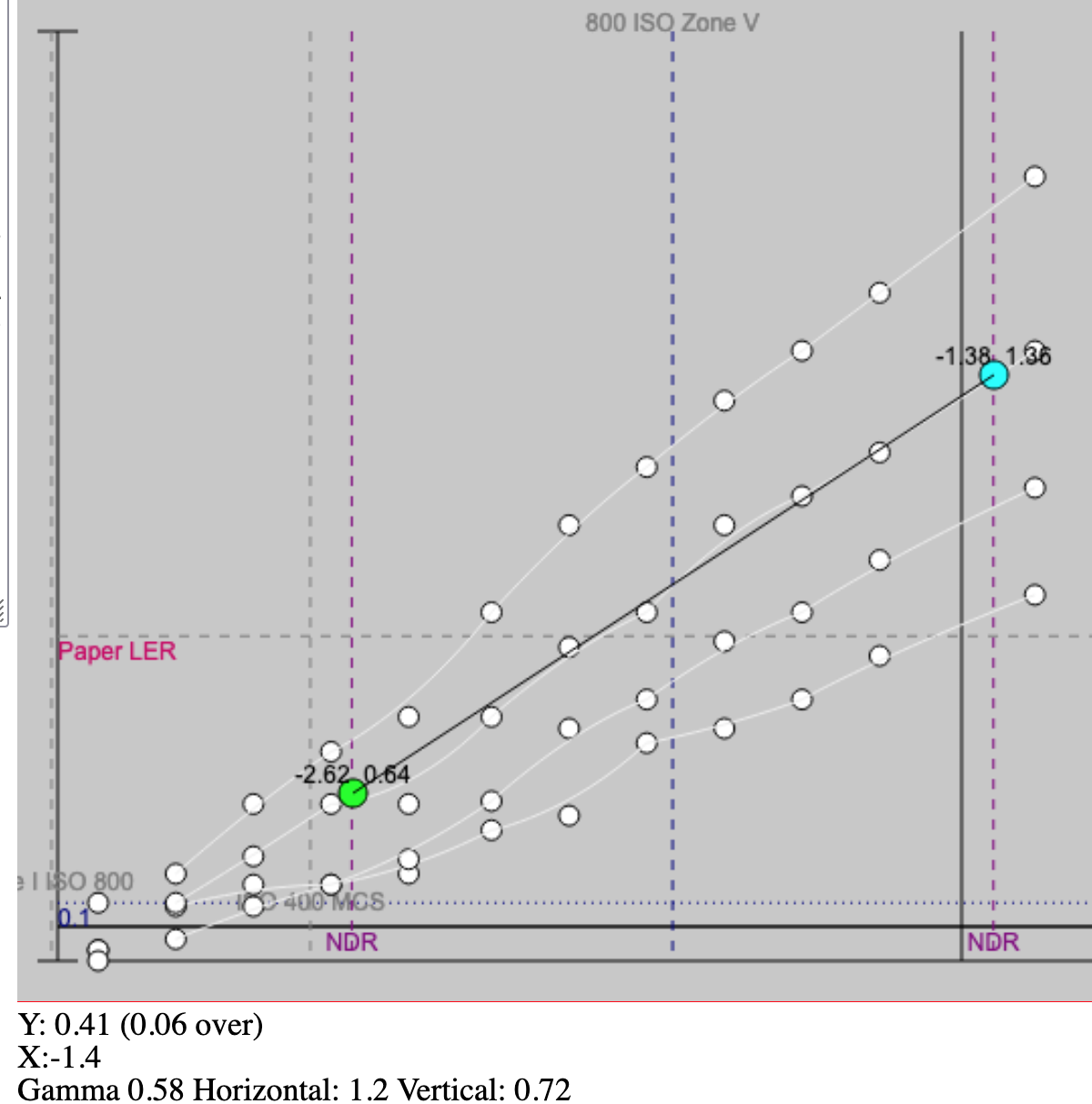

This might be really stupid question but I will risk it (again):
From my previous results we can see that the slope of H+D stays pretty much constant along the workable part of exposure. If I change my EI to 800 or even 1600 the negative density range (for 7 stops SBR) still stays in the linear part of the film. There is plenty of room to play.
My question is that why would I change my development time if I get same contrast with EI 800 and 1600 ? Of course my overall density changes but it only changes printing exposure times, right? Ok, I got CI 0.62 at 400 and CI 0.58 at 800 and 1600, but I think that is so small difference that there isn't need to compensate that. Printing is still within normal grades.
Or have I understood something completely incorrectly?
EI 400:
EI 800:
EI 1600:

You’ll notice how close you are to the toe when you consider 7 stops of subject luminance range at 1600. The longer development time helps improve image quality down in the toe. A photograph taken at the 1600 setting might place shadow exposure lower than you planned.
You could definitely take some actual photos and plot parts if the pictures on the graph of its development curve, then you will see how well your planned exposure fit the model.
I did that here:
https://beefalobill.com/imgs/tmxaim.jpg
