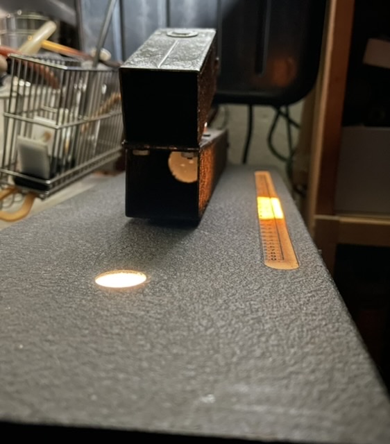

A purely optical visual densitometer is as accurate as the operator's ability to discriminate fine changes in density. The density tablets are usually silver-gelatin or lampblack-filled gelatin, so it shouldn't fade in normal storage and usage.
The Physikalisch-Technische Bundesanstalt in Germany uses (or used up to the 2000s) a reference densitometer based on the inverse square law. There's a detailed paper on its construction and calibration but it's sadly behind a paywall.

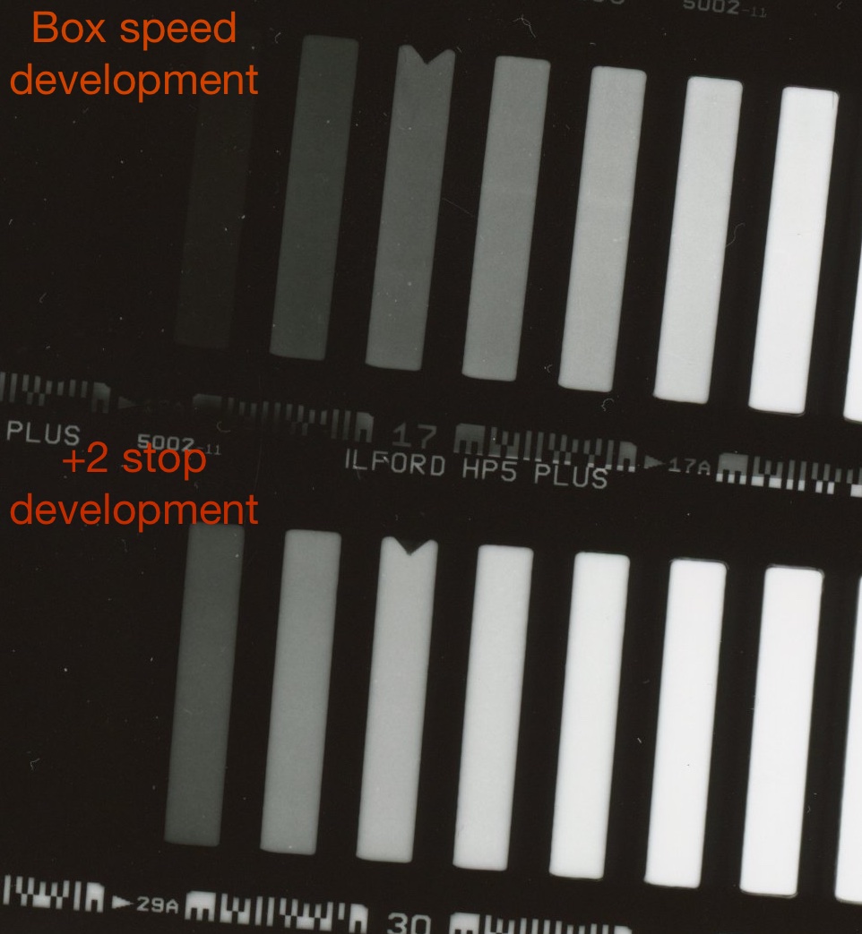

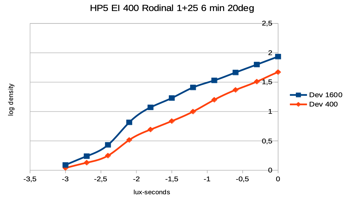

Ok, adventure continues :smile: Making some science that has been done maybe thousand times before!
First "real" test, how does development affect to density. Otherwise identical but varying development time: 6 minutes for box speed and 12 minutes for "pushed" 1600:

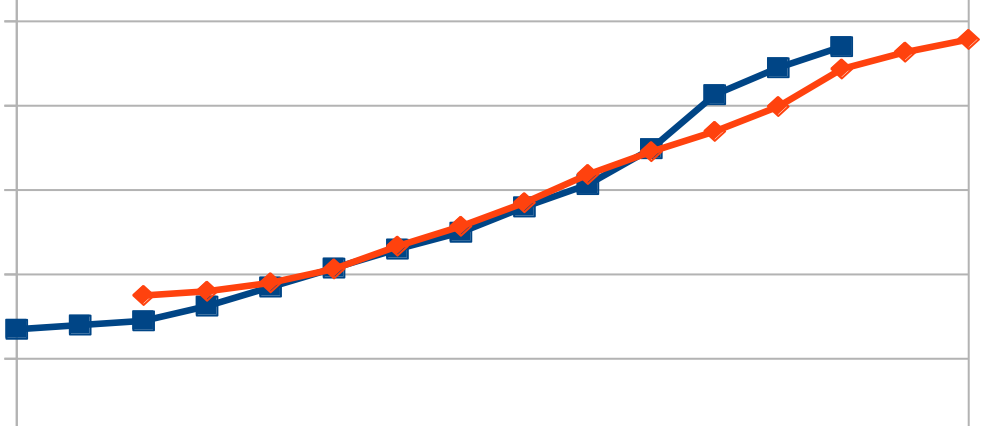

Lining up densities with 2 stop shift-correction shows that the midtones are pretty close to eachother, so the "overdeveloping" amount is very close to correct:

Here is contact print I made from these two strips. Approximately with grade 2-3 :

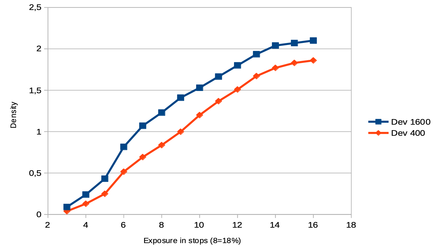

I try to compare my results to other graphs but there is some bump in low tones. Could only Rodinal as developer explain this? I'm comparing to Adrian Bacons graph: https://i0.wp.com/adrianbacon.com/w...nished-XTOL-24C-7_30-JOBO-Agitation.png?ssl=1
I converted stops to lux seconds (0.3 lux seconds = 1 stop in exposure) and tried to plot same range as Adrian has plotted. I don't know if there is some kind of standard what is the zero of X-axis? Probably explained in the book next to me :D
Any thoughts?

For me the most interesting test has been overdeveloping + its effect. I've always wanted a controlled way to see what actually happens to contrast if one overdevelops.
I'm analysing the two strips (box speed) and then +2 stops overdevelopment (2x more time).
I chose +3 .. -2 stops range from 18% for my analysis area. A bit low in contrast for "normal" scene but lets start easily.
f-stop difference:
box = 2,84 / overdeveloped: 2,84
ISO-R:
box = 48 / overdeveloped: 54
This would require grade 4-5 printing for both. No dramatic change in grade here.
Ok, lets pick more dynamic area (8 stops) (+4 / -4 from 18%):
f-stop difference:
box = 6,13 / overdeveloped: 5,25
ISO-R:
box = 87 / overdeveloped: 105
"Box" would need grade 2-3 filter and overexposed grade 1-2 filter.
My conclusion: by overdeveloping HP5 by double time you need one grade lower filter. If this is true, then we can stop all discussion on these 10-20% increased development.
I must have made a mistake here ..

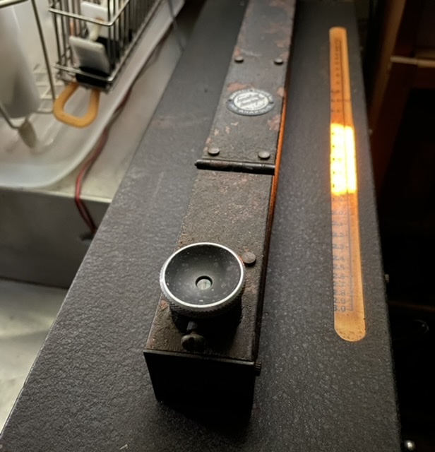

@radiant, I believe the PTB densitometer used a very advanced version of the original "grease-spot photometer" - by comparing a source of unknown intensity with a calibrated one and varying the distance until they are equal. If the emitter approximates closely a point light source, the relationship between distance and intensity is ideally an inverse square law.
The principle of a visual densitometer is simple.
You balance the light from two sides with no sample. That’s 0.00. Then put a sample in place and move the light closer to it until the spots match again. The distance you moved the light directly relates to density based on the law of inverse squares. The densitometer can’t go out of calibration.
In this design there is one bulb. Light from the back of bulb hits two mirrors and then comes through a tube to the front on top. Sample goes on the little light table. The bulb racks back to front over about one foot distance. Effectively light travels about a foot from each side for zero. But near density of 3.00 you roll the light bulb all the way to the front where it might be 2 1/2 inches from the sample, while the light from the back now has to travel about two feet.
Anyone? This bugs me, it cant be this way ..
Your 6 minute development time is near 0.5 contrast and your 12 minute development time is near 0.66 contrast.
With 6 minutes development the negative is so flat that 8 1/3 stops of subject luminance range fits Grade 2 paper. And with 12 minutes development you have a more contrasty negative that accommodates only 6 1/3 stops subject luminance range.
It’s like you found N-1 and N+1
Looking at the table you provide this would mean for 6 minutes the grade would be 2 and for 12 minutes grade would be 0.5? That is 1.5 grade change. Did you calculate the contrast from my data with 8 1/3 SBR?
What is wrong with my development if 6 minutes and 12 minutes only resolve to N-1 and N+1 (assume that is something like 10-15% under/over)?

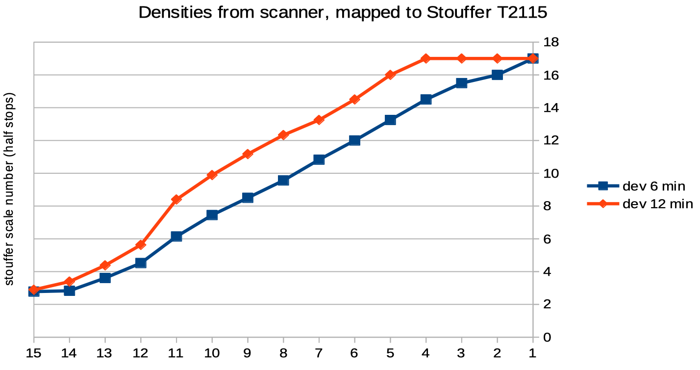

I measured the densities with scanner (two strips + Stouffer wedge on single scan) and mapped the measured densities to Stouffer numbers. The overdeveloped one saturates at top becauase of scanner limits probably (too dense).

Looking at previous image I wonder does HP5 really react to over-development that way after toe? I mean toe isn't that much denser than "box" speed developed one, but then it jumps up (to position 11).
I've read somewhere else that over-development doesn't really affect to toe and doesn't increase contrast in midtones. That is visible from the previous graph.

I don’t think there’s anything wrong with your results. I could wish for more densitometer readings under 0.10
That’s why I suggested a barrier screen (or more thick diffusers) on the low end.
Ah, yes now I understand. I could go in half stops down from 18% of course. That way maybe there would be more resolution and maybe few under 0.1.
That is a great addon, I will change the software in future that way. That bump in low tones feels a bit strange and I was suspecting my device or analysis methods.
Also nice to know that my graphs are probably accurate.
