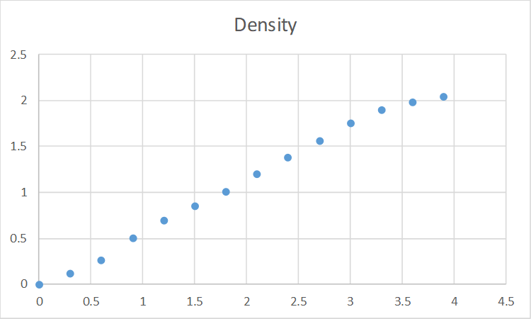

Bill, could this be a good graph?
The densities are translated from Stouffer (Scanned together with strips and then grayscale mapped to T2115 density).
X-axis is translated by multiplying stops 0.3.
And previous graph data zipped.
I did this quick and in Excel. I used a relative log-H and the density is the supplied density minus film base + fog. This is looking to me like a film curve.

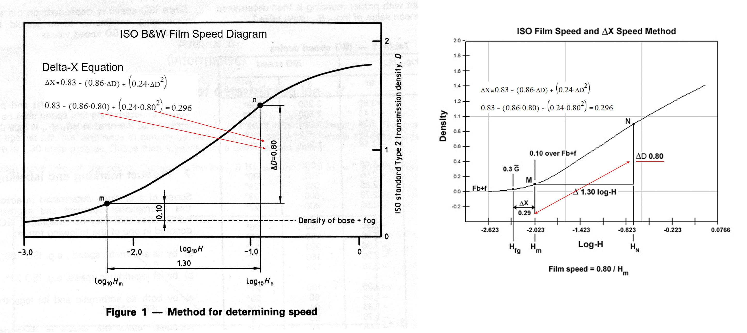

Here is the same ISO diagram with the Delta-X equation included and another showing it applied.
I hope this also emphasizes the importance of producing a film curve that reaches down to at least the film's inertia point with normal processing or one to three stops below the fixed density point of 0.10 over Fb+f.

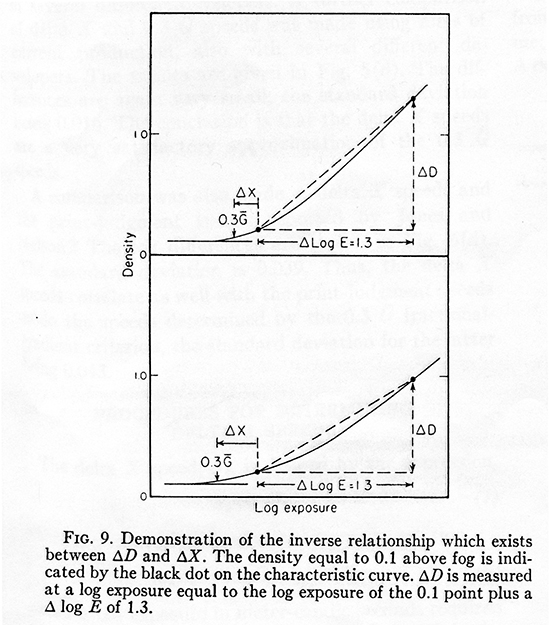

Determining the 0.3X point. Testing involves picking a point, then testing for a very shallow gradient based on an a average gradient of a greater portion of the curve and if it doesn't match the criteria, then checking to the left or right of that spot until it does. Finding the fixed density point of 0.10 over Fb+f requires finding the fixed density point of 0.10 over Fb+f. It's kind of funny how people never seemed to wonder why what they think is the first usable density is found at such a convenient spot. And it's packaged logarithmically too. It was so helpful for the sensitometic gods to have created it in such a way.
In the paper Simple Methods for Approximating the Fractional Gradient Speeds of Photographic Materials, C.N Nelson and J.L. Simonds write, "A frequent criticism of the 0.3 G criterion, however, is that it is more difficult to operate and more subject to random errors than simpler criteria, such as the one based on a density of 0.1 above fog. It is sometimes contended that the increase in ease and precision resulting from the use of the 0.1 density method outweighs the fact that such speeds do not correlate as well with print judgement speeds." The Kodak men of legend would have none of this. They would not succumb to compromise and mediocracy. Thus was born the Delta-X Criterion. Well, also the W Speed Criterion, but that never went anywhere and it gets in the way of a good narrative.
There are a few interesting facts concerning the Delta-X Criterion. It's actually slightly more accurate than the fractional gradient method.

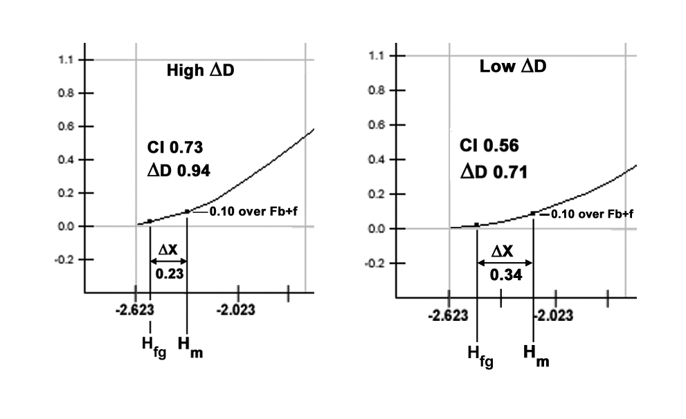

Also, since film speed from the fractional gradient method and the Delta-X Criterion is determined based on gradient and not density, it doesn't change as easily with development as with the fixed density method. This becomes obvious when comparing the two points on films developed to different average gradients.

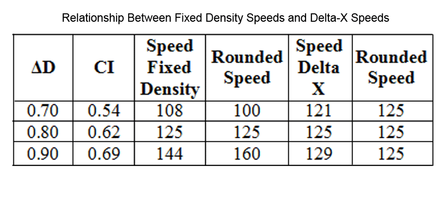

The second example with a ΔD of 0.80 is the value used in the ISO standard. Remember gradient is the determinant of quality and consequently film speed and not density. The films developed to a higher gradient will produce a negative with overall higher density than at normal development, but the extra density is just printed through. There is no correlation between specific film densities and print densities.

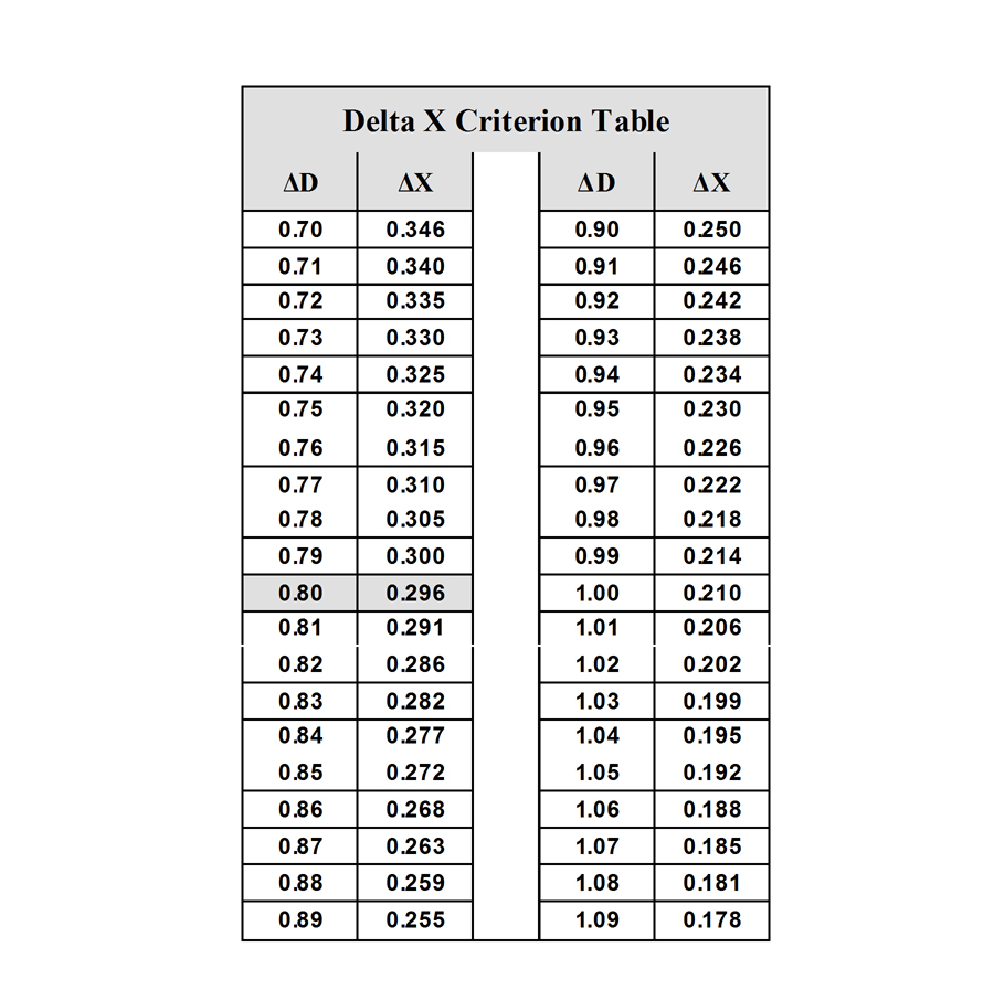

Since the value of ΔX is based on ΔD, a table can be created instead of having to do the calculations with each test.

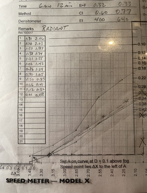

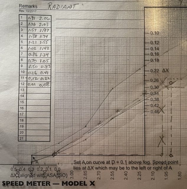

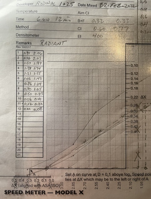

Here’s a Delta-X meter aligned on radiant’s 12 minutes curve. EI that I had noted as 640 based on where 0,1 point falls - by Delta-X indicates closer to 500. For you see the curve meets the right hand side of the scale at 0,19 that instructs you to look at the bottom scale 0,19 which is to the right of the original 0,10 point by about 0,10 (I shifted the scale 0,29 from traditional meter because I want to reveal the film speed lookup instead of the 0,3 gradient) The actual 0,3 gradient falls 0,29 to the left.
You think developing 400 film 12 minutes instead of 6 minutes would give you an effective speed of 640, but in terms of maintaining print quality, you have achieved closer to 500
Not to discount the fact that people will develop HP5+ for 12 minutes and shoot it in their cameras set at 1600 and say it works for them.
But for quality prints, 500 is a better speed to choose with 12 minute development (Rodinal 1+25).

Here’s a Delta-X meter aligned on radiant’s 12 minutes curve. EI that I had noted as 640 based on where 0,1 point falls - by Delta-X indicates closer to 500. For you see the curve meets the right hand side of the scale at 0,20 that instructs you to look at the bottom scale 0,20 which is to the right of the original 0,10 point by about 0,10
Sorry Bill, I can never make heads or tails out of your graphs, but that speed seems a bit high.
Quick question. Are you including a different constant when calculating the Delta-X speed or just 0.8 / Hm?
I am using 0.8 / Hm
It could be the unusual curve shape. Although Delta-X speed doesn’t move as dramatically as chasing 0.10 it still moves somewhat. You gain a real speed increase when you develop longer.
In this case it amounts to a third stop. Not that big a speed gain, but I think it’s real.
Here’s how the “real” Delta X meter looks at that 12 minute curve.
In this case the meter reveals the Delta-X speed point, the 0.3x average gradient… right at the edge of my graph paper and corresponding to about -3.1 log mcs… still talking 500 shooting speed vs 400 with 6 minutes development

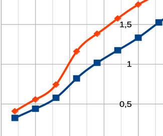

@bernard_L They both look good but the vertical scale on radiant’s graph is distorted making the curves appear to indicate higher contrast
I don't see how the vertical scale is distorted. Looks linear to me.
On second looks, I understand that Stephen Benskin's curve (post #110) is a re-draw of radian's data (post #106) for 6 minutes devt; with different offsets on both scales; plus, dots alone without connecting lines masks the implausible hump at 4th point from left, which is most prominent on the 12min curve (orange dots) not re-drawn by Stephen Benskin. I'm still definitely not buying the "12min" curve.

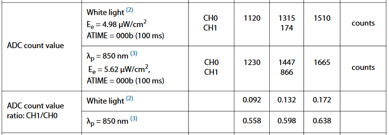

I too keep harping. I had the same question in words, but meaning not "how can you go as low as 0.2 lux" but rather: how accurate is your reference illumination of 0.2 lux?
The datasheet for the sensor https://ams.com/documents/20143/36005/TSL2591_DS000338_6-00.pdf mentions the word "lux" only in the introduction:
This digital output can be input to a microprocessor where illuminance (ambient light level) in lux is derived using an empirical formula to approximate the human eye response.
The responsivities (ADC units per µW/cm2) shown in Fig.8 of the datasheet have allowed changes min-max +/-15%. Plus conversion from µW/cm2 to lux is not entirely trivial. Since this thread discusses fine points of sensitometry at the level of 1/3 stop (26%) or less, the measurement should be accurate to 10% or better, total error budget, not just calibration of zero point of illumination. In that respect, I believe that a good exposure meter might actually not be that bad; Gossen used to include with some of its meters a calibration constant in lux.
