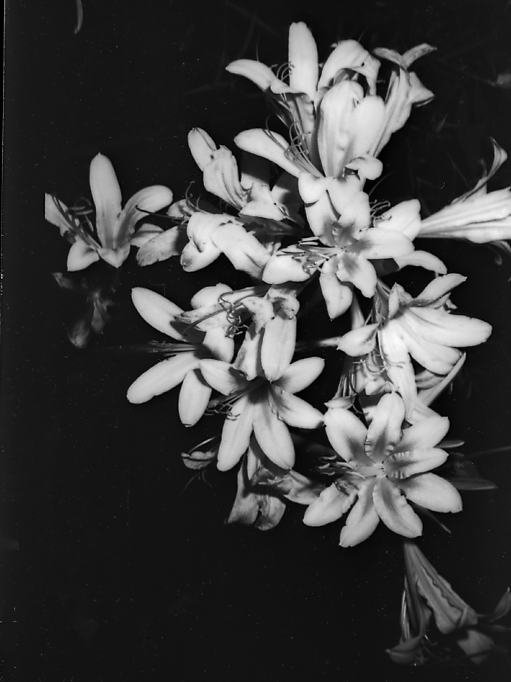

Something's not working right, and the horizontal film scratches are the least of it:

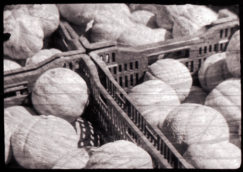

Mamiya 16 Super II, Lomography Potsdam 100 developed in Cinestill DF96 monobath. Every single bit is new to me including loading 16 mm film onto a stainless steel reel, the process of slitting film, the emulsion, the developer, and of course the camera.
Great composition... 'Fruit Ninja' vibes. I've seen scratching that prominent on 16mm cine camera film from the transport mechanism. I would suspect the slitting caused the scratching unless the cassettes are especially raggedy.

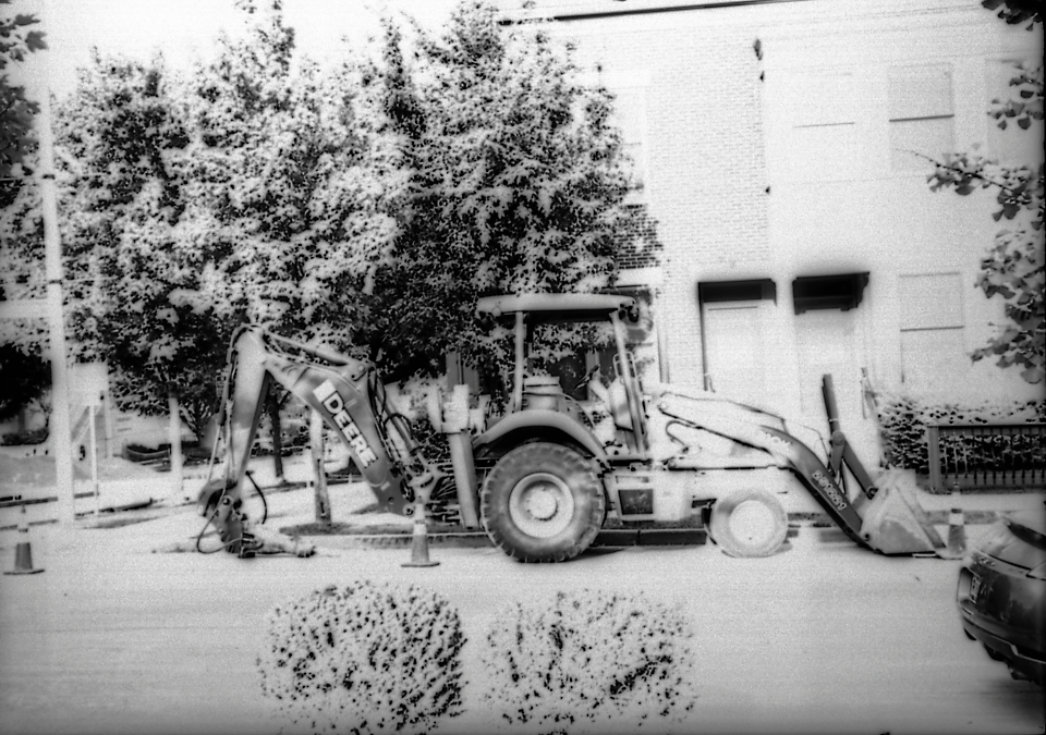

FPP Sonic 25, 12x17mm

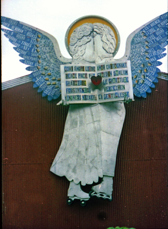

Minolta 16ii, Vision3 50D

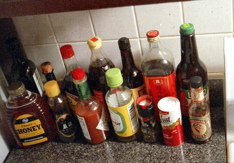

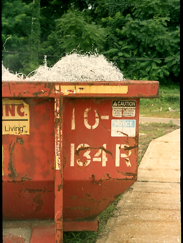

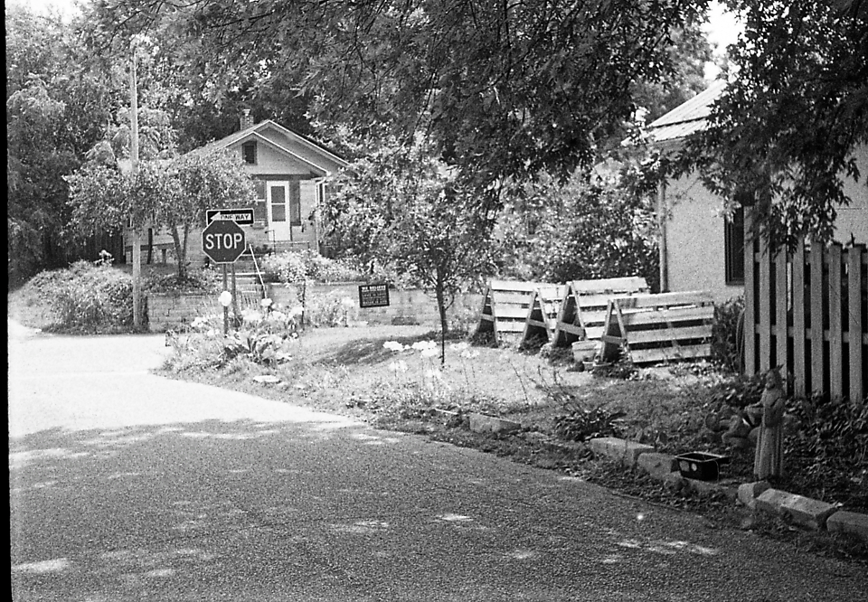

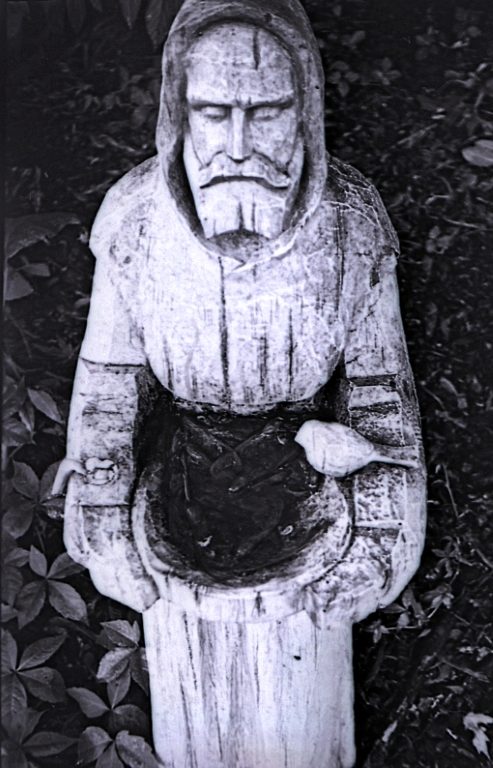

From cassettes of FPP sonic 25 & Double-X in the QT. Vision3 negs are drying.
FPP Sonic 25; Xtol stock 6' 22C
Double-X; Xtol stock 6' 22C

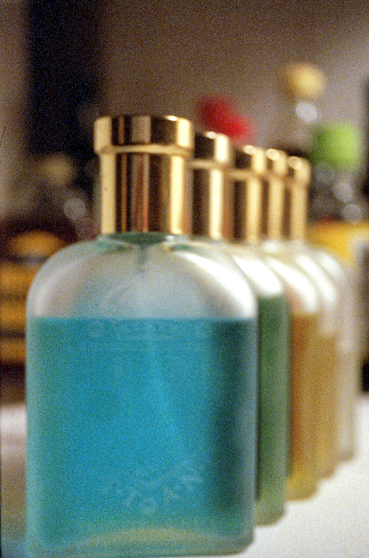

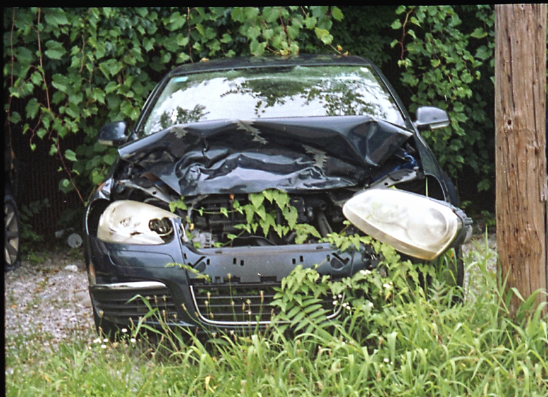

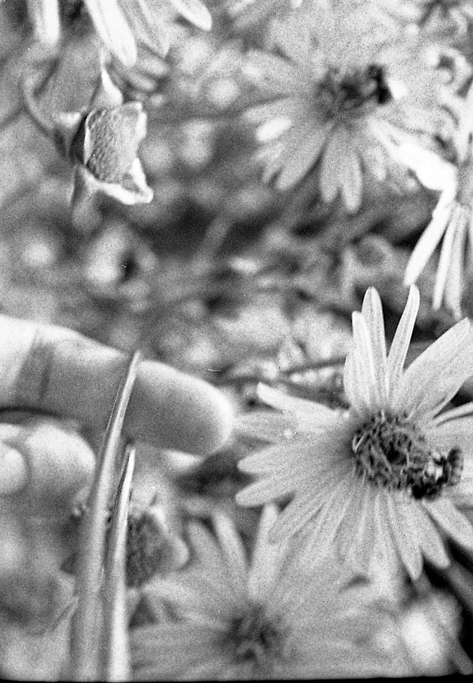

16ii, Vision3 50D, #2 close-up filter
Decent enough for being taken at arm's length on a windy day

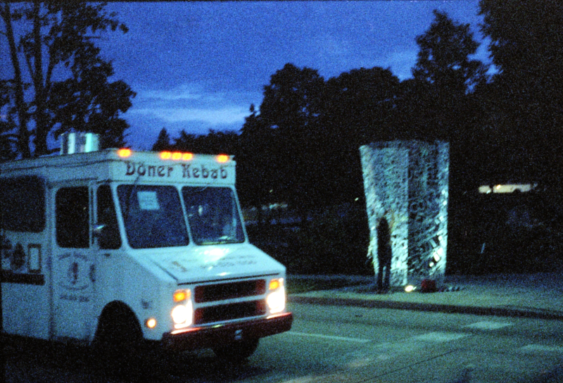

16ii, Vision3 500T

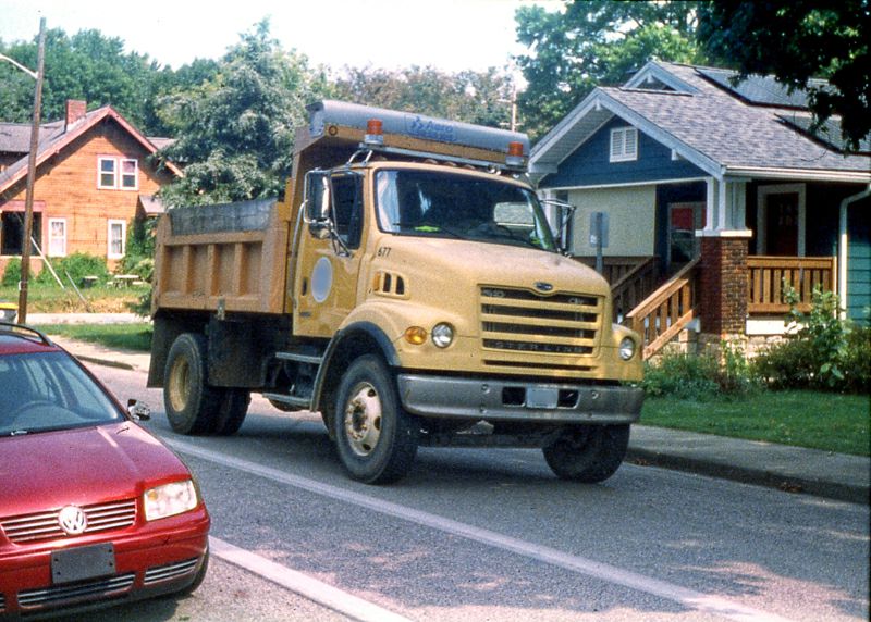

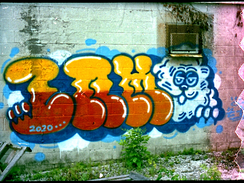

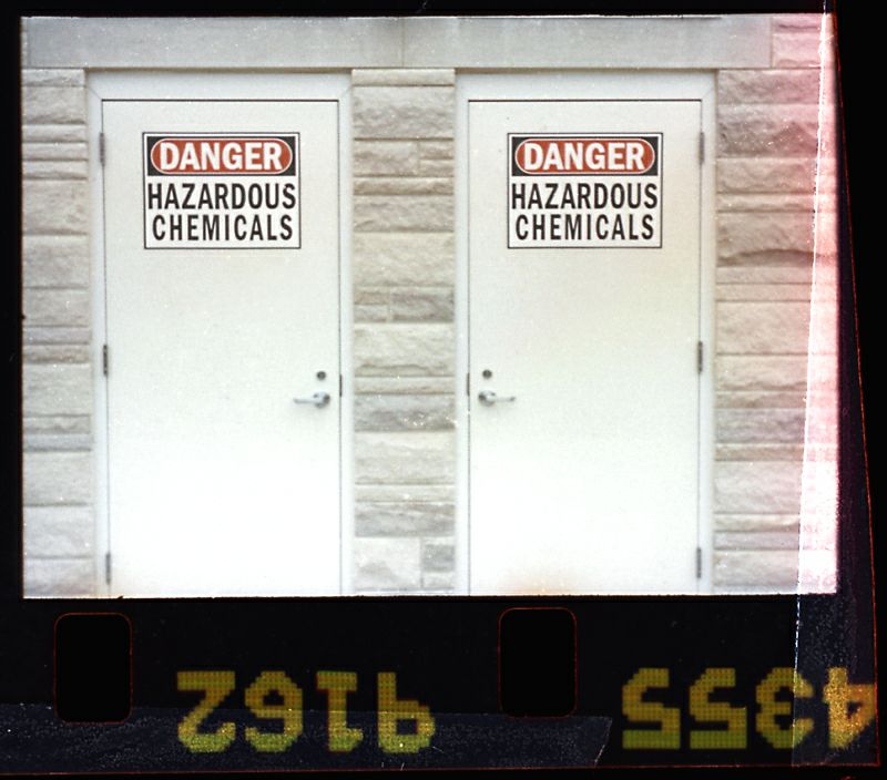

Finished processing 4 16mm cassettes of Ektachrome 100 from various cameras (and a roll of 35mm half-frame Provia 100F but nevermind) with some interesting results.
First was a load in the Minolta 16ii w/ #0 attachment. I used an old 1st developer (2+ months on the shelf) and a fresh 500mL batch of color developer. The 1st developer seems to hold up fairly well.
Next was a roll from a QT with the 25cm close-up lens. Not wanting to leave anything to chance, I adulterated the 1st developer with about 50mL of D-19... which resulted in uneven development and a color shift.
The next morning I whipped up a new batch of 1st developer and processed a roll from the MG-s that I had inadvertently fogged by not taping the cap of the receiving chamber, causing it to pop off when removing the cassette from the camera. The result was a comedy of errors with 2 separate light leaks (cassette & edge fog) and missed framing due to a lack of viewfinder when shooting so close.
Last and least of all the final cassette developed with a very strong red cast that was mostly auto-corrected by scanning. This stock seems to have a built-in mechanism to warn you when you chemistry goes out of spec; it was developed less than 30 minutes after the prior load.
Edit -- Here's a direct positive scan from the last load if anyone wants to try it in their color tool of choice:
Oh and the fifth cassette (a 3D printed one) had the tape fail to adhere to the take-up chamber spindle so the exposure was only mimed.

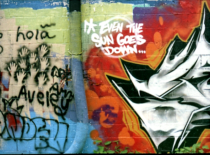

Here's an analog look at that red-shifted ektachrome. The same strip of film illuminated over white light on the left and cyan light (via cellphone lcd) on the right.
Film scanning enthusiasts might avail themselves of an adjustable light source.
