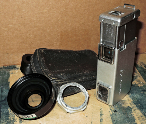

I shot around this weekend with a motley 16ii kit and 500T@320 corrected with an 81b filter for f/16 1/500s in full sun. Following in the 16s' style of accessory lenses I also pocketed a .66 wide angle converter, a #3 close-up (puts focus at ~25cm), with stock #0, #1, and #2 in the pouch. The combination allows for indoor and outdoor shooting using available light.
