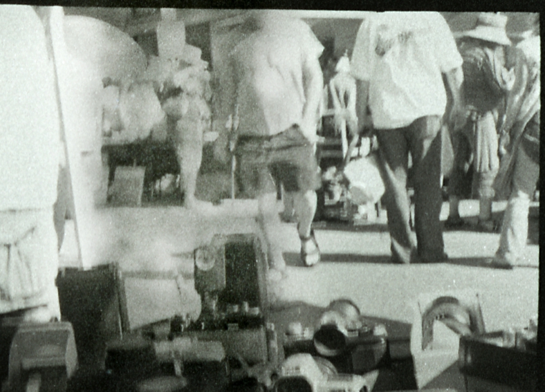

Snagged a 16ii for $20 also containing a cassette of unprocessed plus-x 100. Looks to have been exposed some time in the mid-70's.
Minolta 16ii, Plus-X (found film)
Xtol 1+1 8', anti-fog
View attachment 280271 View attachment 280272 View attachment 280273

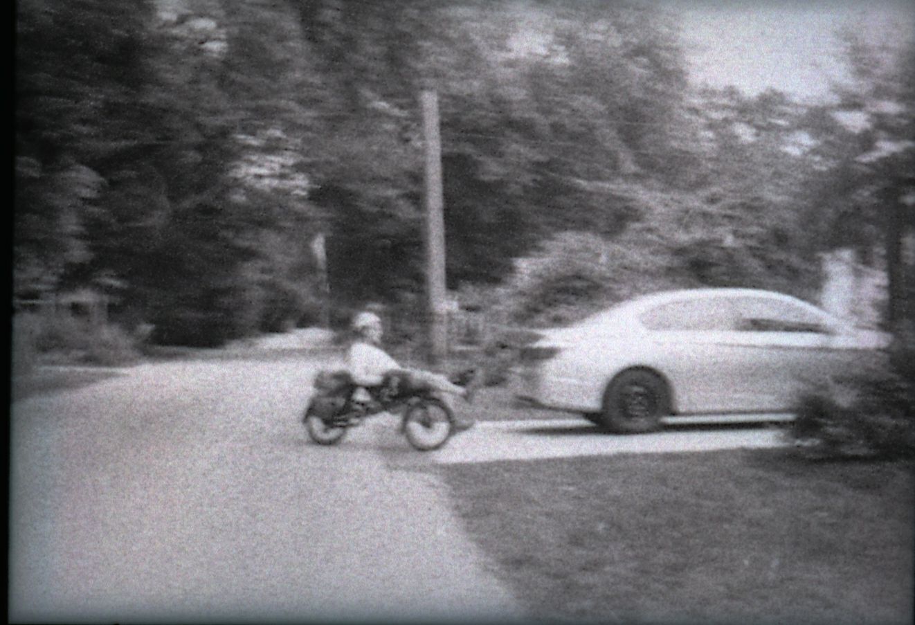

A drag race, fuel filters, and a gggghost?!
What do you use for anti-fog? And how can I go about learning this wizardry.
Auto 110, Tri-X
Anti-fog was 2 drops of an aqueous 1% benzotriazol sol'n in 280mL of 1+1 Xtol in this case. The few frames that did turn out look quite good on the film. Lots of seemingly empty frames probably owing to the 16's advance mechanism and/or underexposure.
The camera may have already been loaded when purchased, judging from the above frame.

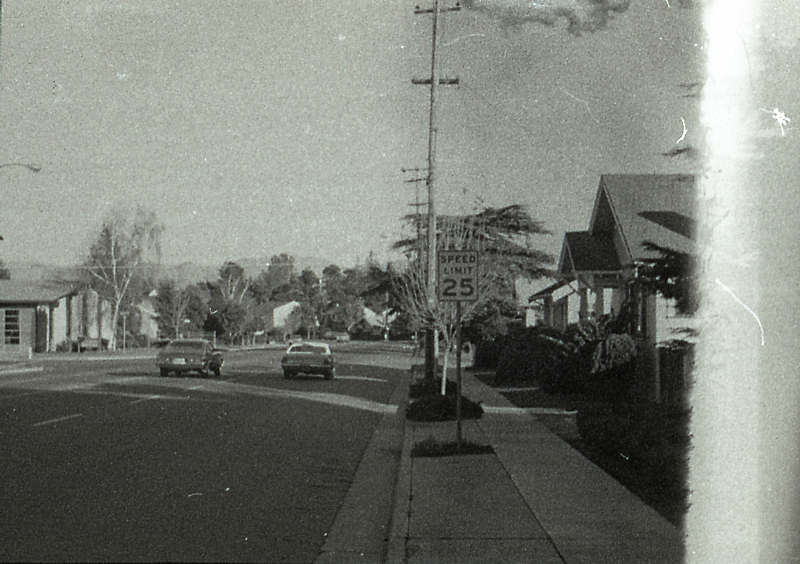

Kiev 30, Tri-X
It's cool how that looks like old newsreel footage!
Or a spy camera shot. Sharp, and resolution limited by the film grain rather than the lens. Sometimes even spies needed higher film speed (you don't believe they shot documents under a desk lamp on APX 25, do you?).

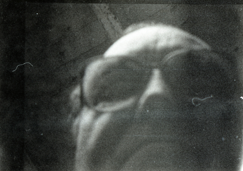

Something's not working right, and the horizontal film scratches are the least of it:
Mamiya 16 Super II, Lomography Potsdam 100 developed in Cinestill DF96 monobath. Every single bit is new to me including loading 16 mm film onto a stainless steel reel, the process of slitting film, the emulsion, the developer, and of course the camera.
It's generally recommended to limit the number of new things you try to deal with at any given time...
You clearly got development/fixing, so the monobath is working. Contrast may be a little high, but that's something you have to work out with Df96. Looks like you have a small obstruction in the frame gate. Is that a 3D printed cassette? That might account for the scratches...
