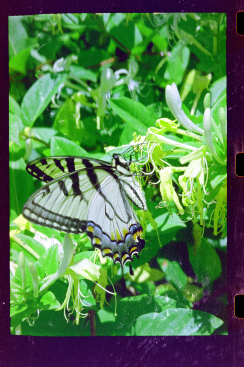

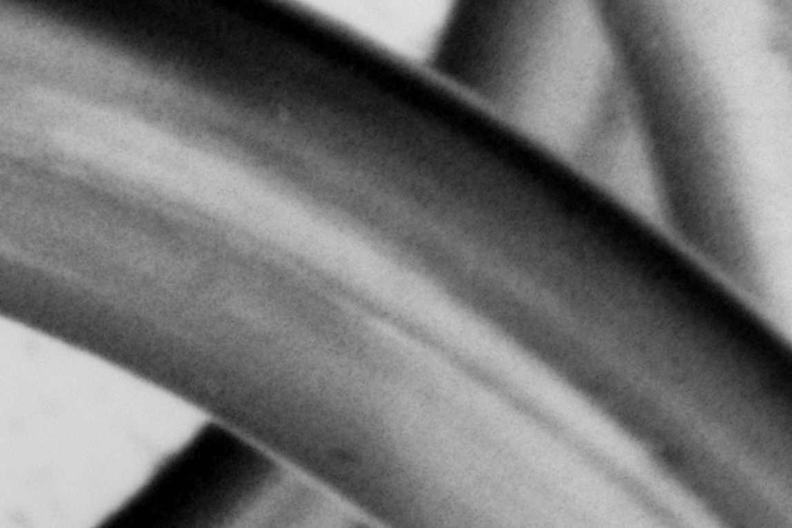

Inspired by JB's new macro lens, I did a quick d850 digitization of a Sonic 25 negative. Reversed 24mm af-d on bellows, so the capture is actually a crop of the original 12x17 neg... no fancy borders unfortunately.
The grain on this particular stock is practically non-existent; I'm not sure if the 100% crop shows grain or sensor noise
A bit of color, to boot. Very different colors than the scanner.
Edit: A full frame capture with a more typical 80mm el-nikkor / bellows set up. ECN-2 really seems to confound the d850.. what happened to the red channel?

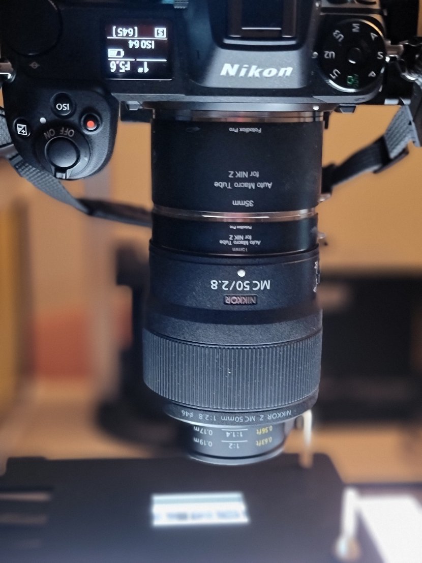

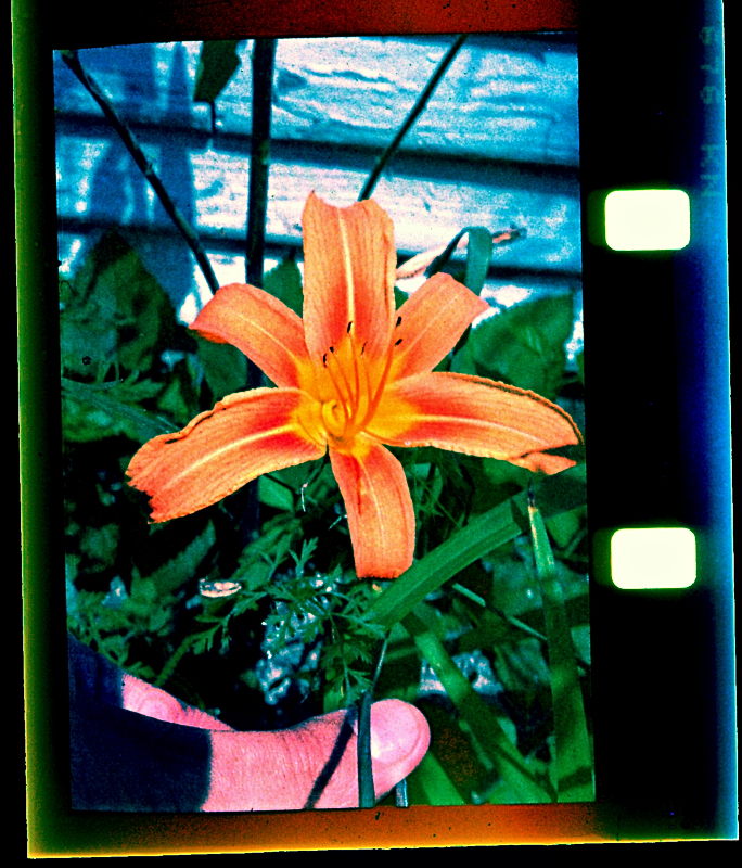

I just received a new 50mm macro lens for my Nikon Z7 so I thought I would see how it works for digitizing a Minox frame.
This was shot on Acros film and developed in Xtol developer. I needed to use some extension tubes in addition to the macro lens. ---jb.

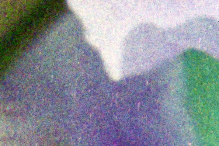

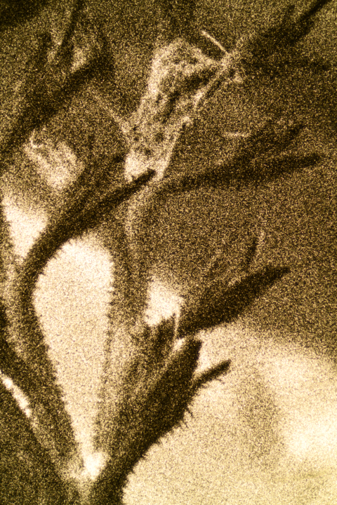

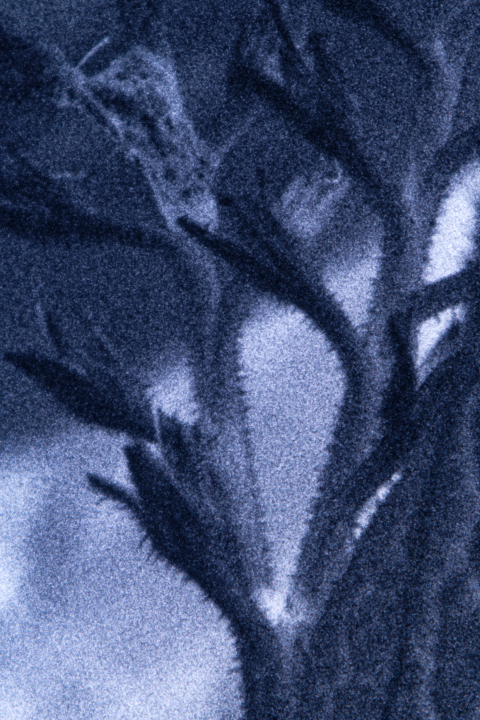

Now for some grainy content, these are 35mm captures of approximately the same 3x2mm portion of a 17x12mm Double-X negative.
A '100%' crop at this enlargement loses pretty much all visual cohesion.

Yes, I got the new 50mm Z mount macro. I am using 2 auto extension tubes, so the f-stop and auto focus still work. The new lens is a keeper - good size and quite sharp edge to edge. --jb.

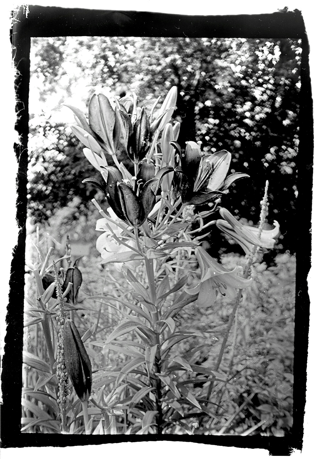

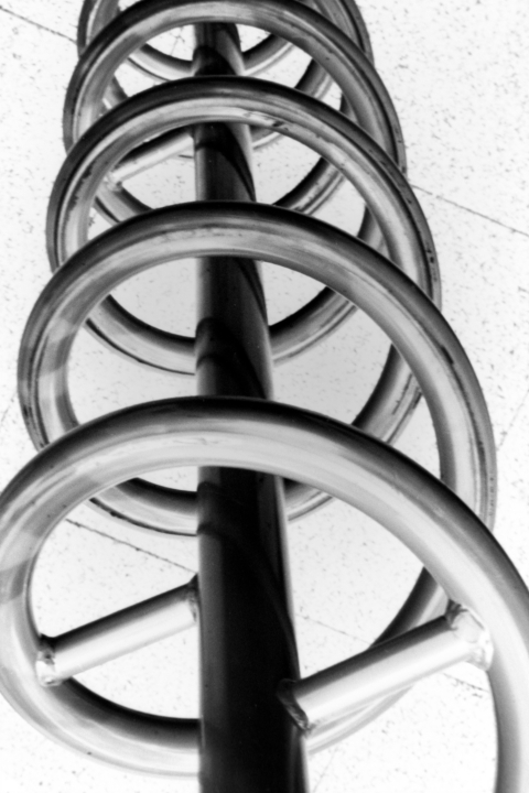

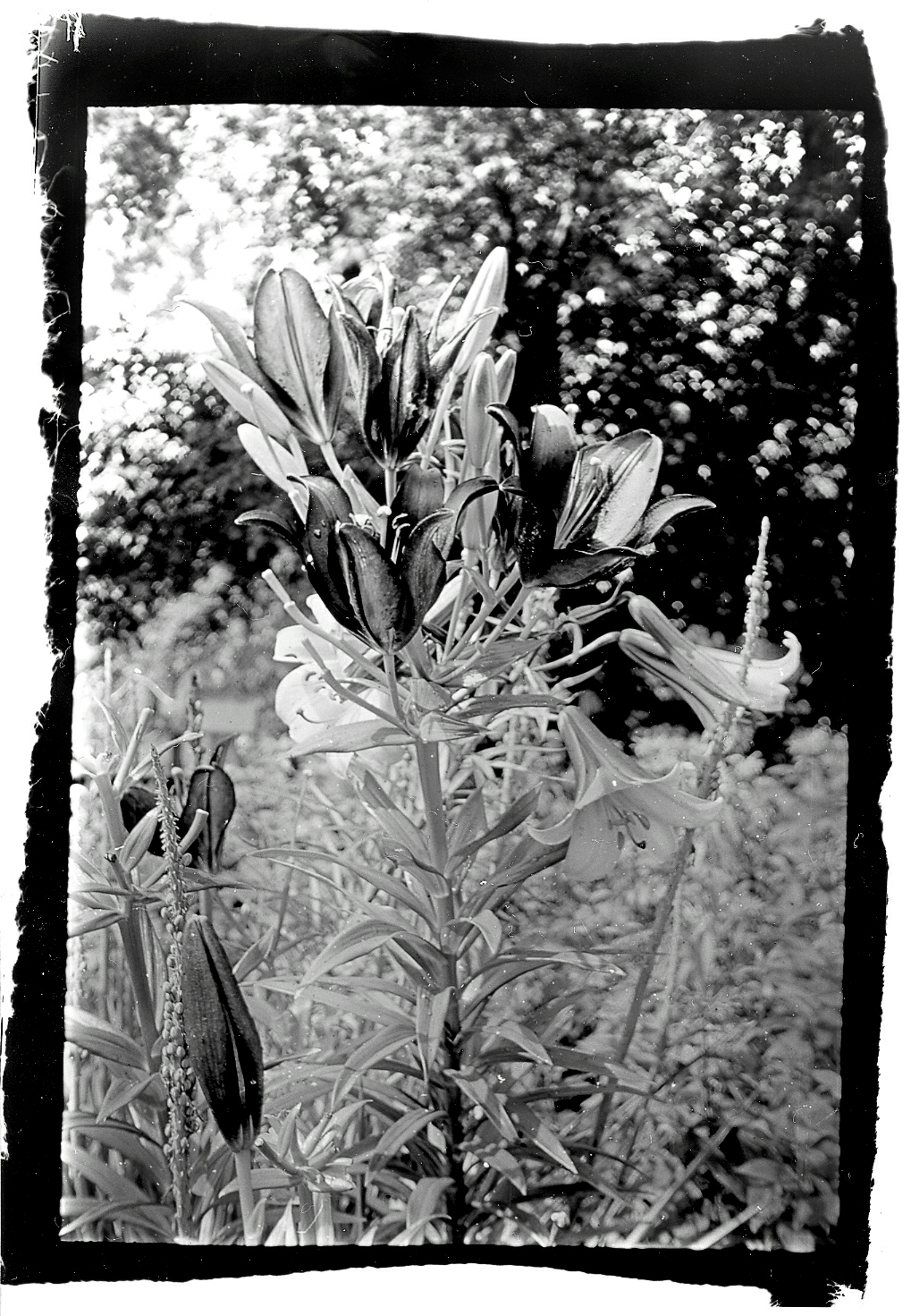

Scanned print on Ilford MG RC 5x3.5"; 16mm Sonic 25 in POTA, Rokkor 30mm
Test strips makes great bookmarks fwiw

Yes, I got the new 50mm Z mount macro. I am using 2 auto extension tubes, so the f-stop and auto focus still work. The new lens is a keeper - good size and quite sharp edge to edge. --jb.View attachment 279063
Whoa! I had no idea that you can get extension tubes for the Z lens that still allows AF and F stops.. Thanks for the info!!
Could you tell me the exact model/make of the tubes you are using? I can see it says Fotodiox.

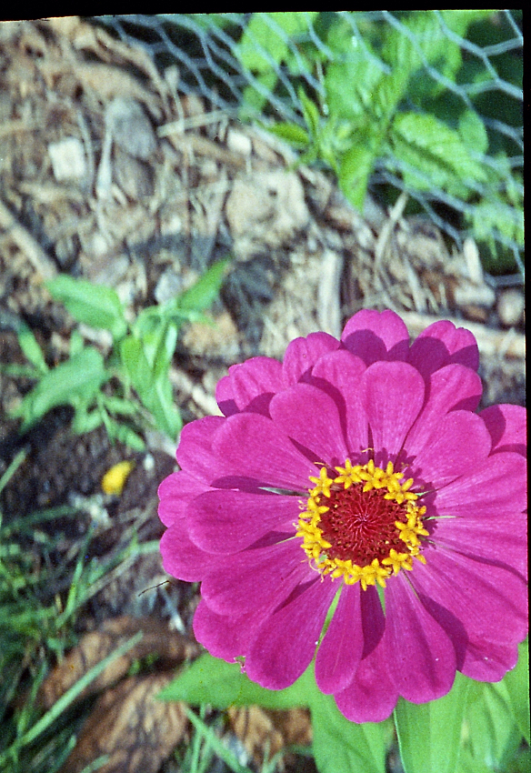

Last night I decided I wanted to get closer than my 60 2.8G allowed for my 110 'scans'. The 60 is perfect for 35mm film and larger, but I need to crop the image for 110.
I remembered (!) that I had a 55 2.8 MicroNikkor, and used the PK13 and PK12 extension tubes.
With the 60mm lens the largest capture (cropping out the non-image stuff) I could get from 110 using my Z7 is 4100x2800. With the 55mm + extension tubes it is 5300x3700 which is a significant jump so that's going to be my 110 set up.

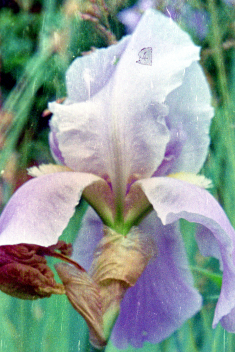

Rollei A110, Fuji Superia 200
From the picture of the tubes it looks like the brand is Fotodiox Pro. I think they have their own website.

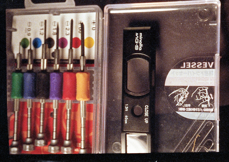

MG-s 1/500s shutter priority, 25cm focus

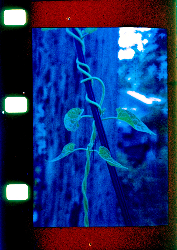

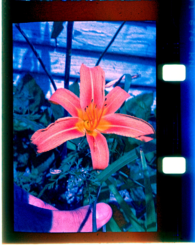

Vision3 500T @ 400, Daylight; ECN-2, copper sulfate bleach
Edit: Same as above, but reversal processed, minus orange mask
The 500T negs came out much closer to daylight balance than expected. I've noticed certain films (2254 comes to mind) tend to balance warmer as they're overexposed... but the quarter-stop here doesn't seem like it would be significant. The negatives were bleached back to AgCl and ran another 1:30 in the developer so perhaps that had a warming effect. Fun to mess around with regardless.
Regular processing, rendering under tungsten is spot on.

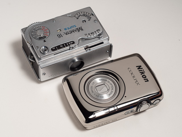

16 mm is proving to be one of my craftsier photo projects: I found a Mamiya 16 Super II at an attractive price because it was sold "For parts / as-is". Fortunately, despite it's diminutive size, it wasn't too hard to service. Mamiya applied grease with a generous hand, but after 60 years, it was in dire need of a freshening up. Shutter speed escapement was bone-dry, focusing helicoid was frozen, and link to the focus control was bent, but the remedies were straightforward.
Slick as hell and a contender for 'Camera Odd-couple 2021'. A threaded cable release and bulb mode are sorely missing from my 16mm minoltas. I'll probably pick up a 16ii at some point just for the bulb mode and maybe get some sort of 3D printed bracket to facilitate a cable release.
