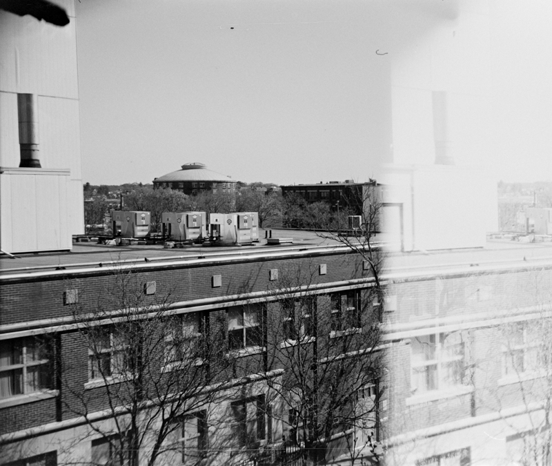

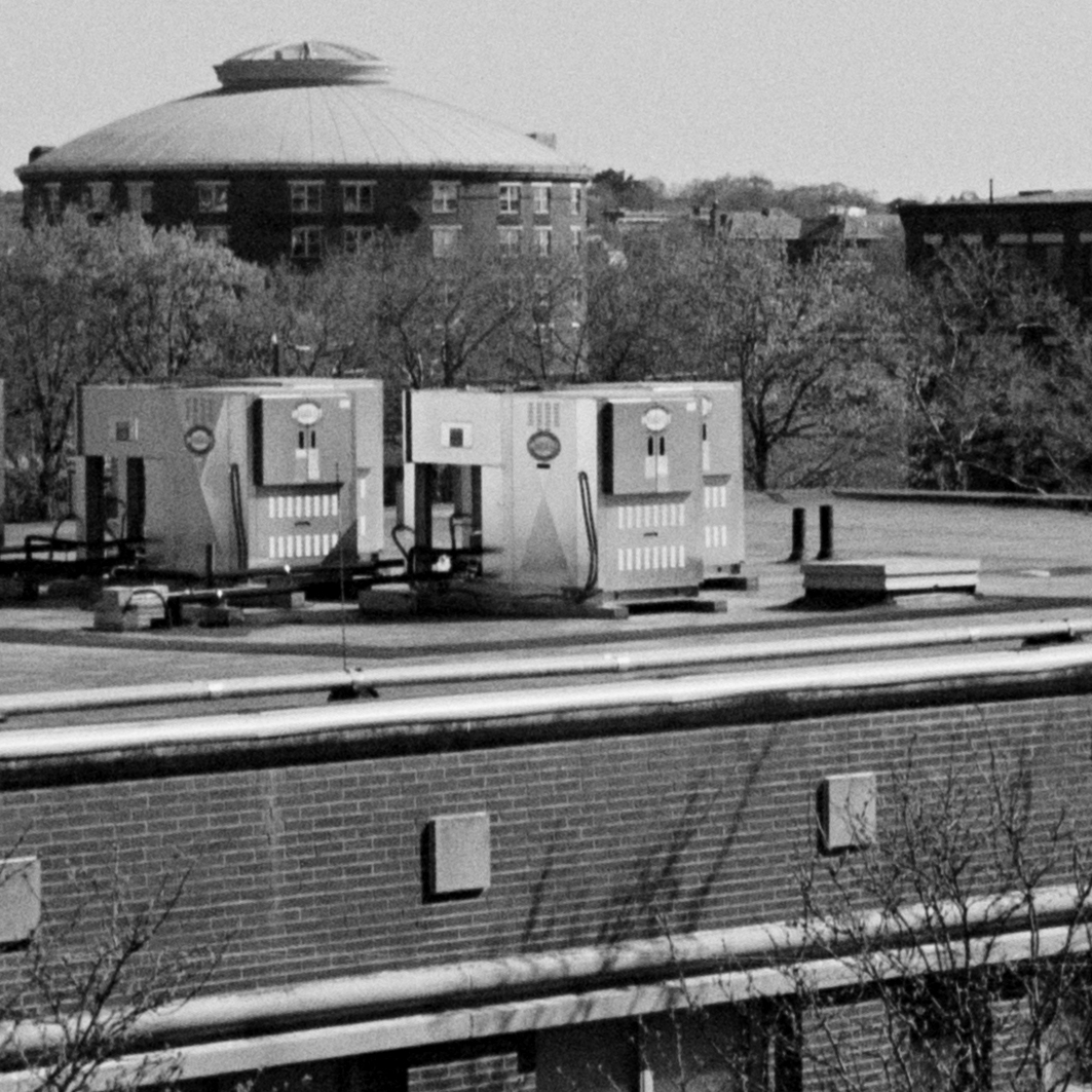

I finally got my hands on an Ektramax, after well over a year of eBay watching. Looks like it's been through a bit but is mechanically functional. I loaded some nonperf 16mm in a cartridge without backing paper and got major overlap, so I suppose I'll have to double-advance to make it work (the little perforation sensor pin was already bent, so I clipped it off). Can't say I see myself being particularly enamored with the camera - it's pretty much as big as two Minox 35s side-by-side! Sort of defeats the purpose. The slightly-manual control is nice, though.
One heavily overlapped frame and a 100% crop. Definitely need to either use the backing paper or put something in to act as a pressure plate.

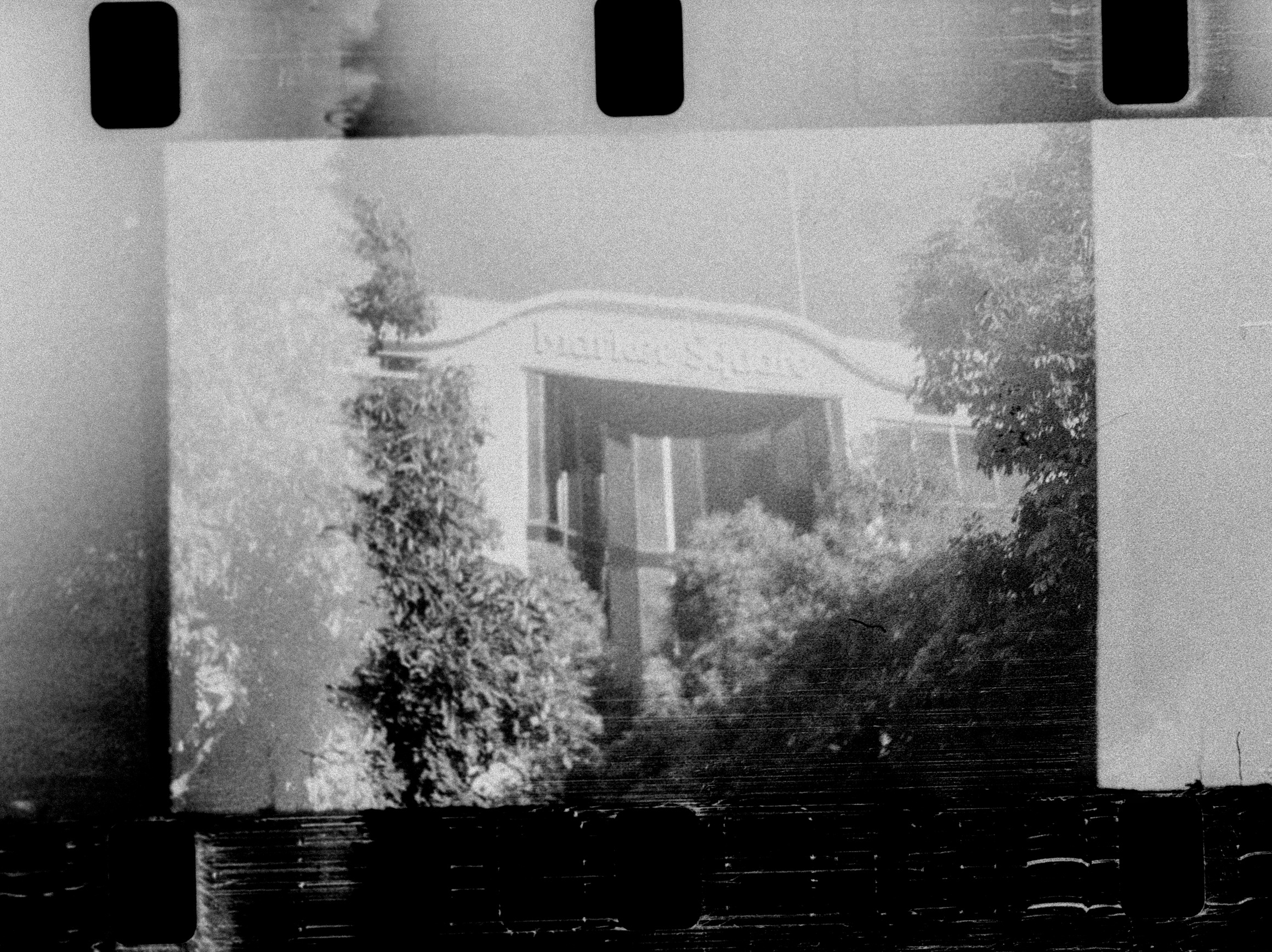

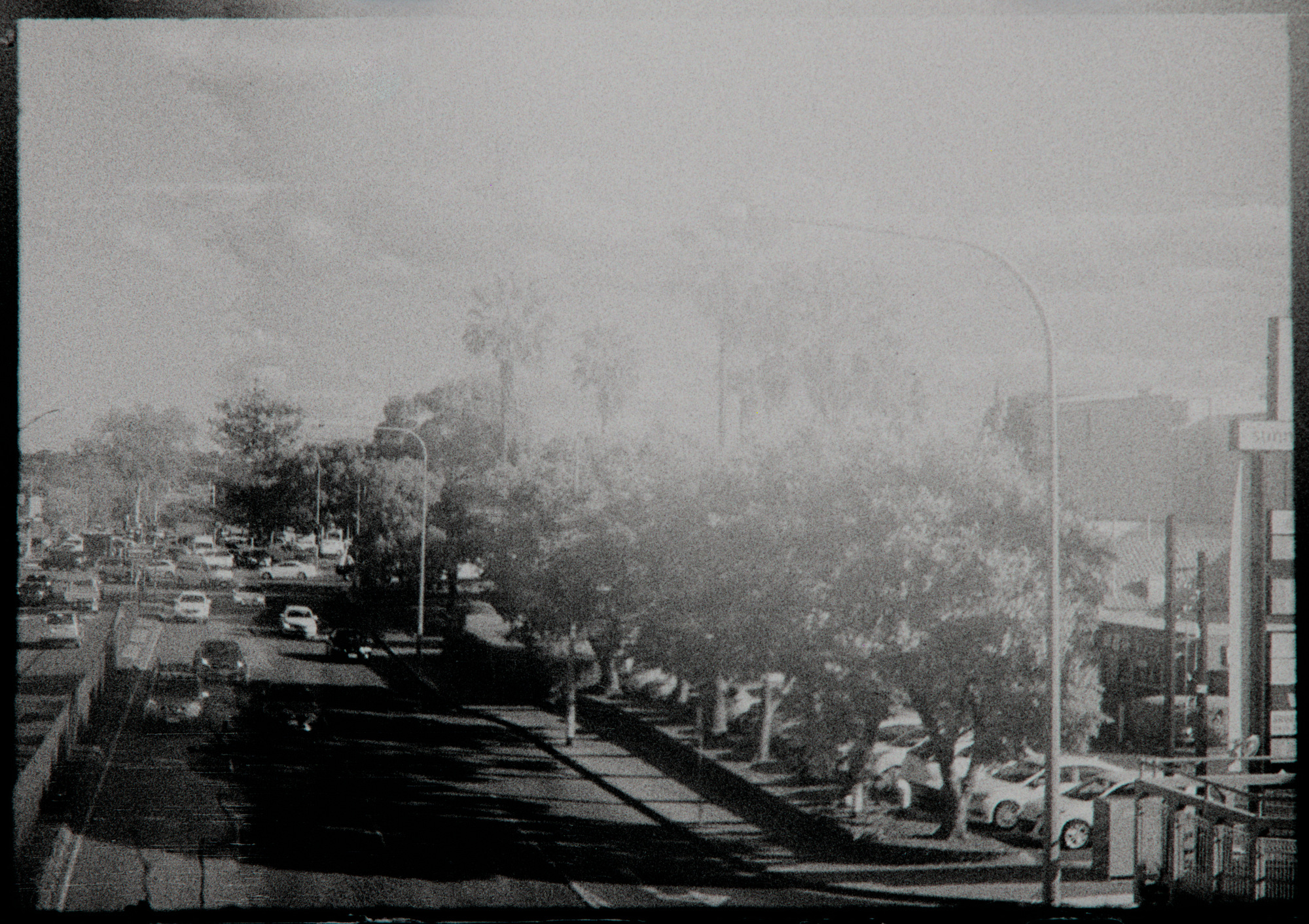

I decided to test it with some FPP Infrared 16mm film I had laying around, see attached, perceptol 1:3 to develop (I scanned handheld with an EM5ii, sorry, its probably not even grain focused!)
Lightleaks galore, the whole thing was fogged, if that was my fault or the films extra sensitivity in the Australian sun, I'm not sure.
I'm going to shoot some R100 when my Jobo reel arrives and see if this lightleak issue happens on less sensitive films

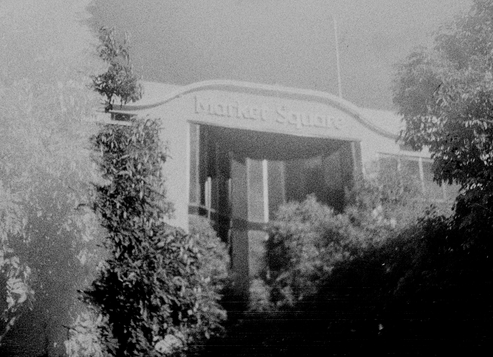

Try two at a "camera scan" with my new copystand setup, and an extra one, not bad for light leaking.
I realize now it kind of looks like lightpiping across the film, maybe that was the problem? But who knows, I need to get out there and take more shots anyway.

Nope, it wasnt light piping, it turns out, Vega's are supposed to have pressure plates.
Mine doesnt, causing sharpness issues, and leaving a big gaping part in the camera that lets light in through the hinges
Has anyone seen that before?

Without that pressure plate I don't know how you can get good pictures. It's spring-loaded and is only applied to the film when the camera is fully opened. I can't imaging how that could be missing. Fortunately, the Vega/Bera 2 can be found in good condition for very little money. And if you decide on a replacement camera, have a look at the Kiev 30 or 30M. Basicallty the same camera, but with a larger 13x17mm image size.

Since it's IR film, that light leak could be happening before or after the film is put in the camera -- or BOTH!!!
