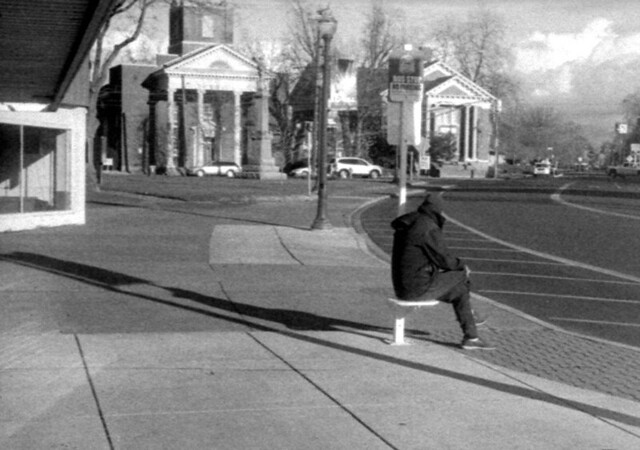

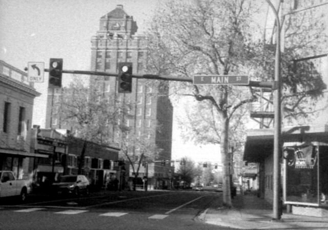

Here's a few from the Minolta with only the UV filter.
Kinda grainy I thought.
