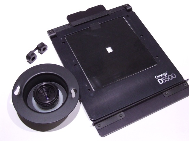

Is anyone here using a 25mm enlarging lens for their 110/16mm negatives?
I have this 25mm Rodenstock and a 30mm Rokkor-X CE, but my 45mm Apo-Componon is sharper. But I can't make very big enlargements with the 45mm.

When I find it in my boxes of stuff, I have an Enlahead with a (so-so) 28mm lens.
A 25mm F4 "Voss' lens in a 39mm mount.
No so fancy but gets the job done.
I wonder if Leitz ever made a anti-Newton spacer for 16mm films for the Valloy II, seeing how popular half frame/miniature films were at one time.
Which enlargers are you using this lens with?
That 25mm fits in that recessed board on a D5500 Omega. The Rokkor CE 30mm is designed with an extra long flange focal length, so it can fit enlargers without a recessed board. I found that a glass carrier is a must with these little negatives.

I have a Mamiya enlahead that I don't need anymore if anyone is interested. I made a Minox carrier for it too. I thought the lens was plenty sharp with Minox negs but the times on my Saunders were long. It would be better on smaller enlargers. I wouldn't mind taking the lens out of it but I don't think it is possible with my enlarger.
I found the Minolta CE Rokkor-X 30mm to be pretty good but not as good as their other enlarging lenses. I just cleaned mine, so maybe it will be a little better next time I use it. Not a lot of choice for enlarging small negs though. The nice thing about the Minolta lens like ic-racer mentions above is the lens is very recessed so it can be used on a regular enlarger. I've used it on my Leitz Focomat before to enlarge Minox and it worked well. I also tried mounting a lens from a Yashica Atoron but the result wasn't very good, at least seen though the grain magnifier.
