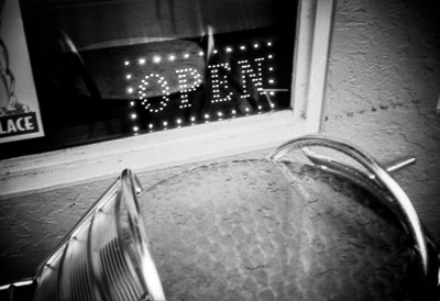

Huss I started shooting with a Minox a couple months before the pandemic started, just for fun. Like you said, amazing that I shot a lot more with it than any other camera I carried with me because it was so easy, and the mojo started flowing. Turned into the "serious" stuff, whatever that means. Any good picture to me is serious, ya know? Doesn't matter what camera it is. Haven't really touched the Leicas since. I bought the Rollei a couple years ago for kicks but just started using it recently. And it is fun. Microfilm in the Rollei isn't that great but a nice distraction none the less. Something different. I have an Ektramax too and I've also shot some half frame color which is also fun. The little Rollei though, sweet little camera.
I started an Instagram with the pandemic images from the Minox- https://www.instagram.com/patrickrobertjames/
Checked out your IG - love it. Fave pic is the lighting bolt, then the ceiling with bulbs.

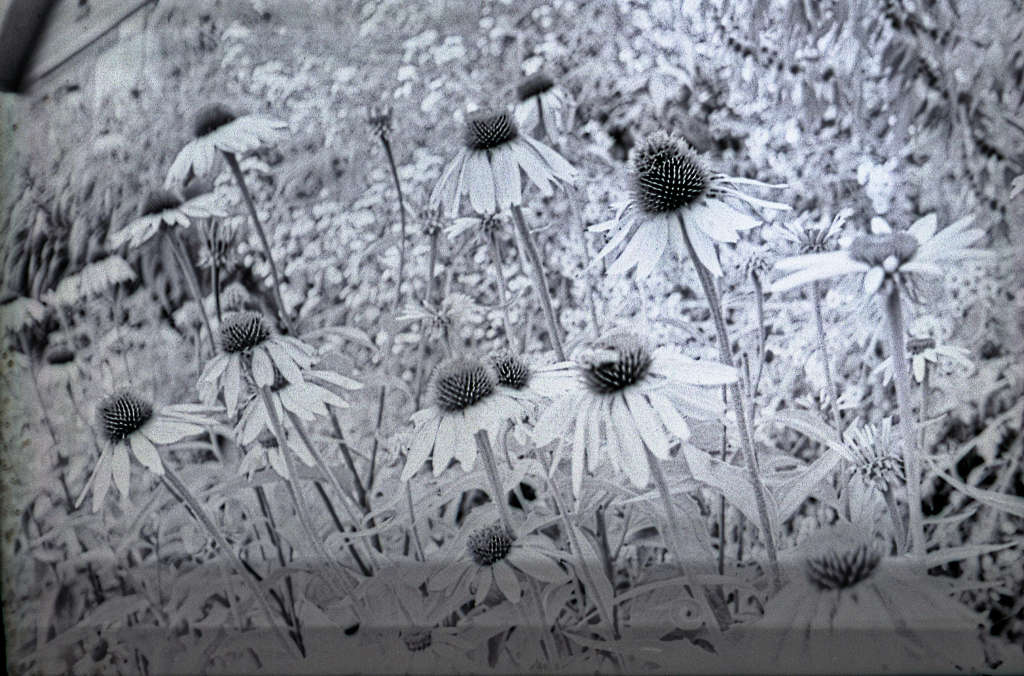

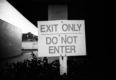

Overexposed and overdeveloped to get some super dense negatives on a load of Sonic 25. So dense, in fact, to produce pronounced scanning defects along the edge. Lends an IR-like quality to the foliage. First time using POTA and it lives up to its low contrast reputation. I'll probably try a similar exposure regime but pull the development a bit next time.

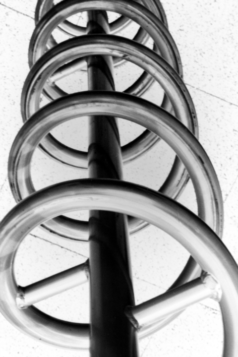

'Original' MG-S 1/500s shutter priority, 40cm diopter
Vision3 50D @ 160; ECN-2, 1.5 stop push
Nailing critical sharpness with the 40cm attachment seems to be much more difficult than with the 25cm or 80cm lenses. 25cm measures well with the wrist chain, 80cm is my reach, and 40cm by my measurements is the length of the auxillary chain plus the length of the MG-s body but all 40cm shots are much softer than any other focus distance. Will need to run some tests for fine-tuning...

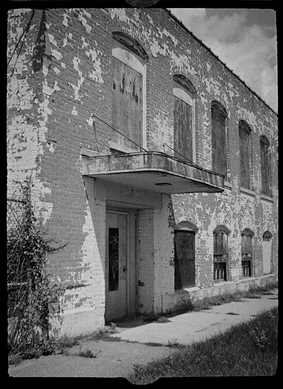

Talking about "serious" photography... yesterday I was out with my Nikon F2AS, CV 40mm f2 and Fuji colour film. Came across a scene which even though I photographed w the Nikon, would be perfect on 110 film - subject matter, lighting and frame shape. So I'm going back! I really should always keep a 110 with me, it takes up no space. But I wanted to use the Nikon and deliberately left the 110 at home so I wouldn't be tempted to use that instead!

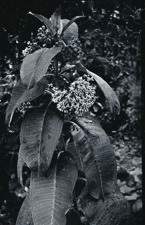

Minolta 16, Plus-X, D-76 1:1 8.5min
Frame is quite a bit smaller than the Auto 110 but with the right film and developer it's acceptable.

I bleached back the blown Sonic 25 POTA negatives and got much better results from scanning. Very interesting film & developer combo. All the frames were shot at 1/30s f2.8 so the contrast and tones vary wildly depending on the light.

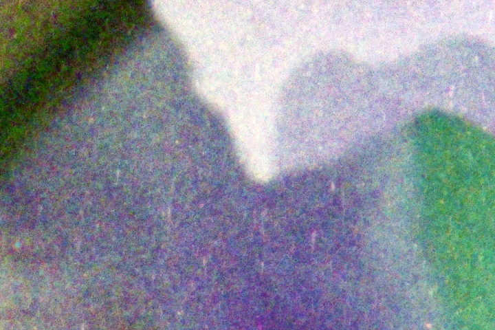

Inspired by JB's new macro lens, I did a quick d850 digitization of a Sonic 25 negative. Reversed 24mm af-d on bellows, so the capture is actually a crop of the original 12x17 neg... no fancy borders unfortunately.
The grain on this particular stock is practically non-existent; I'm not sure if the 100% crop shows grain or sensor noise
A bit of color, to boot. Very different colors than the scanner.
Edit: A full frame capture with a more typical 80mm el-nikkor / bellows set up. ECN-2 really seems to confound the d850.. what happened to the red channel?
