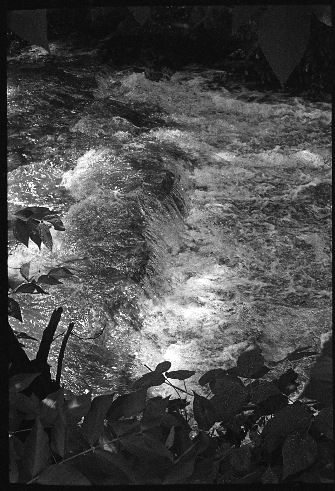

[Double-X in Tmax Dev 1+4]

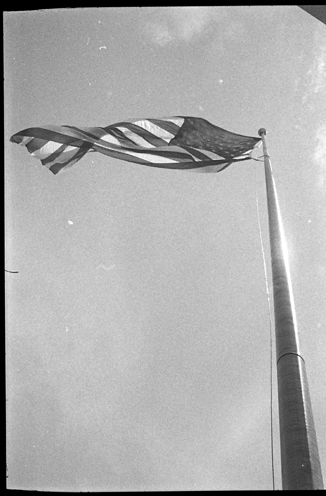

My issue always turns up at the fix. Development goes fine, but for some reason, maybe the water stop blasts the film off the reel? The film has gaps in the fix.

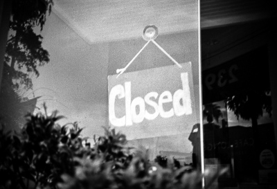

Pentax Auto 110, Tri-x @ 100, D-76 1:1 10.5 min
Some weird artifact on the negative.

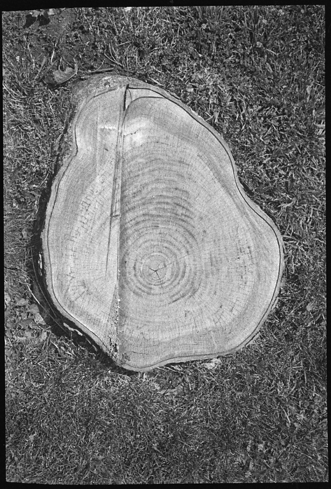

Auto 110, Plus-X D-76 1:1 8min
This roll got jammed up at the end and the last 10 photos were all mushed on top of each other. I suspect the cog is worn out and I swapped it. HC-110 seems to give a better look than D-76 for 16mm. I prefer D-76 for 35 and 120 but it seems the HC110 is winning here.

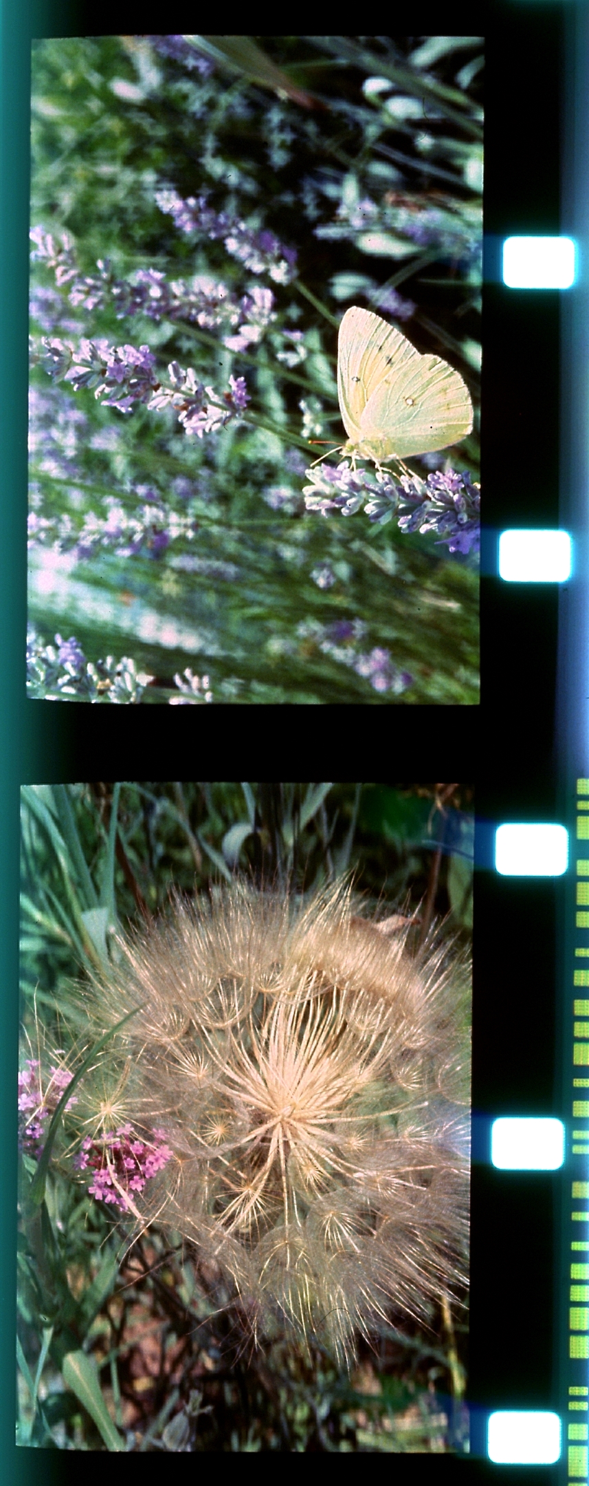

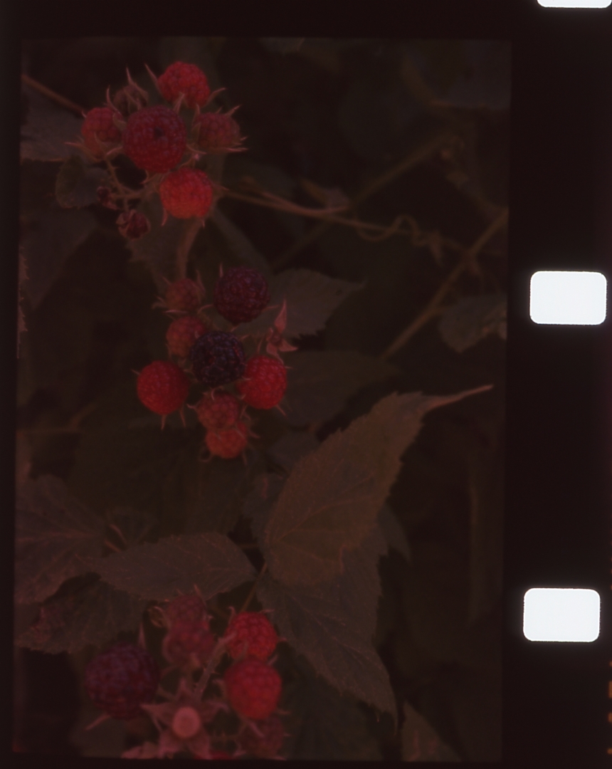

Processed a cassette of E100 in the 1st & 2nd dev chemicals I used on the initial roll; mixed 7 days ago.
There is a very heavy color shift towards red, which I've seen with this stock when using stale developers.
Very much recoverable in post, however.
Edit:
No pun intended.
Thin edges indicating not enough re-exposure from some parts of the reel it seems.
Edit:
No pun intended.

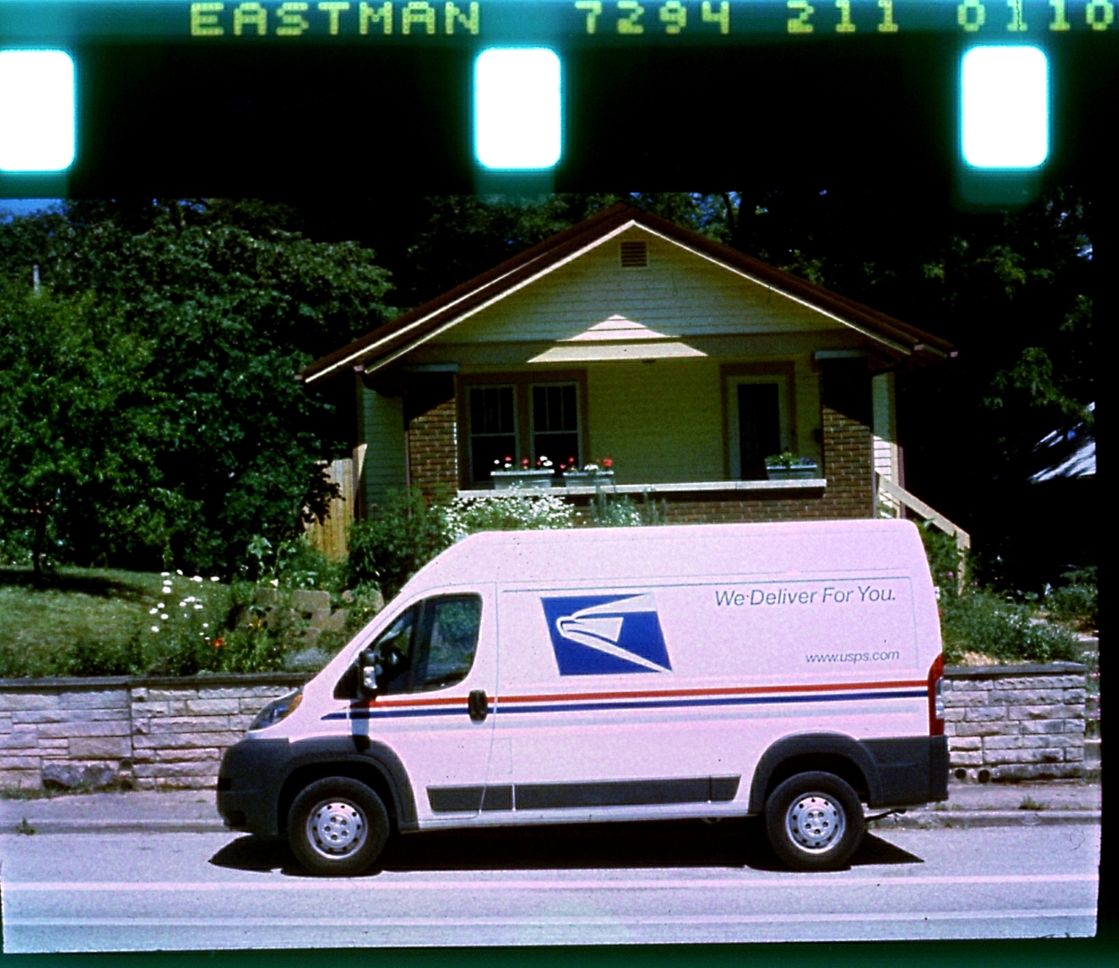

I see another mail truck aficionado.
There's a dood bouncing around in my neighbourhood in one of those old Jeep mailtrucks. 2wd, top speed I think is only 45..
Looks really cool in that worn out beat up way.

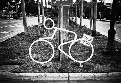

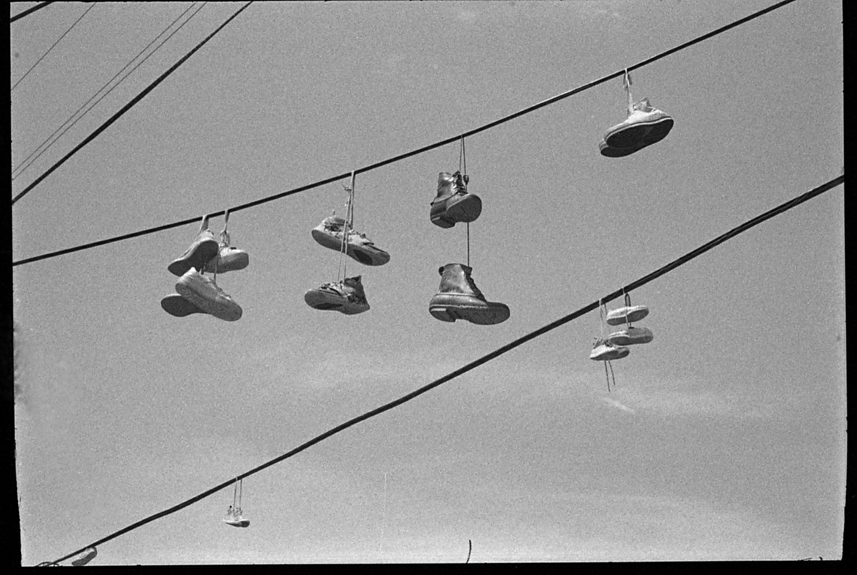

MG-S, shutter priority auto
Double-X in HC-110 1+47 8'
Definitely a bit of gunge stuck in the film gate (bottom of 'shoe' frame). Time to invest in some post-it notes.
