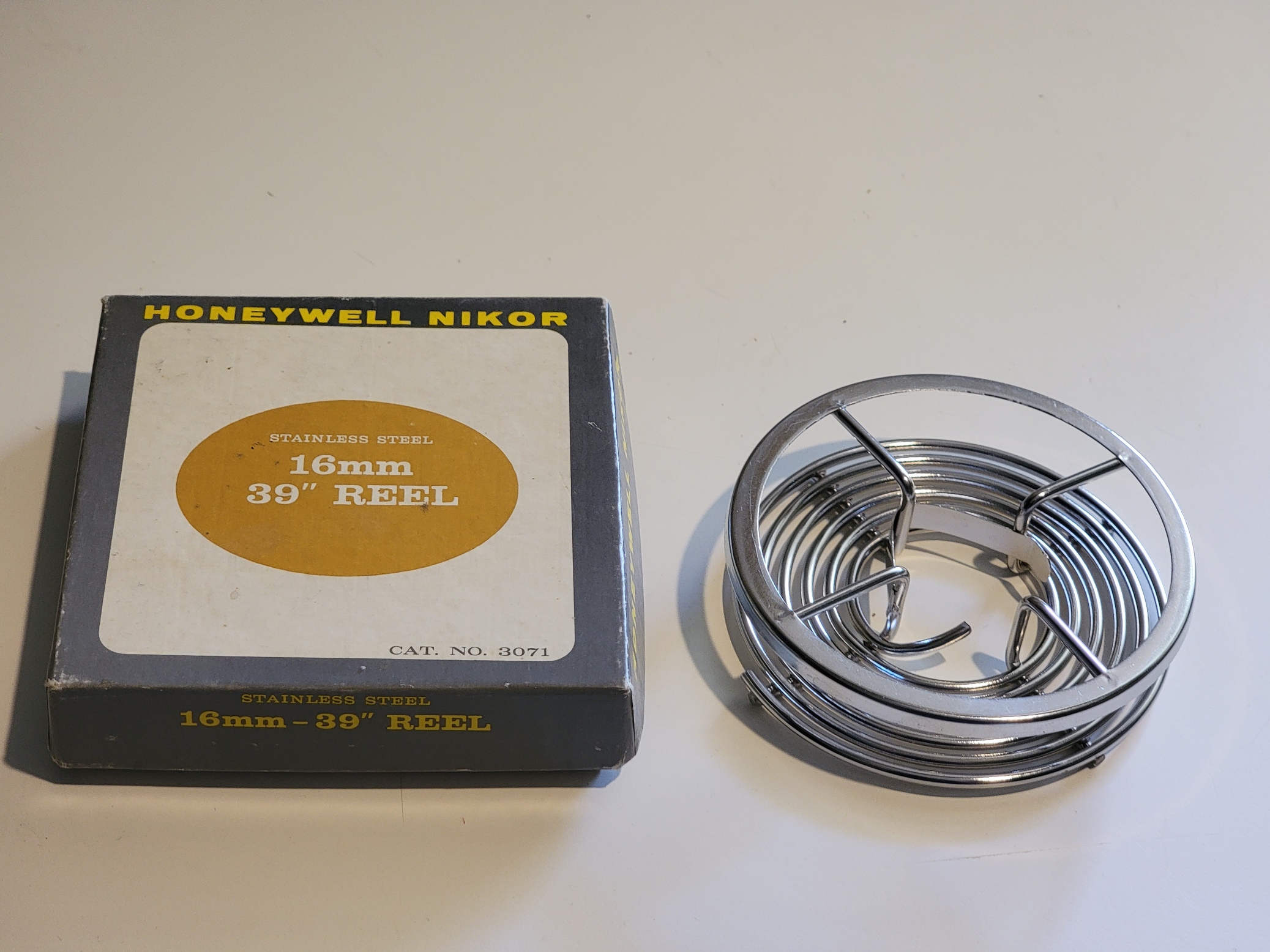

Stainless steel reels. for 16mm are easy to load and work great. --jb
