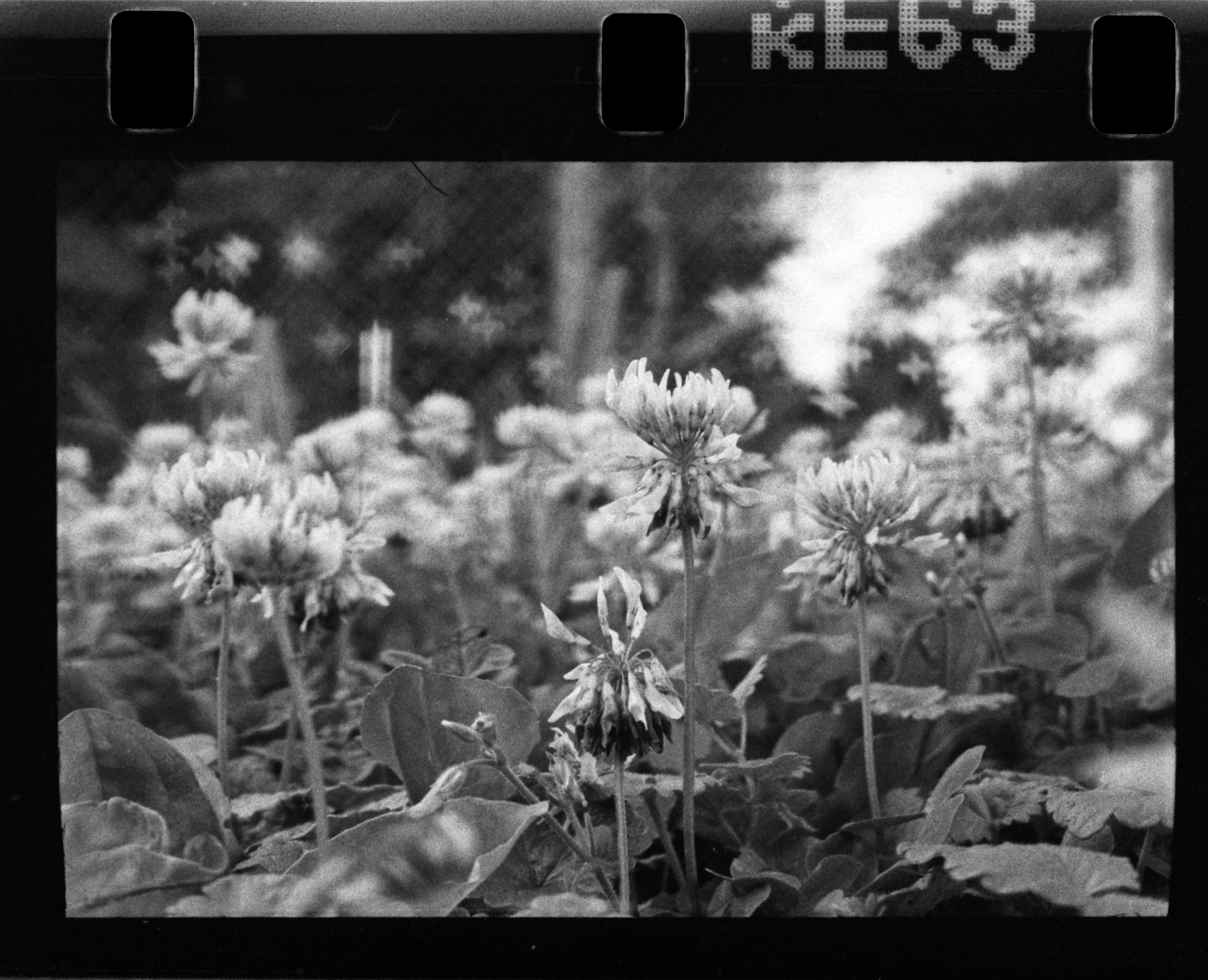

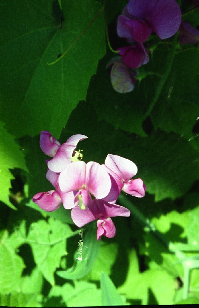

a photo of a pea plant from a prior 25cm close-up roll
b&w filmstocks don't have carbon anti-halation (remjet) layers. Only the ECN-2 stocks do IIRC
Edit: this was the MG-S's metering w/ an LR44 1/250s @ 50 iso w/ 50 iso color film

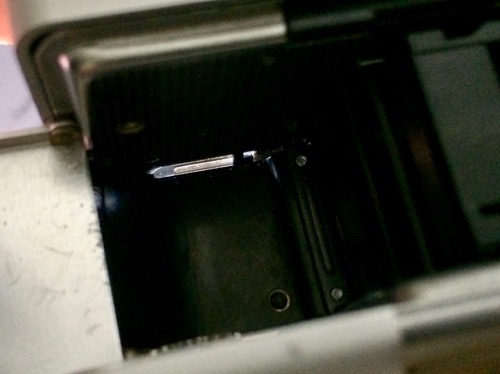

I developed a roll of Kodak micro film that I loaded in my Rollei E110. On the upside, the spacing was really good. On the downside there was a lot of fog on the roll but not in the frame. So I checked the camera with a flashlight and holy moly Batman! Stupid thing leaks tons of light into the film chamber. Just wondering if anyone can check theirs to see if this is just mine, or they were designed this way... I put the flashlight up against the front bezel on the non moving side. Leaks on both the top and bottom too. If anyone can check theirs and see if it leaks I'd appreciate it. Other than the leak it looks like reloading 110 in a Rollei is completely doable. And by the way, I got 40 exposures on the roll of Microfilm. Not bad.
All three of my A110s do that, it is part of the design that does not need to be light tight. But it does not affect the image due to the way the 110 cartridge is designed. All that matters it that it is light tight around the lens chamber area i.e where the photo is taken. Once a pic is taken it is wound into the light tight cartridge. It's why a camera like this is still light tight:
Good to know Huss! Thanks for checking. I thought maybe someone took out a baffle or something.
I shot another roll tonight and it came out clean as a whistle. I think the problem was the developer. I wanted a super low contrast baseline with the first roll so I developed it with dilute Rodinal and stand. I always rail against stand as a horrible idea, and sure enough, that was the problem. Serves me right for not following my own advice. The roll from tonight I just developed along with some other film and it is fine.
