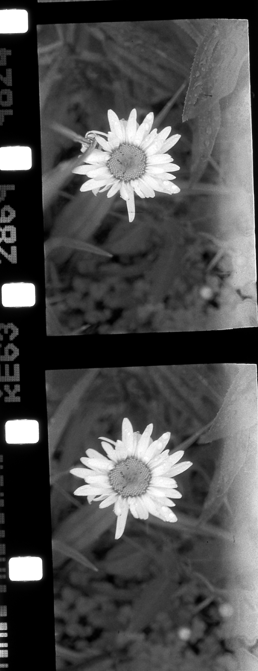

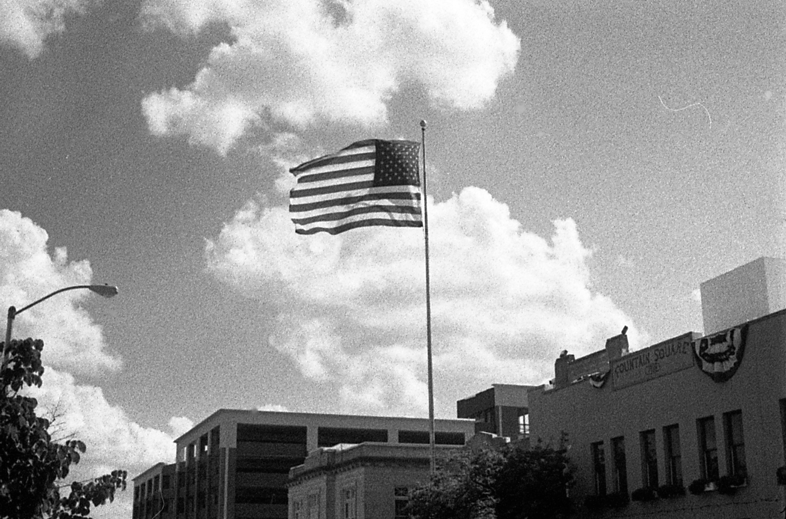

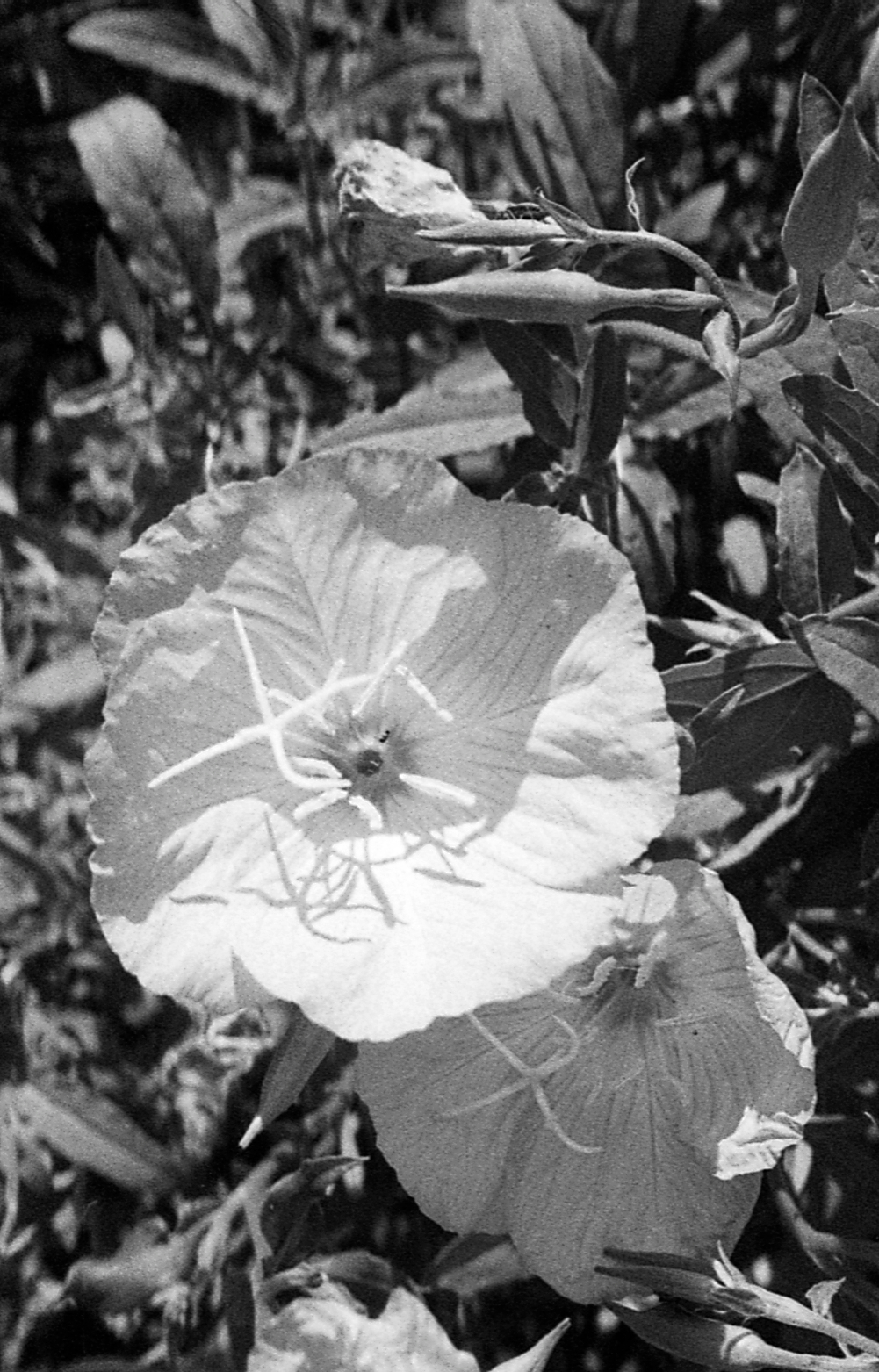

Edit: In the meantime, here's a few more shots from the Double-X in Tmax dev cassette from the other day
Edit 2: If you do attempt reversal, don't forget the bleach step. It's conspicuously missing from the routine you posted.
View attachment 276675 View attachment 276676 View attachment 276677
Those Double X results look good!
Acutance is really the name of the game for a format this small. Vision3 50D is supremely fine-grained and 'sharp' in the traditional sense which disproportionally benefits larger formats. The extra crunch from the Tmax dev helps with perceived sharpness of a 12x17mm negative.

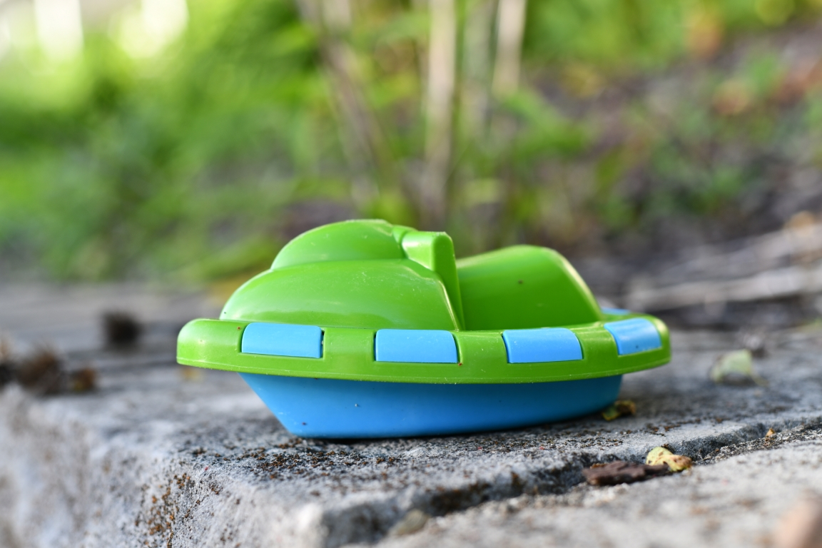

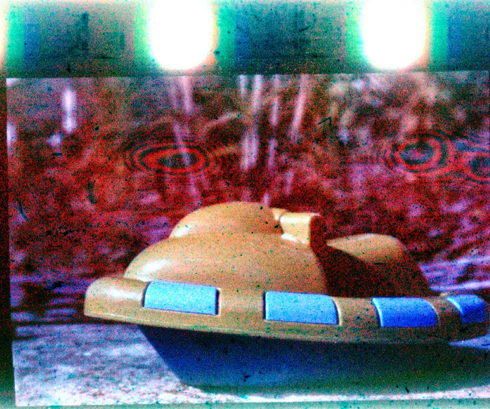

When cross-processing goes wrong... I went looking for a sasquatch but only found a UAP. Bonus newton rings from the anti-gravity drive.
Minolta MG-S @ 25cm; Vision3 50D @ 50; D-96 1st dev; Stale E-6 2nd dev. Needs more exposure and/or a stronger 1st dev among other things.
Edit: Versus a digital control

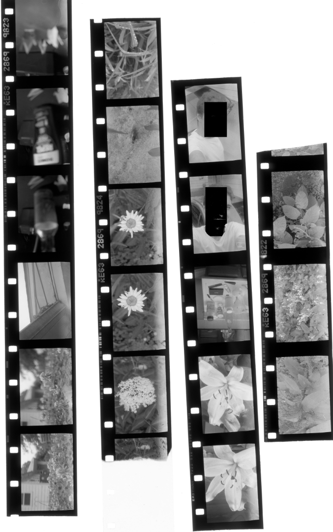

Slighty better results from d-19 reversal of double-x. The flatter contrast of the film compared to tri-x is apparent.
