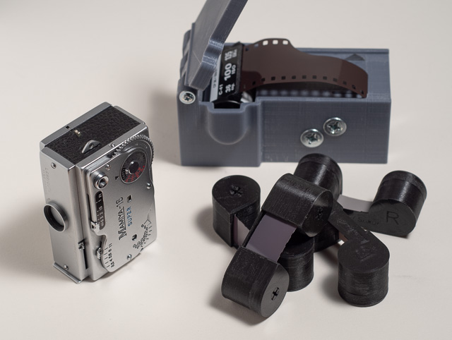

16 mm is proving to be one of my craftsier photo projects: I found a Mamiya 16 Super II at an attractive price because it was sold "For parts / as-is". Fortunately, despite it's diminutive size, it wasn't too hard to service. Mamiya applied grease with a generous hand, but after 60 years, it was in dire need of a freshening up. Shutter speed escapement was bone-dry, focusing helicoid was frozen, and link to the focus control was bent, but the remedies were straightforward.
I 3D-printed a film slitter, and am currently in the process of printing film cassettes. I needed to slightly modify the latter as the designer had assumed single-spindle only, but the Super has a spindle on the supply side of the cassette too: It simply twirls a visual indicator which lets you know that film is advancing properly. The feature was removed from newer Mamiya-16 cameras for good reason: It makes loading the cassette into the camera a lot trickier! It took me awhile but I think I figured out a simple technique which lets me drop the cassette into place without undue frustration or film-wastage: Start with the supply spindle first, lining up the mating parts hand if necessary, and once that drops into place deal with the take-up spindle, which is lots easier. But it's no wonder that Mamiya went through a number of iterations of their film cassettes!

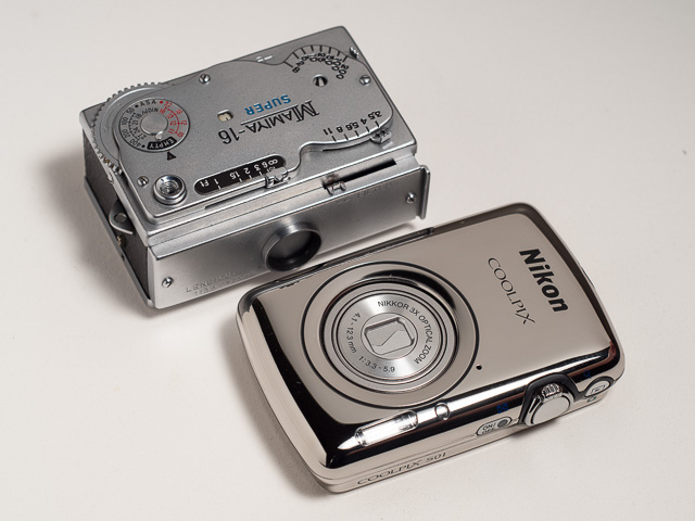

I had no idea those Mamiya 16s were so small.
Got a picture of your printed slitter? I'm kinda looking for one.
I thought I'd take a group photo of the slitter and film cassettes once I've completed them (one more cassette to go). Meanwhile, here's the Thingiverse page:
https://www.thingiverse.com/thing:2103954
No real documentation to speak of, and unless double-edged shaving razor blades fit that bolt pattern, I have no idea what kind of blades the designer had in mind, and the only thing I found at my (USA) hardware store which came close were Stanley carpet blades #11-525 snapped in half lengthwise. Larger bolts are M6 size, and smaller one for hinge is M2.5.
Most ingenious film slitter that I've seen to date was made from nothing more than a matchbox and a couple of hobby knife blades! Wish I could remember where I saw that, think it was old-school Soviet resourcefulness.

I make all my slitters from wood and double edged razor blades held together with 8-32 screws and knurled nuts. The wood blocks are cut on my table saw to 15.5mm thickness with each side to fill out to 35mm film wide then sides to act as a channel for the film.
Kind of hard to describe in words. My last one cuts a 15.7mm plus 9.2mm strips from 35mm film to feed both my Minox IIIs and Minolta 16 cameras. This leaves no waste from 35mm, except the perfed strips which are useless anyway. There is 25mm between the perforations on the Ilford Pan F film I’m using, *just* enough room to get the two strips.

I also have a film slitter design on Thingiverse, designed to use #11 X-acto type blades, and to cut either three 16mm strips or a 127 and a 16 mm strip from 120. I've printed it, but haven't yet cut any film with it.

3D printing is done. I used a small entry-level printer by Monoprice (Mini Delta), given to me as a secondhand gift a couple of years ago. I think the designer of the cassettes didn't anticipate using any light trap material at all, as the opening is only about 1 mm - too thick for light trap material recycled from an old Ilford 35mm cassette or craft-store felt, but still wide enough to admit stray light. I'll treat the cassettes as light-leaky for now (16 mm film scraps used for this photo).
