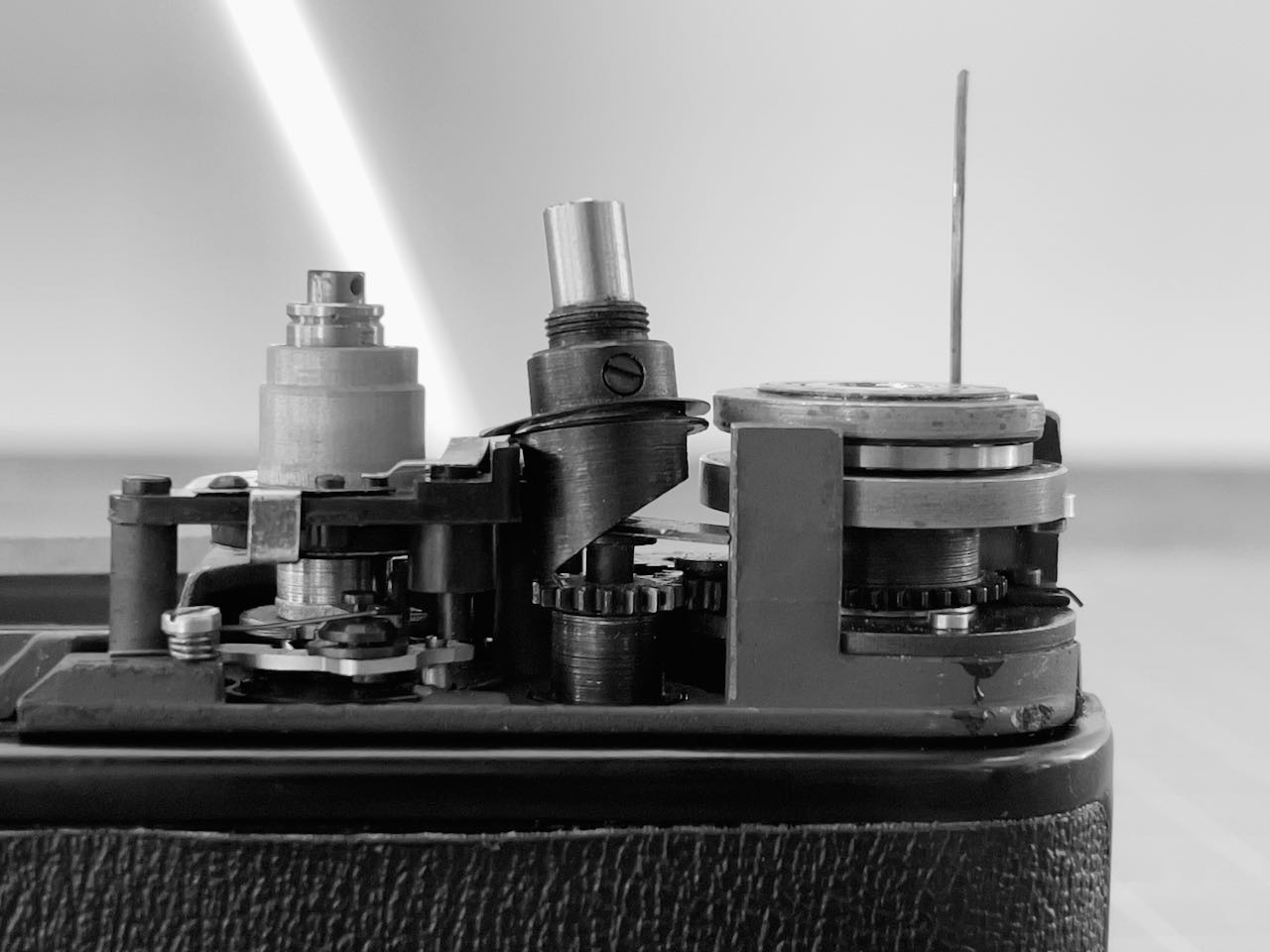

I disassembled the top plate to clean it underneath the buttons, as the camera was sitting in the shed for decades.
I used Zeiss lens wipes and liquid, the same one I use all the time on my Leicas. However, it erased the Zenit logo completely and whatever was white. I’m now careful about the marks for X/M and Reverse, but I’m wondering what solution is best for cleaning body on this camera?
Also, have anyone replaced the leather on their EM? Mine looks quite bad and I don’t think it can be saved, but I can’t find anyone selling the replacement leather for this model.
For models without the light meter in the top, I dunk them in water & washing up liquid. Use cotton buds to get into the crevasses. For models like yours, rather than dunk them, I use cotton buds soaked in washing up liquid & water to carefully clean them. I then carefully dry the top. I have tried furniture polish (type suitable for plastics, not wood wax stuff) this works well & also car polish brings the bodywork up nicely.
Be careful of anything with solvents in them, like lens wipes that probably contain alcohol. They can remove paint.
For the vinyl covering, some peeps do replace it, but to me, this then loses the authenticity of the camera. If the covering is lifting, use a low viscosity impact adhesive like Bostick (Evo stick is too thick) and carefully put a little bit in using a cocktail stick. Don't wait for it to go off, push the coving straight on. Key is to use only a small amount, so it does not ooze out.

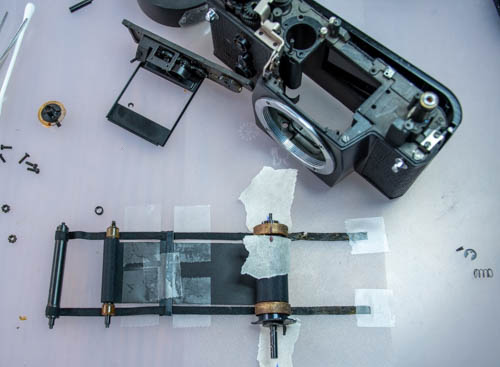

I made a camera shutter tester. Details are on here somewhere. To adjust the shutter is a nightmare. The normal cause of erratic shutter speeds is the old grease on the shutter rollers gumming up. The only way to repair is to remove the shutter mech and mirror lift assist spring, clean and relubricate. I have done this on a number of cameras, but it takes days and requires almost the whole camera to be disassembled to get the shutter mech out.
To adjust the shutter, I had to make two special tools to hold the locking nuts on the rollers & mirror lift spring. They actually look like cogs but have circular teeth, so a spanner cannot be used. Trying to do it with long nose pliers really does not work, as it is too easy to release all of the tension and then you have to start all over again.

True - I do have a small case of prism rot on one Zenit. But it is nowhere near a bother - just a small line in the viewfinder and I'm sure I can fix it with your method if needed. I have already removed all the nasty foamy stuff. I was thinking to pack the prism clasp with felt rather than foam - I have a stock of felt that I use for door light seals. Any advice on that?
My main job to do is to remove and replace one tensioning spring or - failing that - to get a whole replacement shutter assembly rebuilt and installed.
Unfortunately, most of my issues are self-inflicted. I have made almost all the mistakes when dismantling and reassembly - but I can say now that I understand how this tricky device works. In that respect a Zenit is the perfect project to learn about the insides of a Leica derived shutter.
Where I got into problems was that the shutter curtain and ribbons needed to be re-glued. After that it worked mechanically but had a small light gap when winding on. After that, I took the shutter out countless times to re-glue it and to adjust the tension on the drums. This all ended up with mashing up one of the locking cogs and dislodging a tensioning spring. (BTW - your special tool to adjust the cogs sounds like a great idea and would have helped.)
But by far - the most frustrating thing are those tiny brass washers that form a thrust bearing between the spindles and the body casting. They stick to the body or drop into the mechanism - however carefully you try to pull the shutter out of the body. Then being brass they don't stick to the magnetic screwdriver to retrieve them to wherever they have found themselves. I am willing to bet a lot of people don't even know if they are actually installed and I'm sure it would work quite well even without them - but it irks me to leave them out.
I don't try to attempt electrics on Zenits. It is not that I am intimidated by it - I gladly attack my automatic processor SLRs (I started professionally with microprocessors many generations ago) - Although I did solder up and repaired (quite nicely) the sync contact track where it was broken by turning too far past the X / M marks.
My approach to Zenits is 'less is more'. I will always go for a basic Zenit B over any more complicated models: no battery, no corrosion, no redundant components. In the same way as you would be able to point and shoot a Leica M3 without metering if you know where you are light-wise - the same applies to a Zenit B. Even if these products are at opposite ends of the quality spectrum they are equally robust in this regard.
If you need a meter - it is far easier these days to get the figures from your iPhone app.

Hi Asteksonus,
I had to take a number of cameras apart and stop at different stages, to work out how to put back together the first one I had dismantled :surprised:)
The little shim washers can appear in different places or not at all, sometimes more than one in one place. I think it just depended on if the builders could be bothered to fit them or not & if a few were stuck together, they went in like that :surprised:)
There are a number of shim washers that live under the TTL, 12xP & 122 wiper plate for the shutter speed. It is important that the same number go back here.
Glueing the ribbon or shutter onto the thinner rollers is no issue. They should be glued one complete turn and just back onto itself, ensuring the rollers are 90 degrees to the ribbon/curtain. However, the larger drum, with shutter curtain in the middle and ribbon on the outside is a different matter. This is where the shutter mech is indexed from & must be glued with total precision.
My method, providing the curtain/ribbons have not yet come un-glued. Normally, they have started to un-glue on the inner side, not the end (if you see what I mean. So, I peel back a little and re-glue using rubber solution glue (bike tyre repair stuff) Once set, I peel off the end of the ribbons, back to the new glue, then re-glue and ensure, as per the other side, the ribbon goes all the way around the drum and just back onto itself. This is then repeated for the curtain.
If the drum side has already let go, then a shutter jig is needed. Using a set of shutters from a camera that has not failed (and re-glueing as above), this can be laid out on a piece of wood. With the drum held in an indexed position (I use the cross-drilled hole) and clamped to stop it moving, the positions of the curtains can be marked. I made little clams to hold them there. Then the ends can be re-glued in the correct position onto the drum.
The tensions on the two drums and that of the mirror assist spring set the shutter speed, so without an accurate way to set these, there is no way to set the shutter speed. I have posted details of my shutter tester on the Zenit Camera Club facebook page. It is just an Arduino with two IR sensors & receivers, which measure each shutter curtain, which must be travelling at the same speed, else uneven exposure will occur. The two shutter tensions are not indexed, so a single sensor would give a speed, but not the speed difference between one side of the shutter travel & the other. It is a juggling act to get the curtains both travelling at the same speed and maintain an accurate shutter speed.
Below is a photo of the ribbons on the drum being re-glued. Only the top one came off & got chewed in the cog (a tear can be seen on it, to the right. As the bottom ribbon had not come off, indexing was not lost, so I just taped the curtain to my tray (I always work in a lipped tray, so as not to lose bits) and used some masking tape to make sure inner & outer drum stayed correctly aligned.
