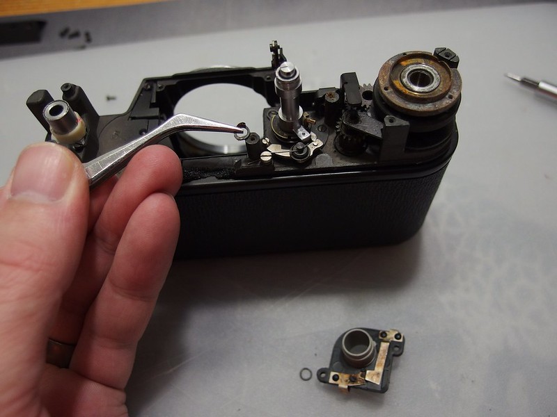

For tonight, I disassembled the top part.

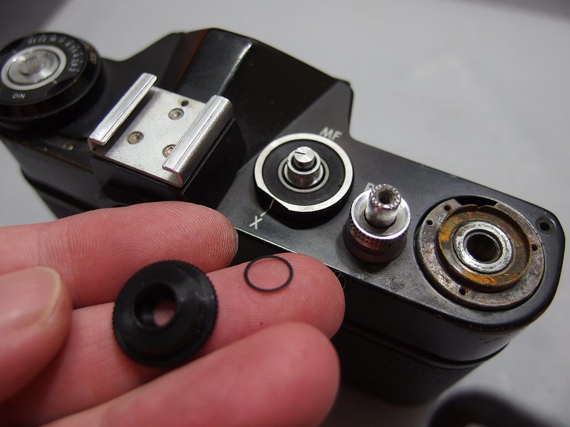

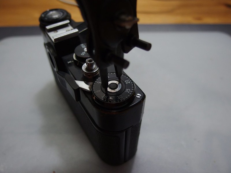

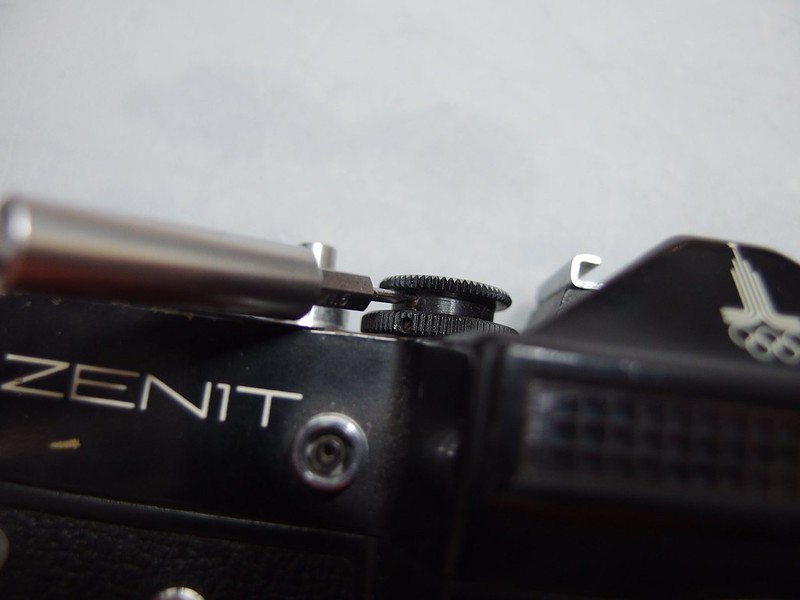

1. Cock the shutter and rotate the top plate clockwise (reverse threaded). I use snap ring pliers that have their pins filed to fit (sharper). Then remove 3 screws that hold the lever
2. Loosen all set screws around shutter dial and shutter button
3. Note that you may have 1 or more shims here and there. Don't loose them

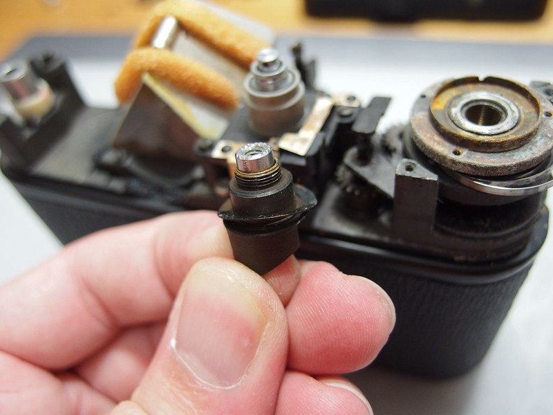

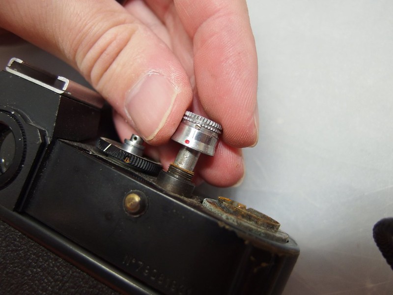

4. Remove film rewind knob (2 screws + long spring). Then you have to improvise a tool to remove top collar and exp calculator. Under it, there are 2 screws that hold the top cover in place. One is next to the shutter cocking lever.
Shutter button assembly

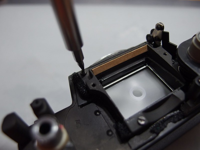

Clean focusing screen as always, they have put sticky substance around the edges that catches possible dust particles.
To lift out mirror assy remove 3 top screws

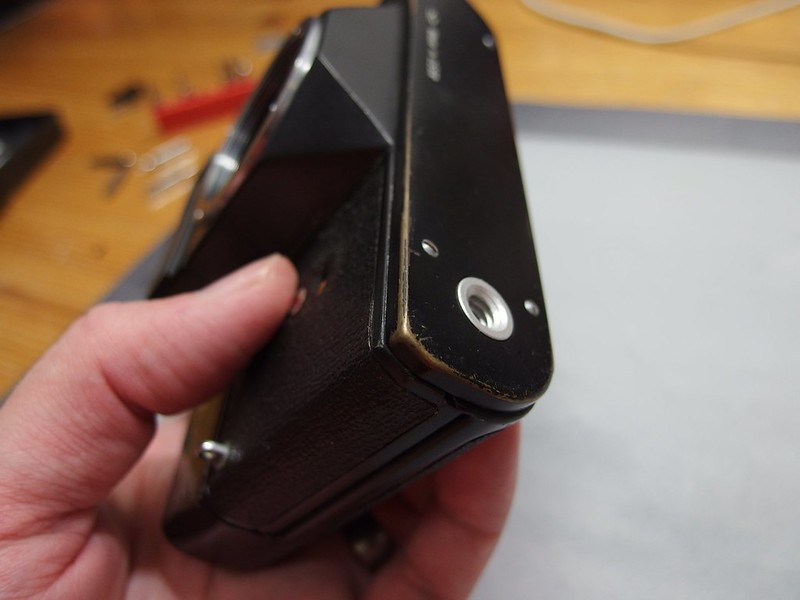

And the bottom cover
Seems that they put more effort to dampen internal reflections in the 70's. Stuff from the 90's aren't this matte..

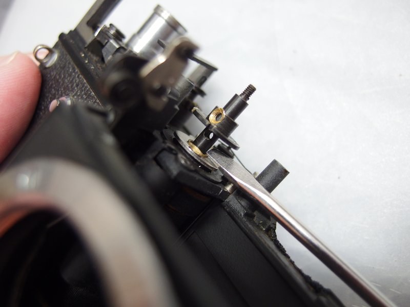

CAREFULLY nudge the shutter timing wheel with flat driver. Mine was quite tight because the screw hole had malformed a bit

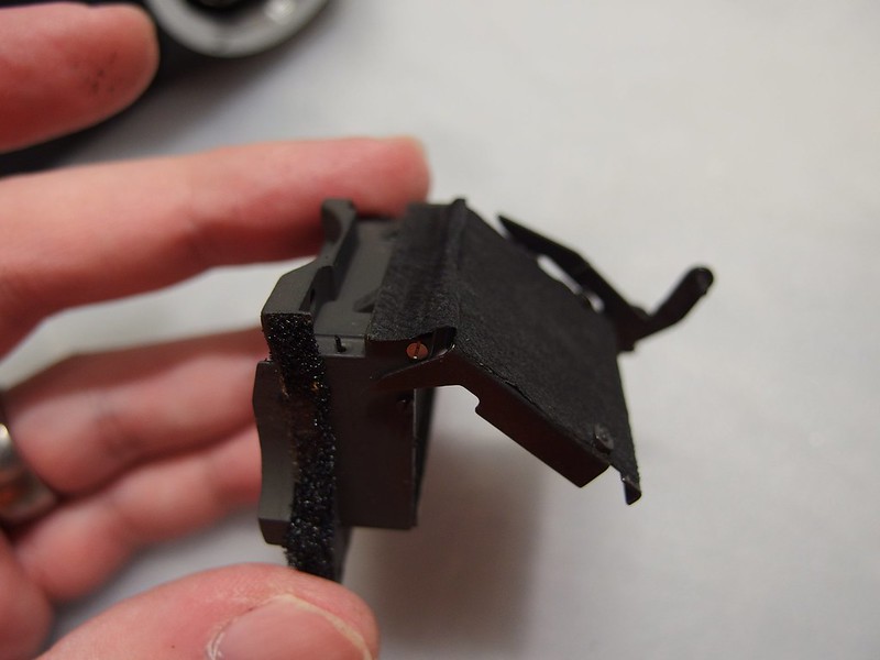

Loosen (but don't remove) the screws holding shutter button spring (the metal plate). Pull out the plate and retighten screws. They also hold the light blocking plate on which the curtains slide, that does not need to be removed.
This pin is for the self-timer release (goes in to the hole)
Remove the left side light plate. Note that you might want to re-install the screw as it also holds the aperture stop down lever hinge (so that it will stay out of the way)

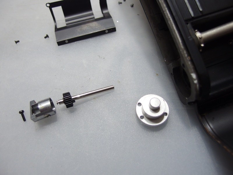

I was not going to do this but since it's simple (just take out screws and lift off) I cleaned the old grease from the winding gears. If these are not well greased you'll get the "grinding gears" -like film advance feel.. Also, this is the only place you can grease significantly. Many other places, like the shutter itself, you only must add a tiiiiny amount of grease to certain places or not at all.
Here's the shutter winding and release gear. It's inside the film advance sprocket "barrel". The small tip on the gear is responsible for releasing the 1st curtain.

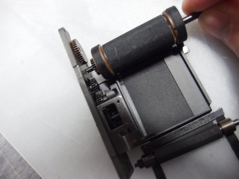

Today I cleaned the shutter gear assembly. I put a tiny amount of light oil into the conical spring gear and equally tiny amount of regular lithium grease to the mirror flipper wheel axle. The mirror flipper wheel has the most stress (pressing the wheel towards the bottom) and it has been greased from the factory as well. Otherwise no oil or grease to the gears, they need to run freely without stickyness.
Here's the mirror flipper wheel

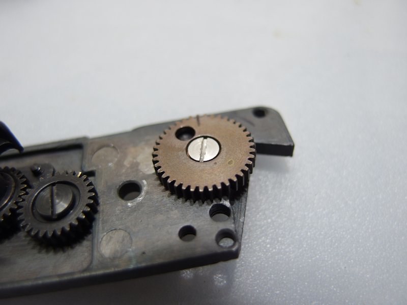

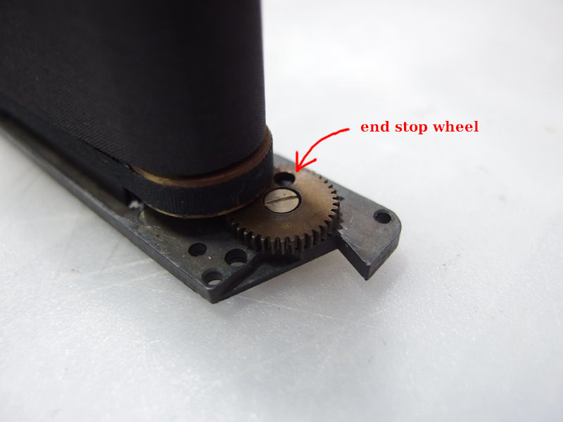

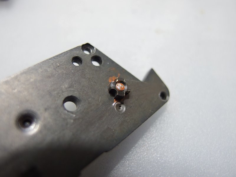

The start/end point gear has a special bearing that is adjustable in tightness and has a VERY delicate copper shim in it. Don't bend it as I did. It's a bit tricky to adjust, but correct way seems to be to put the screw to "a bit too tight" setting, keep it there while tightening the nut on the opposite side, then do final tightening of the screw clockwise. Rotating the screw clockwise also loosens the bearing a suitable amount.

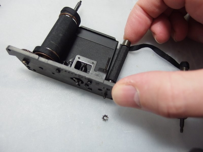

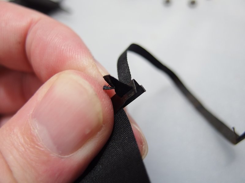

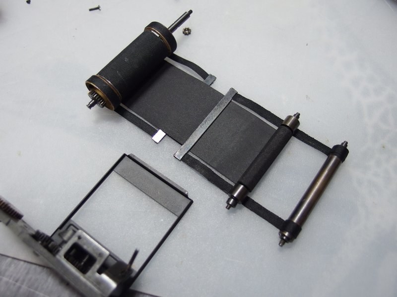

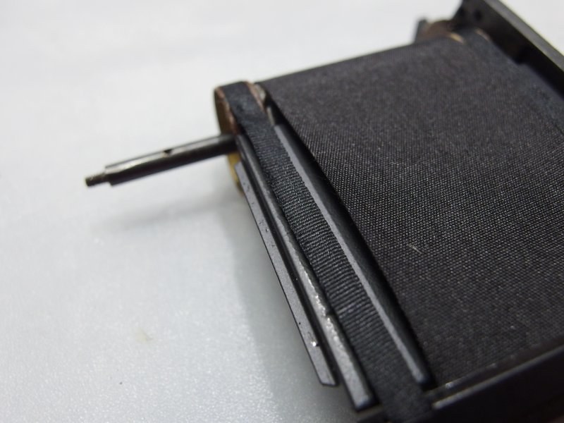

Today I've been putting the one replaced shutter string back to the shutter "blade". It wasn't as hard as I thought, you just need to use sharp knife to open shutter blade edge. I carefully pressed it back again with a flathead screwdriver and then between table vice softened with painter's masking tape. There's also some glue there to ensure the string also stays in the blade.

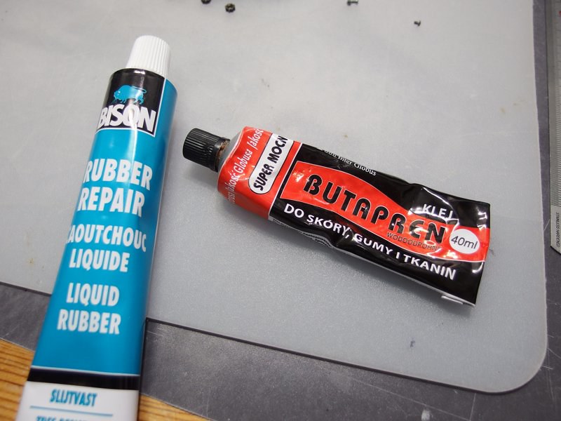

I have been experimenting with these 2 glues both are "sort of" contact glues for fabric. The BISON rubber seems a bit thick for the job, I may need to apply less of it in the future. See below picture
The "BUTAPREM" is a Polish rubber contact glue, it's very thin and does not mess things too much, seems optimal for many projects. Both glues do not adhere too well. Sort of like a strong tape. So you can dismantle things again if needed.
The shutter in this EM was operating OK in the sense that the curtains were not detached - but the factory glue was just gone to dust and barely held the curtains on the rollers. Just barely. Still they hold enough..
I had to disassemble and clean one Jupiter-9 so this project has had some break but now it might continue.

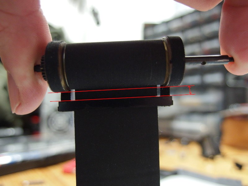

I glued the one curtain string back to the main roller. But how to ensure it is straight, glued to the same lenght as the other one? I figured that it's no use to try to measure it, since the strings are not equal (just thereabouts) and how do you measure something that is on a round roller, within 0,5mm?
This method worked ok;
1. tape the string on the roller from it's end using painters masking tape
2. roll the curtain so that the blade comes close to the rollers. this way you can visually quite easily see if it's straight or not (see photo below)
3. adjust if necessary
4. when you think it's ok, use a very tiny drop of super glue and glue the end of the string to the roller. assemble shutter and test
5. if all is OK, disassemble + glue the rest using contact glue

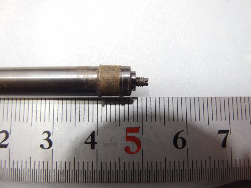

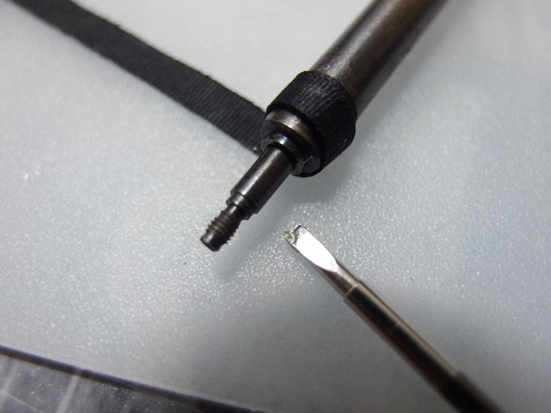

Found out why the upper string had worn. This Zenit probably had 2 faults right from the factory.
The upper roller on the curtain shaft did not have it's hole drilled entirely through. It did rotate but the position was wrong, so that the curtain string was rolling on it only halway. Also, the 2nd curtain had been glued a bit crooked, which meant one of the strings pulling it was tight and the other loose. I fixed it by exchanging the 2nd curtain from a 122.
Correct position for glueing strings on the 2nd curtain tensioner

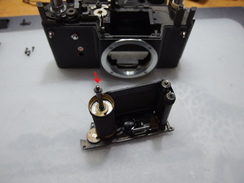

Ready to be lifted to the camera chassis:

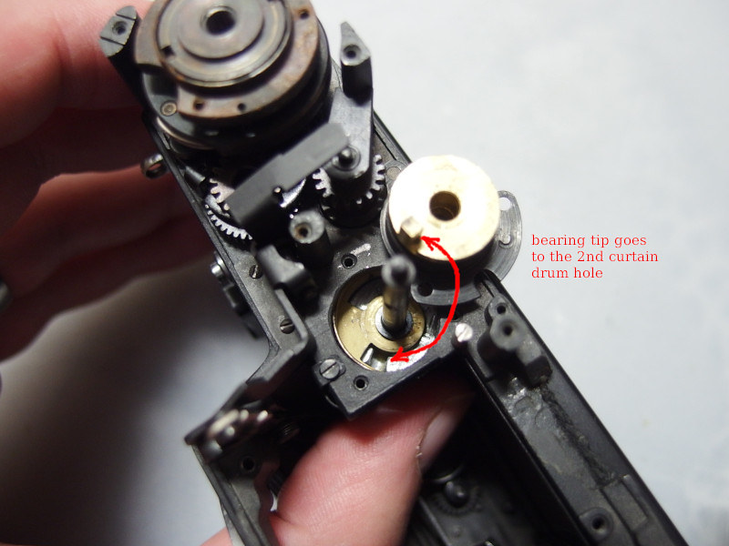

Here you can see how the upper bearing should be aligned to the shutter drum
If the shutter assembly doesn't want to go easily to the camera chassis, most likely the light blocking plate is poking to the camera chassis or the shutter axles are not going to their holes in the camera body. So check those.
Then you should install the bearing and the shutter assembly with a couple of screws. Install the shutter latch mechanism / pin / hook also and you should have a working "B" mode. Check the shutter movement WHILE cocking it:
