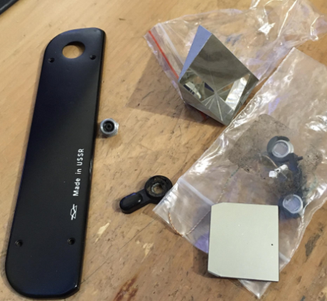

Don't forget that shims and washers can be home-made from scrap material, and while generic replacement screws may look different, they will work.
I recently replaced a Zenit 412 shutter curtain: The metal lath attached to the rubberized silk had some sharp edges which eventually caused one of the ribbons to break, and by the time I got to it, the curtain itself had stretched out of shape. Not quite ready for use yet, because the shutter curtain bounces at the end of it's travel, enough to re-expose the film.

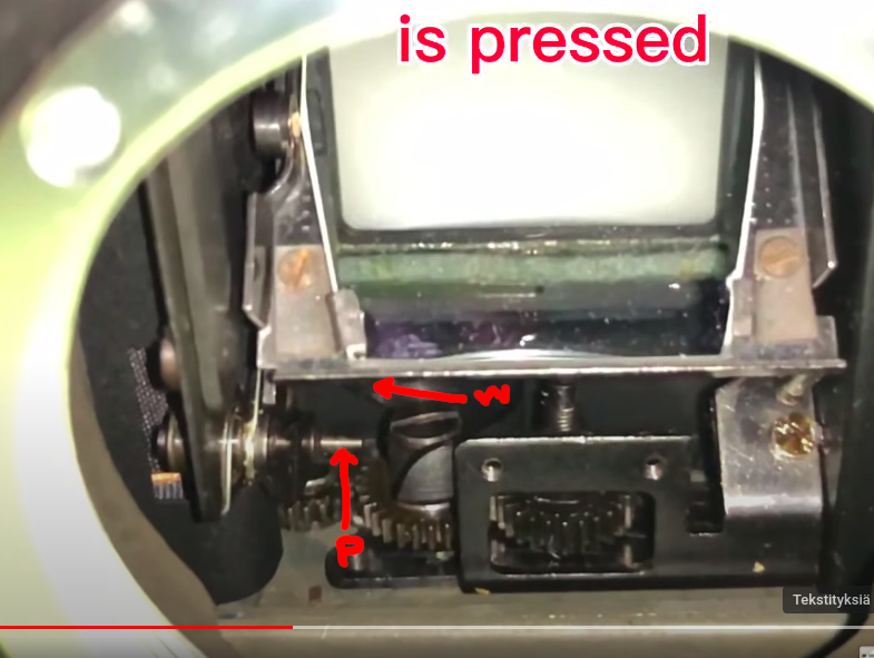

Hello.
I bought Zenit E in really good shape. Everything is smooth and shutter works correctly. But few days ago, Bulb mode stopped working. Shutter works correctly, it stays open when I lock the shutter release button. But mirror doesn’t lock up.
I’ve opened the Mirror mechanism cover and noticed one thing: when the shutter is pressed, mirror goes up, curtains are opened but the mirror falls down like on 1/Xs shutter (the lifting gear doesn’t stop in the locking position). When I release the shutter button, Curtain is closed, but the Mirror mechanism doesn’t move at all, like it should. Can this be fixed or not?
Here is a slow motion video on Youtube:

Hello Sven!
Yes it seems the "flipper wheel" isn't in the right gear tooth at all. When in Bulb mode, the filipper wheels lastmost edge (W) should be under the pin (P) keeping the mirror in up position while you press the shutter button. In your camera, the wheel edge goes too far past the pin, clockwise. This will also affect normal exposures, not just B.
Why the gear is not at the right tooth if it previously was, is strange. Or has the mirror mechanism mount bracket (at the left in your video) got so loose, that the pin (P) is not correctly aligned to the flipper wheel anymore?
It could be that the flipper wheel screw (in the middle of it) has come loose? If you turn camera upside down, will the gear slip out of tooths?

Hello.
Thanks a lot!
-Sven
Hi,
Looks like the flipper wheel is totally out of alignment. It is a relatively easy fix, I have had a few 'new in box' with the same fault. My guess is the cameras were used, did not work correctly and then returned. Probably explains why your camera was mint. If the mirror mech is not aligned correctly, the mirror may be in the way during an exposure, at any speed.
The top will require removal. The prism removed (This is the time to also remove the old sticky prism foam and replace, else it will ruin your prism, as should be done on every Zenit).
Remove prism and the mirror mech. You can now look down and see the screw that holds the mirror lifting cam.
Loosen the screw holding the cam, but do not lift it before holding the gear next to it, with the spring on top, in position, use a screwdriver in the gear to hold it. Best if a second person does this.
You can now lift the cam and rotate it to the correct position, which should be so the start of the lifty bit on the cam is just in front of the bar that lifts the mirror. Looks like yours is too far back and the cam needs to be rotated counter clockwise, from the same view as your video.
