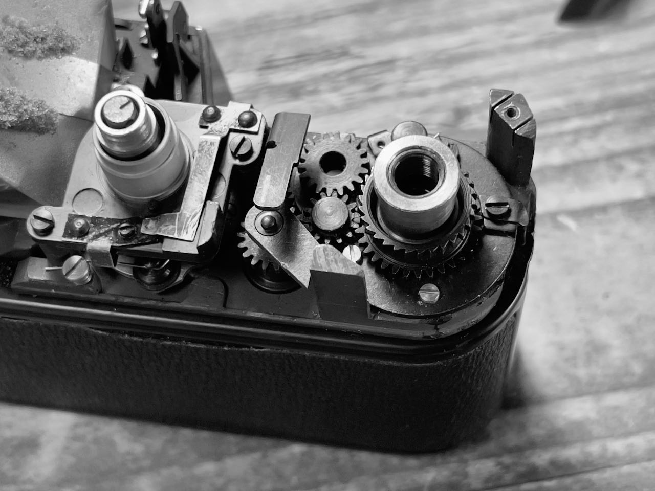

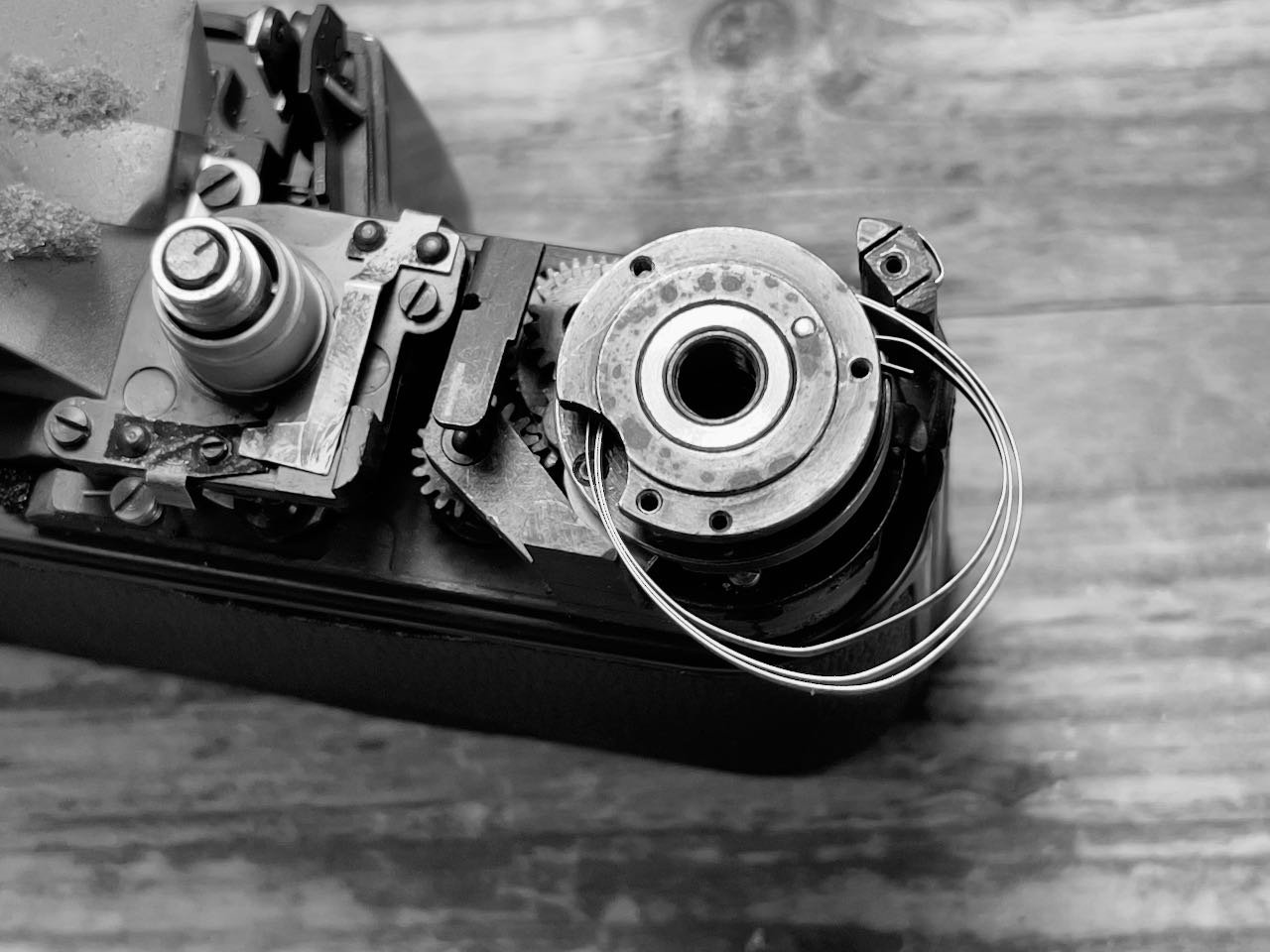

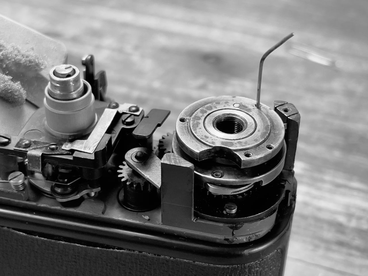

It's been a while since I did the last CLA but I try to make simple list what to do with E and in what order:
1. Before disassebly, if possible, test 1/500 with manual video capable camera with high shutter speed, to see if the slit width is OK. Then you can adjust it (if necessary) during re-glueing of the curtains
2. Adjust mirror to precisely 45 degree angle with the adjusting screw under it. I've used distant scenery with 50mm lens for this. Idea is to adjust until left/right and upper/lower portions of the image in the VF become in focus at precisely the same focus ring distance setting
3. Disasseble camera :smile:
4. When pulling the shutter assy away from the camera, try to keep the main drum axle in it's bottom hole and then mark the position of the stopper gear in relation to the drum gear and mirror flip wheel (so you don't have iterate to find the correct tooth during reinstall..)
5. Clean the drum axles and rollers, maybe lube them also a bit. Clean dried grease from bottom gears etc and lube the mirror flipper wheel axle. Note the correct position of all of them in relation to the drum gear! Although the mirror flipper wheel CAN be removed and adjusted with the shutter unit in camera
6. Re-glue the curtains to the drums. It's not necessary to glue the second curtain to the big main drum. It has lot of glue and surface area, it's not going to let go
7. Assemble the shutter unit, but do NOT fully tighten the light baffle
8. Put the shutter into the body, it's much easier if you remove upper main drum bearing beforehand and put the bearing onto the shaft afterwards. Check that the bearing tooth goes to the drum hole.
9. Tighten the shutter unit to the body with a couple of screws. Assemble shutter controlling latch and slot wheel etc, so you can test it. Put a little tension to drum springs
10. Fiddle with the light baffle for 30 minutes so that there is a good spacious slot between it and the camera body for the shutter curtains to run in. Also check sideways, so that the baffle is in the center of the film opening and the edges do not hit the drums! Tighten it down
11. Put mirror/VF assy to camera. Adjust height of the mirror flipper lever in relation to the flipper wheel using B mode. The mirror shall NOT push against mirror foam, there MUST be some play. Otherwise the mirror mech will slow down the flipper wheel which directly slows down or stops the curtains!
12. Fiddle another 30 minutes with the side light baffle, so that it does not hit any curtain roller causing them to slow down
13. Adjust the conical helper spring / gear so, that it is neutral or very slightly pushes the 1st curtain drum + mirror flipper wheel clockwise (looking from the lens mount)
14. There's some play in the mirror assy screw holes. According to point 2., adjust the whole assy back or forth. If your lens did not reach infinity properly (hit the stop before it), put mirror assy towards lens mount (mirror closer to lens) and vice versa
15. Assemble rest of camera and do the final adjusting of curtain tensions

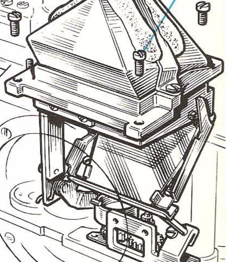

Hello new friends :surprised:) First some good news, I have found a service manual for the Zenit E. It can be found at learncamerarepair.com
It is not 100% perfect, but is of great help taking apart and more importantly, putting back together again. It gives details alignment and how to adjust the curtain tension, although it does not cover in great detail, it is a great starting point.
It is interesting that the Zenit 11 does not have the conical spring, as I thought, the 11 was the final iteration of the E line, being E, EM, ET, 11. I have a TTL here & that does have the conical spring.

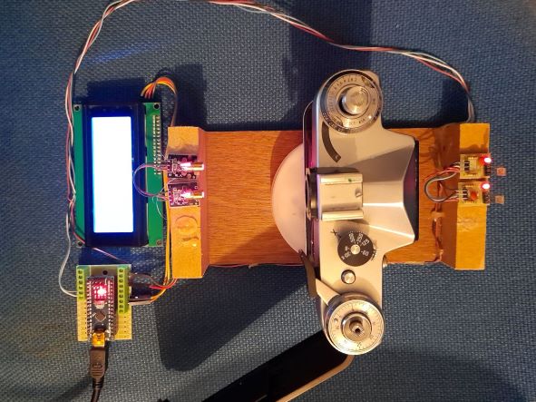

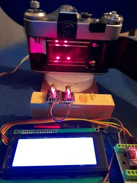

Yes, at least it should be so.. hmm. How exactly does your shutter meter work? Curious :smile:
Hi,
The laser is aligned to shine directly onto the receiver. I built a simple wooden jig to hold the laser and receiver in alignment, hot-gluing them, so they could be aligned whilst the glue cooled.
My jig is built to Box-Brownie length & height. More complex height adjustable solutions could be built with a nice project-box to put it all in.
The camera is placed between the laser & receiver. The Arduino monitors the receiver and when it sees the laser (shutter open) it starts timing, stopping when the laser is blocked by the closing shutter.

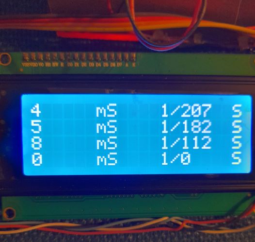

The computer screen shows the microseconds, milliseconds & fractional shutter speed.
LCD shows milliseconds & fractional shutter speed, newest reading at the top.
The photo of the LCD shows my Zenit set to 1/125 shutter speed and three readings taken, right, middle and left of the shutter opening, showing the horrendous variation!
The other photos show how I put it all together. Originally I used two lasers as shown but now I only use one and move the camera to take three readings, right, middle & left.
The parts, Ebay UK dispatch/delivery prices. (Far cheaper direct from China, even cheaper on AliExpress).
Arduino Nano £5.00 (more expensive if you want the header pins pre-soldered)
Arduino Laser Ky-008 £3.85
Arduino laser receiver £3.19 (or get both Laser Tx & Rx direct from China for £2.30)
Arduino 2004 LCD with 2 IC module £6.50 (optional, as display also shown on PC)
Dupont female-female wires 30cm (or longer) £3.25
The photos show my Arduino Nano in a prototyping board, this particular one connects the header pins to screw terminals. I soldered directly to the laser and receiver board (as I did not have long enough Dupont wires), but using Dupont wires for everything is simpler.
The Arduino Nano is almost identical to the Uno, there are plenty of 'getting started with Arduinio' tutorials on the YouTube, showing how to download the program and connecting to the Arduino.
I'm happy to supply my code should you wish to build one.
(wiring is easy, connect Vcc on Laser, receiver & LCD to the +5V on the Nano.
connect 0V of Laser, receiver & LCD to the 0V on the Nano.
Wire from 'out' of the receiver to pin 2 on Nano.
SDA on LCD goes to A4 on Arduino.
SDL on LCD goes to A5 on Arduino) .

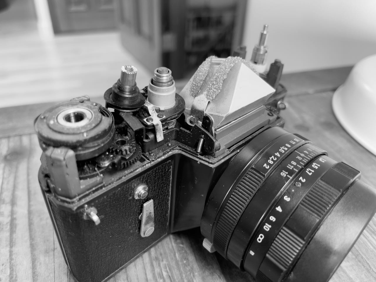

My Zenit E with poor shutter accuracy and then a sticking first curtain, has now been stripped, old lubricant removed, a tad of new lubricant applied and reassembled.
I only had two washers left over, which I did not think was too bad :surprised:)
There is one large washer that I could only find one place where it fitted (top of speed selector arm) so I suspect two were put there in the factory. They are so thin & easily stick together.
The other, a teeny one, no idea. I also found washers added in places the service manual did not detail, under the flash contact plate, for example. Maybe they were acting as shims to adjust the plunger contact height.

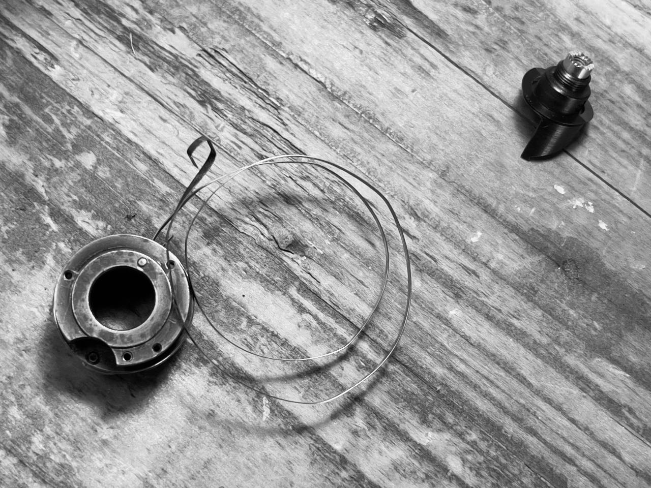

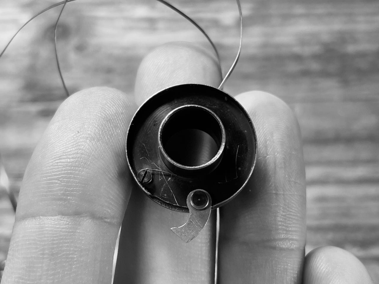

I found, as with the OP, that the conical spring mechanism which operates the mirror and also gives assist to the first curtain was gummed up. This got a flush out & re-lube.
The curtain ribbons were removed and re-glued onto the rollers, as this is a common failure point of the Zenits. Not difficult but one has to be accurate & keep everything square. I made a paper template to ensure everything was aligned.
The blind rollers were degreased and the smallest tad of light oil applied. I was unable to remove the inner shaft and spring, so pulled the shaft gently out as far as it felt safe, wiped with IPA & a tad of oil.
Reassembling the shutter mech was a pig. The OP's comments that the mirror lifting wheel can be adjusted later, saved having to worry about that. So that just leaves just one cog on the bottom bearing plate that has to be in the fully rotated position (can't remember if cc or ccw) when the shutter blind is in the correct position.
It took about four attempts of setting the shutter curtain position, it has to go far further to the left, than one would think, actually going part way round the rollers.
The service guide helpfully tells us that the lug on the second curtain cam must line up with the hole in the body, for the shaft of the retaining lever.
This gem cost me about three hours!
I thought it meant the big brass lug that sticks out of the bottom of the cam. It does not, it means the thin pressed steel thingy on the top.
The diagram of the assembled shutter also shows a view of the second curtain drum, I assumed this would be drawn in the correct orientation, it is not.
More time gone.
Once the cam was aligned with said hole, the shutter looked to be in the correct position, so a little tension was added to the curtain roller springs and shutter drum turned, all seemed well.
(This is where the previous attempts showed that the shutter in the cocked position was too far to the right)
So back into the body the shutter mech goes. Hardest part over.
Added a few more parts as per the service manual & the shutter can be tested on B setting, with tension added to rollers and conical spring.
All seemed ok. So put it all back together, mirror box in & out a few times to get the mirror up cam set in the correct position.
The lightest of lubrication added to the gears and a light grease to the cocking spring was added.
The top plate, I left off, to see the workings.
Following the service manual, tension of 2 1/2 turns was added to the conical spring & second curtain just enough to make it operate correctly and first curtain 'considerably more' as the service manual helpfully tells us.
Well, success, all is working and after tinkering with the spring tensions, I have
1/30 sec setting giving 1/44 and 1/33 on left & right of shutter.
and at 1/500 setting 1/534 and 1/419
This, I think, is as close as it will ever be and is 'within acceptable tolerance' as worded in the manual.
Yes, seems okay, at least the 1/500 is excellent. The 1/30 maybe a bit fast, I would try less rotations on the conical mirror helper spring.
There's one thing that came to my mind, about the speed test setup. Since you are using point lights, it could be that the dropping mirror is fooling it a bit. The mirror starts to come down already when the second curtain is only halfway closed. Seems moronic but the mechanism is very simple and it does not affect real-world exposure that much, because backmost lenses in optics are quite big usually and the left side of picture frame will receive light even if the mirror blocks half of the lens. If you want to experiment, maybe tape the mirror to the ceiling of mirror box and try to test shutter then.

What is the mechanical reason for this design?
The mirror mech consists of 3 parts
- hinged mirror with spring
- one lever for pushing the mirror up
- rotating "cup" with cutout on its side that pushes the lever up
The rotating disk rotates in tandem with curtain roller, so it has the same number of rotations (well, one.. ). It's just barely sufficient to complete the cycle. The cutout in the "cup" catches the lever knob, pushes it up, and when the lever knob reaches the cutout edge again, the mirror comes down.

Thank all for the valuable information. Would it be possible to post the sketch for the Arduino shutter meter?. Thank you again!
Niglyn
Feb 26, 2022
489
Surrey, UK
Analog
Hi,
Sorry only just seen your message.
Sure, no problem I will send you the sketch via PM (if I can work out how)
I was thinking of doing a step by step guide, with photos of the parts, connections etc,
as there are a few gotchas, it is not obvious which way the photocell should be fitted onto the board &
the laser pcb is marked 'S' where the voltage input goes.
However, you are the only person intersted, so not worth the effort.
I have gone back to using two lasers, as, after further testing, found they work ok.
Please let me know how you get on with it, & if you have any problems, issues or improvement ideas..

I disassembled the top plate to clean it underneath the buttons, as the camera was sitting in the shed for decades.
I used Zeiss lens wipes and liquid, the same one I use all the time on my Leicas. However, it erased the Zenit logo completely and whatever was white. I’m now careful about the marks for X/M and Reverse, but I’m wondering what solution is best for cleaning body on this camera?
Also, have anyone replaced the leather on their EM? Mine looks quite bad and I don’t think it can be saved, but I can’t find anyone selling the replacement leather for this model.
hiroh
Dec 30, 2021
319
Lisbon
@foc Thanks, this looks good! I ordered Bell & Howel type of leather, it looks the closest to the original Zenit EM.
I’d also appreciate a help from anyone experienced in assembling Zenit EM. I have no experience with this by any means. I never opened any camera myself before and I did it this time just because I couldn’t find a single person in the US who is servicing Zenit cameras + I found this forum thread. I thought putting it back together would be as easy as disassembling it :smile: At the end, this is fun and interesting project to learn something from, but it's also frustrating because there are not many resources out there, so I have to either figure it out myself, or ask good people on the forum for help.
So, here is the problem — I removed the top plate, cleaned everything a little bit and now I’m stuck with putting back the winder and shutter. I didn’t take a good photo before removing it and now I’m not sure how the shutter was positioned. This is the only photo I have after removing the top plate. The shutter looks like it's just sitting there and not holding to anything. Is this the correct position? How does it interacts with the other parts? Anything I should pay attention to when I'm putting it back?
Then, somehow, this ring with coiled wire/spring loosened, and while fiddling with it, it fell off. I put it back, but it's tight as long as I'm holding it with my fingers. As soon as I release it, in unwinds and it looks like on the photos below. I tried to flip the wire, as I'm not sure I put it right, but this one seems to be the correct position and direction, but I can't find nothing to stop it unwinding. Do I have to hold it with my fingers all the time, while putting back the top plate and screwing the advance lever? Or there's something that can block it after I tighten it manually?
I'm not sure if I was clear, because I don't know the official names for these parts, as there is no service manual for EM. I downloaded the "Zenit-E service procedure", but many of the parts there are different.
hiroh
Dec 30, 2021
319
Lisbon
Ok, I figured out that the small spring in the ratchet assembly should be in the notch of that silver thing (shown in the last photo of my previous post). I put it back so it clicks now again.
I managed to stop unwinding by putting in the paperclip in one of the holes on the top to block the spring.
I still didn't figure how the shutter button should be positioned.
Niglyn
Feb 26, 2022
489
Surrey, UK
Analog
Hi,
Look in the files section for my most excellent guides on Zenits :surprised:)
Firstly you MUST change the foam on top of the prism, else it will DESTROY your prism. Please refer to my most excellent guides :surprised:)
Also change the small piece of foam above the eyepiece, but be careful not to damage the wool door seal directly below it.
Some models also have additional foam for light sealing, change this as well. They will all be breaking down & going gooey.
So you have worked out the 'trick' of using a paperclip to keep the spring wound and also how to locate the teeny hair spring in the ratchet pawl. Very good (did I mention my most excellent guides? :surprised:).
However, you have the spring wound far too tightly, unwind it so it is just inside the winding drum.
Straighten the end of the paperclip. You can mow put the top back on, leaving the paperclip in place.
Fit the winding lever, using the two remaining screw holes. Then you can remove the paperclip and fit the remaining screw.
