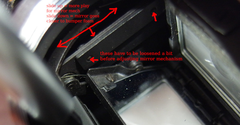

Next step would be installing and adjusting the mirror assy. This is fiddly and important, because it will also affect the 1st curtain.
The newer Zenits (like 12XP and 122 from 80 - 90's) are easier to adjust because they have clamping springs for the big mirror mechanism screws, the EM does not...
1. Loosen the big screws on the mirror assy mechanism "slide"
2. Install assy in the camera body
3. cock the shutter and test
4. if the mirror does not go up OR does not come down again you either have too tight setting that stops the 1st curtain altogether, or the flipper wheel is @ the wrong tooth (there's only one right gear tooth it works correctly at)
5. adjust mirror mechanism height
6. remove mirror assy from camera and tighten the screws
7. re-install assy to camera and check mirror again (re-do 3-6 again if not ok)

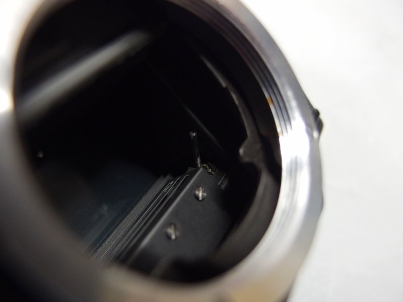

The mirror slide mechanism height adjustment screw is next to the prism behind aperture lever mech
Here's the sliding mechanism that affects how much the mirror flipper pin is pressed towards the mirror flipper wheel
Here's a video how much there should be play. Maybe not more than this, because the mirror may start blocking light from lens back element

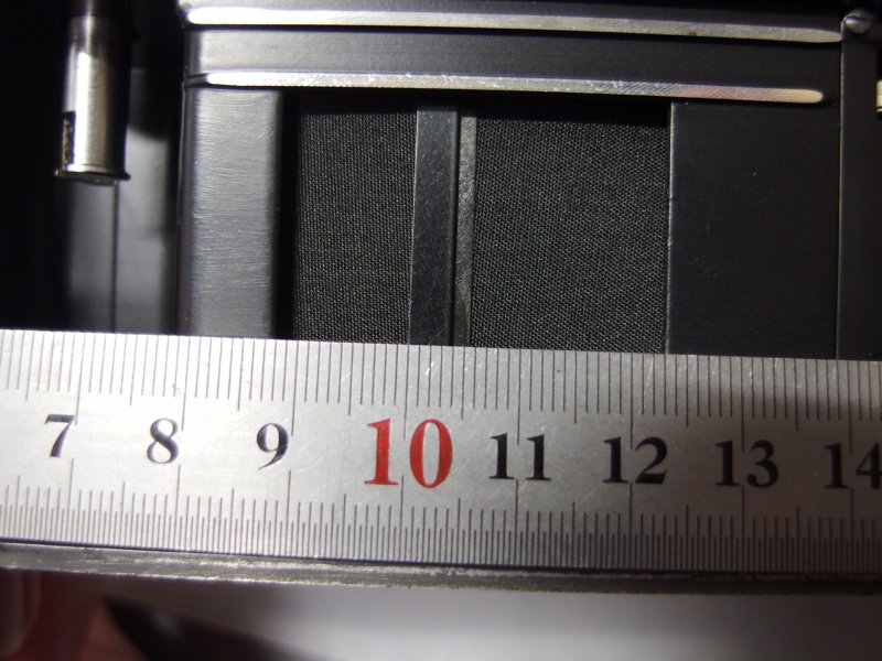

The curtain blades are about 4mm wide, so one can estimate slit width with that in mind.
The film frame is 36mm wide. So in principle, for different speeds, the curtain slit:
1/30: 36mm
1/60: 18mm
1/125: 9mm
1/250: 4.5mm
1/500: 2.25mm
It's worth noting that the E has no way of adjusting the slit. If the curtains are poorly glued to the drums in wrong places - and you find that out during adjustments - you must disassemble it and re-do everything.

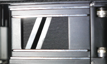

Here are 1/500 photos. NOTE: the curtains are of course perpendicular. The obliqueness is because of digital camera "rolling shutter" effect. Google it.
Shutter at start:
Middle-ish:
End:
You may ask why is the slit wider at the end? The curtain is fastest at there. And slow at the beginning. I have read somewhere that you should adjust the slit that way, and it so far it seems to be true. I have some other Zenits around and they are adjusted this way, and shooting clear skies at 1/500 show no banding or uneven exposure. I believe "one stop" of difference might be OK then? The slit is very accurately 2-3mm at the beginning and probably 4-5mm at the very end of the curtain travel. This is accomplished by setting the 2nd shutter travel time / speed just a bit slower than the 1st.

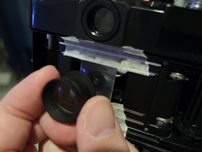

I used a loupe + focusing screen from a 122 to check focus. What you want is actual focus on film plane to match with viewfinder. You can use "Bulb" mode for this. The mirror rest screw in the mirror chamber is used for the fine tuning. It's a bit hard sometimes to wrap your head around on which way to turn the screw :blink: Note also that you should loosen the lock screw below it before ajusting and lock it again before re-checking focus. I have checked focus @ 1m and infinity.
One example:
If your 58mm helios standard lens (recommended!) reaches infinity @ end stop or just a bit before it using film plane, but in the viewfinder you cannot reach infinity --> your mirror is too far from the lens.
The lens goes closer to mirror when you focus far away.
So in that situation you must rotate mirror rest screw counter-clockwise to set mirror higher = closer to the lens rear element.
If you want to be quick, the infinity check is enough, other distances should be just OK if you can reach infinity using the viewfinder (or just slightly beyond).
With my Helios 44M-4 lens, the lens barrel shows also 1 meter pretty accurately, depending on the camera body. It seems to be maybe within 5cm of the actual 1m focus @ film plane.

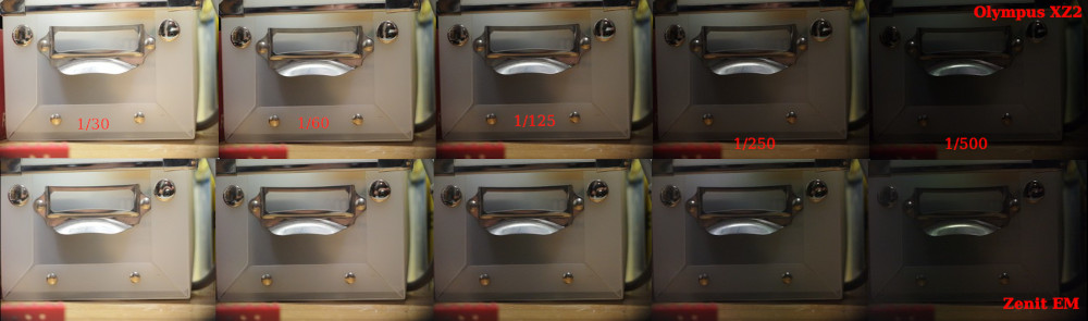

I was doing some focus fine tune and general check (going to use this EM soon again). Did a comparison of EM vs Olympus XZ-2 shutter speeds and resulting lightness of image. I shot these through the film opening, zooming in so that the XZ-2 lens view angle was narrow and no component of the EM darkens or shades the image. Looks pretty good !
