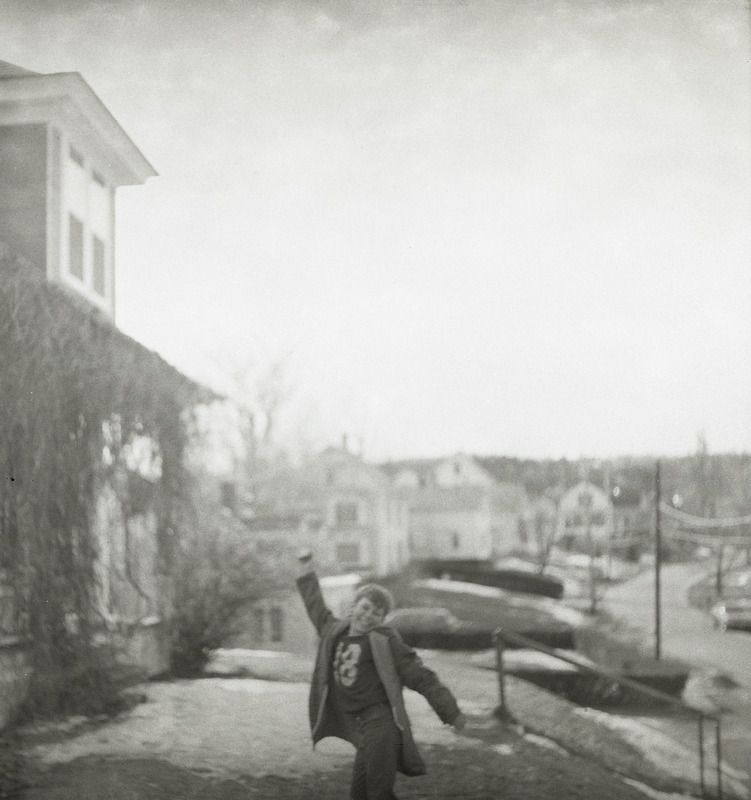

From five rolls of exposed, undeveloped Verichrome Pan a friend found in her folks house while cleaning it out. Much of it has some fairly heavy fog, but ran it in HC-110b at 65° and have usable image. I've not heard back, but I believe this is her in Orleans VT about 1971-2. Her younger daughter looks her spitting image. The four rolls I've run so far have some images of a trip to NYC (from before the Interstate came here) and some landscapes – and, of course – some shots of the dog. Been a fun morning!

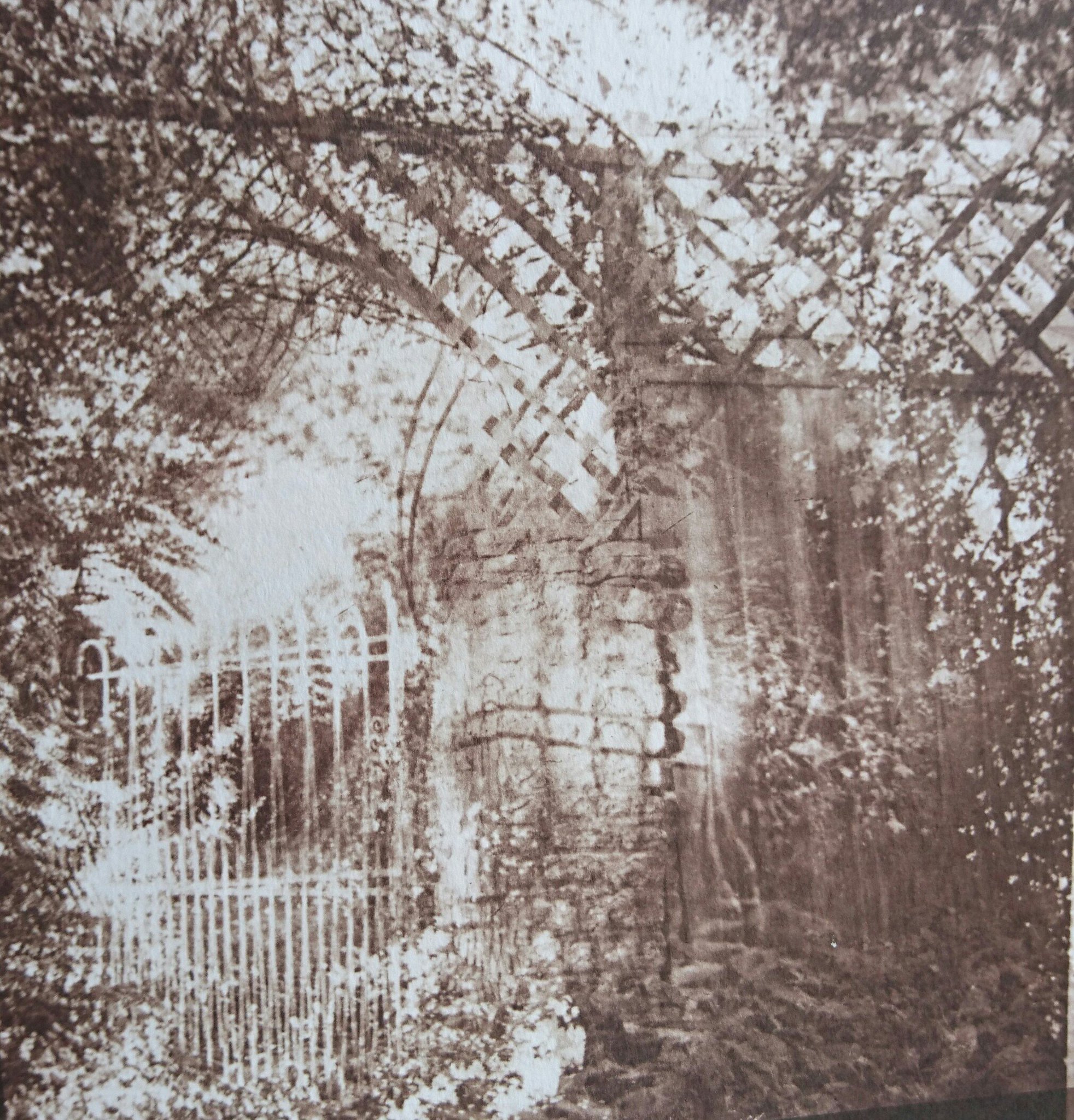

tinted retina print made with hand coated paper
of a cyanotype photogram being made
and you can see the invisble rays of light (yellow)

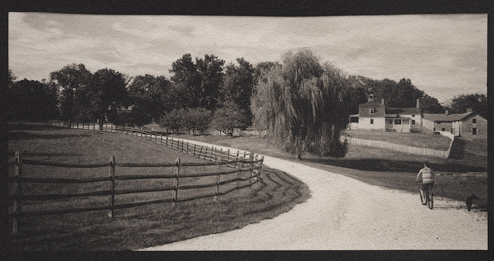

I printed some of the new Sinister Idyll images in palladium - double coated on Hahnemuhle Platinum Rag. Developed in potassium oxalate.
Very, very nice. Nice tonality too.
