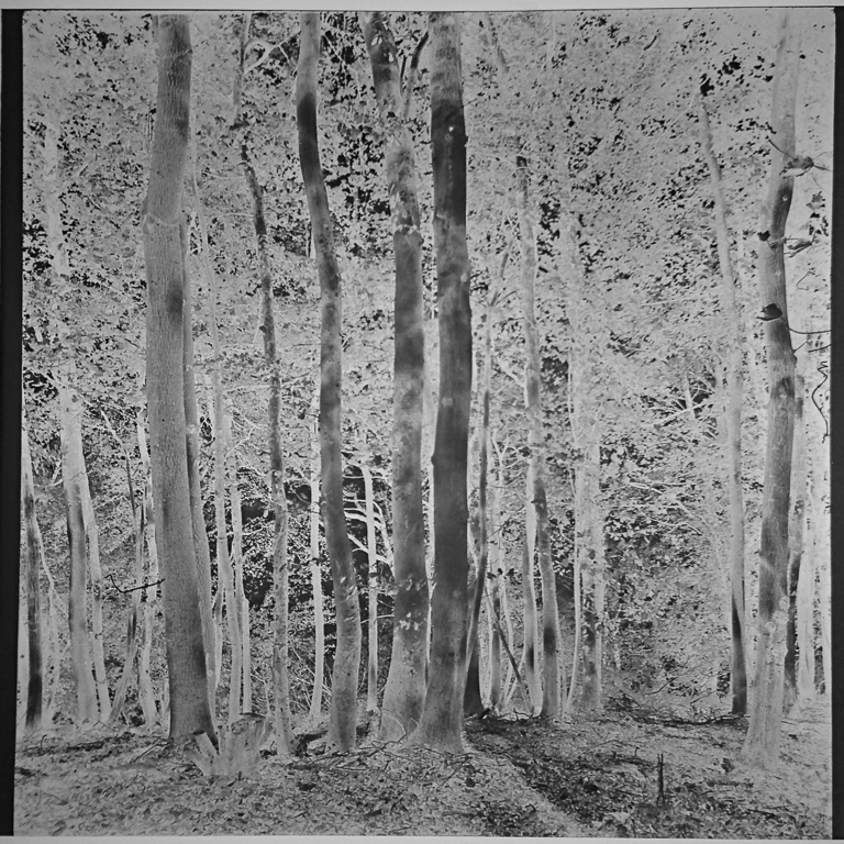

Then a 'phone snap of the negative on a lightbox.
The original neg is a 6x6 HP5 shot in a post-WWII Nettar, duped to positive on 20-30 year old lith film & developed in very dilute D23 with some BZTZ in, then enlarged onto lith again and developed similarly to produce the printing negative.
The highlights are just a bit too dense, so needs a tad less development in the negative stage plus perhaps a bit flatter interpos.
