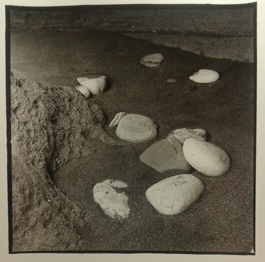

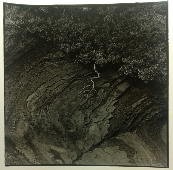

These came out yesterday, after toning. The images you see are phone pictures of the prints, so the tones are slightly different.
I made two prints using Namias' sepiaprint process, 10x8 contacts from an altered/reworked paper negative, prepared from a 35mm negative via interpos.

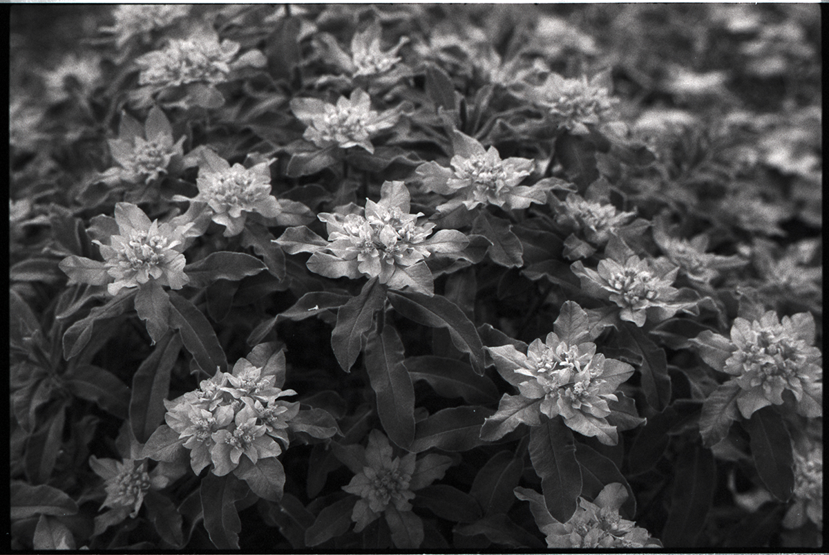

I processed a test roll of mystery film in the form of a couple of Porter's ISO 400 bulk rolls picked up off here from another member. I used 510-pyro and results look pretty good at box speed, and only frame numbers are printed with no hint of a brand.
I shot and developed my first roll of New Seagull 100. So far it looks good - the negs are still drying as we speak.
APX 100 in PC-TEA for 7'30" @20°C.

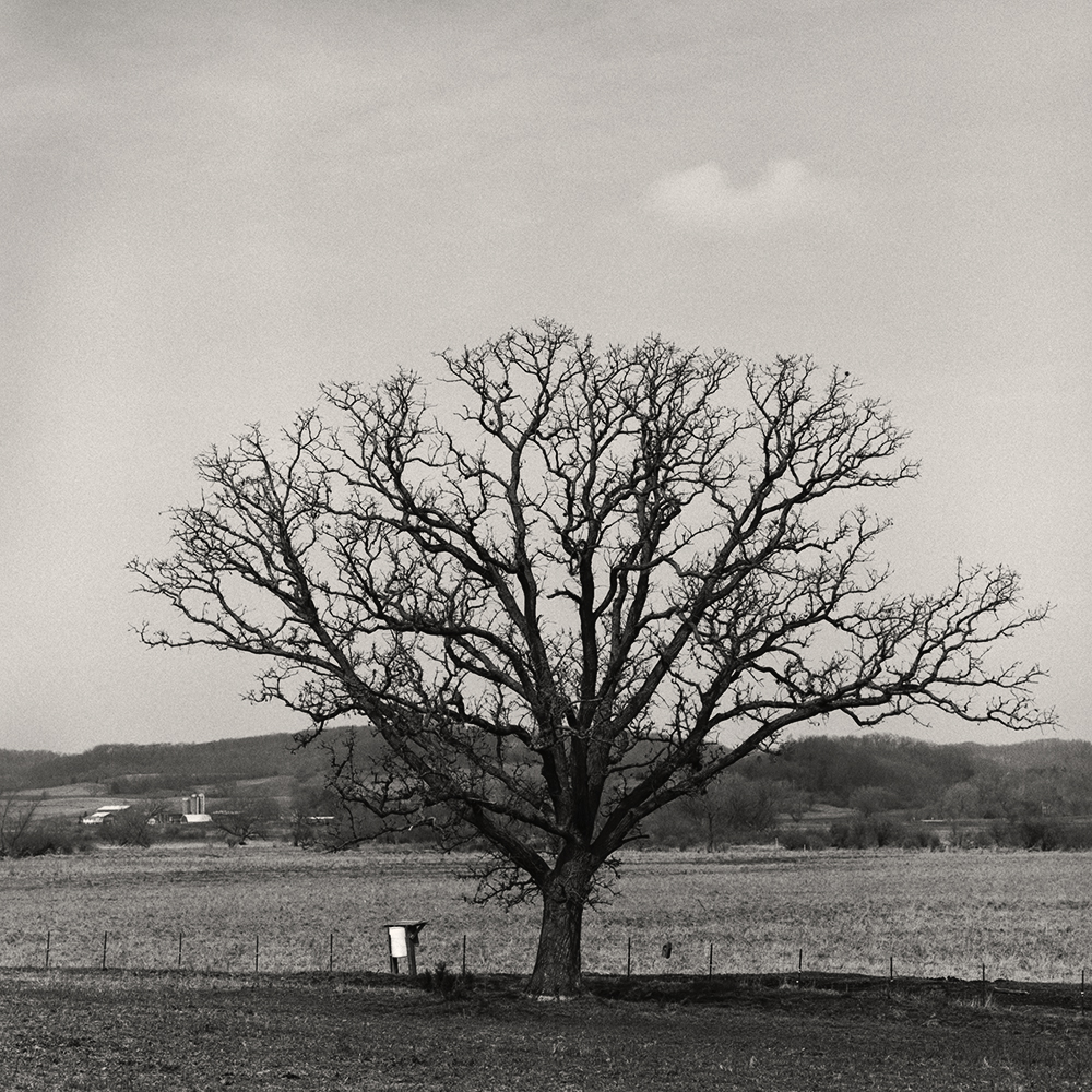

Four rolls of 120 TMax400 in HC-110...32ml concentrate to make one liter (basically, Dil.B for two rolls of film in a tank). At 72F for 7 minutes...processed for platinum/palladium prints. I'll up the time a little for the next batch. Some oldies (my backyard a year ago) mixed with more recent from walks along the river at high water this past winter.
Another twenty rolls to go -- Four from Joshua Tree in February, couple rolls from the Oregon coast, 3 rolls or so of Cornell University and area, and several rolls of various places along the Columbia River Gorge (a roll or so at the Stonehedge replica) and other parts of eastern WA.
The Rolleicord is a fun little camera.

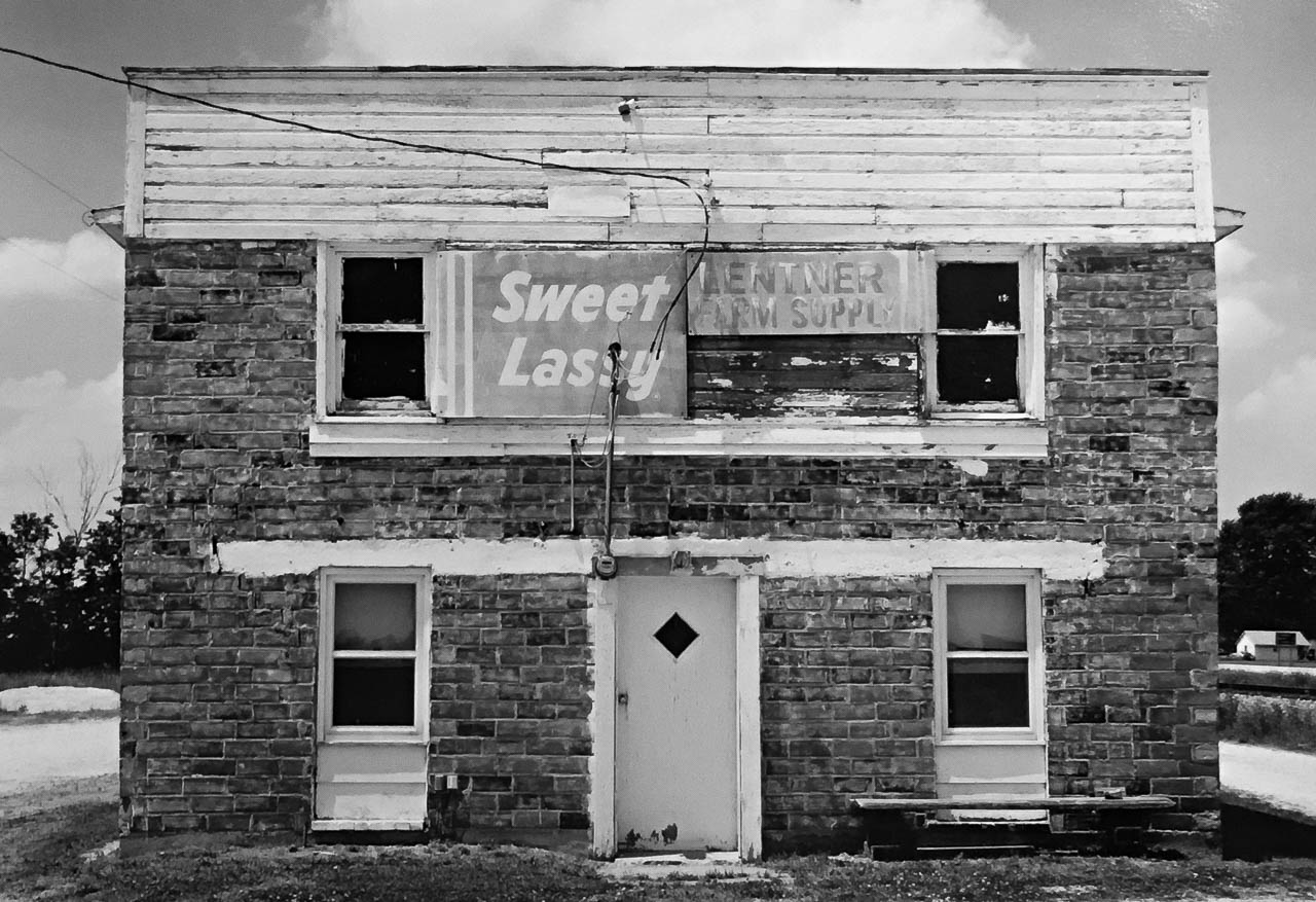

This is a shot I made in the late 90s, but just now getting around to printing. This was made near Lentner, Missouri on US36, an old
Farmer's coop building. It has lots to study and shows many years of the building's evolution.
Tri-X Pan pro, 4x5. Zone VI Wista field camera, Nikkor 120mm SW, 1/60@F16, Yellow Filter. HC-110B, Kodak Polymax Fine Art FB Paper, No Filter, 2.5 min development, Ilford Mulitgrade Developer.
Image produced from scanned original silver print.
