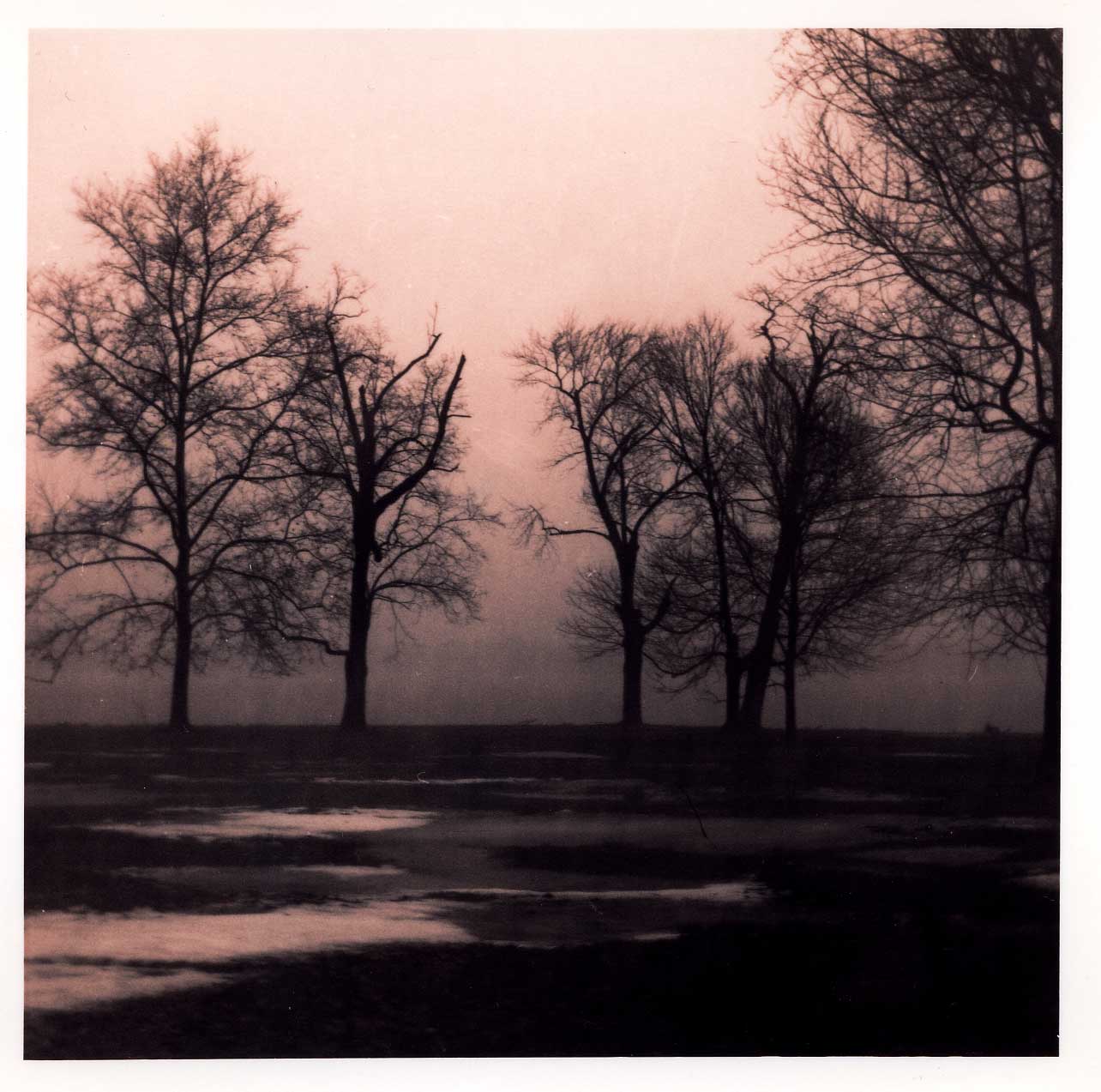

Tom,

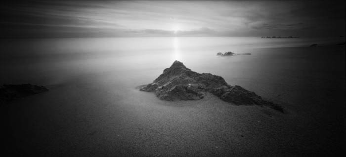

Not only does that shot look nice and sharp(can't fault those Zeiss optics), but the tonal range is absolutely perfect from the dark shadows in the tree leafs right to holding detail in the sky. I've never used FX39, but have used FX37, which was suppose to be close to FX39. Very nice shot anyway.......................John W
Yes, I think both were formulated by Crawley, and Clay Harmon sent me some FX-37 a while back for me to try out, and the results are very similar to FX-39. Maybe the 37 was a little sharper yet.
I plan on using this for 120 film and 135 alike, and the grain is really pretty and sharp with HP5+ / Ilford Pan 400 (same as Kentmere 400) / Tri-X 400 / TMax 400 / Delta 400 etc. Especially for close-up work using 135 it works amazingly well, like portraits and such. For landscape, it depends on the subject matter, vast open skies will not be to everyone's liking for example. I highly recommend Fuji Acros with this developer. The highlight contrast of that film is phenomenal, and suits the developer very well. It makes that film pretty much perfect.

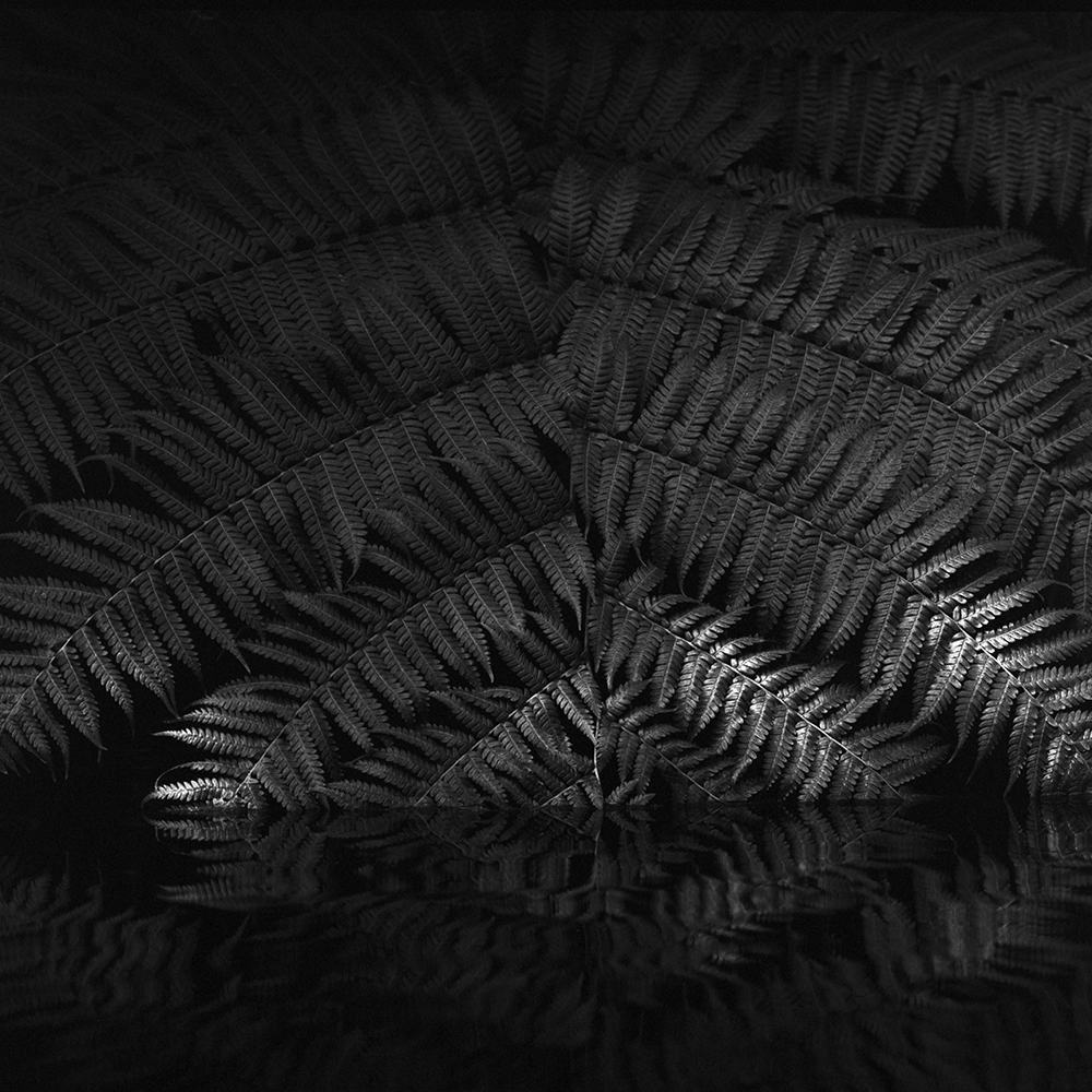

experimenting with blue MXR xray film in my 5x7, I really need to fine tune my development to tame the contrast
How do you process it? Do you work with very dilute developers, or do you have some other way of working with agitation or temperature to get usable results from the X-Ray film?
This was with Rodinal at 1+50 for 8 mins rotary. The contrast is super high, used a 00 filter over my light source to make the contact print. Next time I think 1+100 might be better with that time. Xray film is designed to be high contrast and take only seconds to develop in machines, so getting the right developing time is crucial to getting good prints with more mid tones. I rated this film at iso 100.
Yes, I know it's finicky and usually orthochromatic too. It makes sense to dilute the developer more.

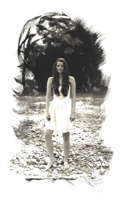

My last imaged printed -- Palladium/Na2 on Crane's Cover, from 5x7 negative (FP4+ in HC-110). Looks like I roughed up the paper a little with the brush.

MXR Blue xray film rated iso 100, developed in Rodinal 1+100/9 minutes@20c
top image with #00 filter on light source, bottom used #2 filter
seems more dilute with longish time gives me the extended tonal range I desire.

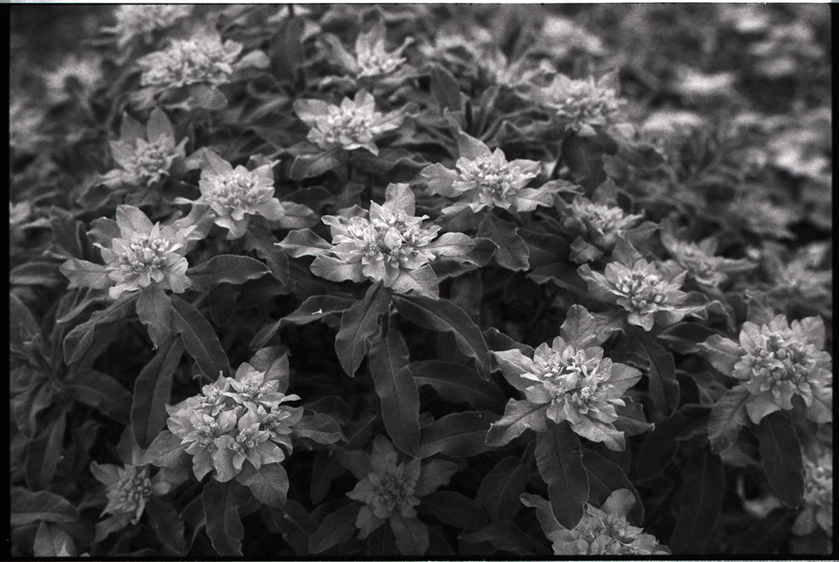

Today I processed:
8 rolls of HP5+ / 120 format
2 rolls of FP4+ / 120 format
1 roll of Fomapan 200 / 120 format (scan attached of one of the frames)
1 roll of Kodak Tri-X 400 / 120 format
1 roll of Fomapan 200 / 135 format
Today I processed:
That's a stunning print, Thomas!

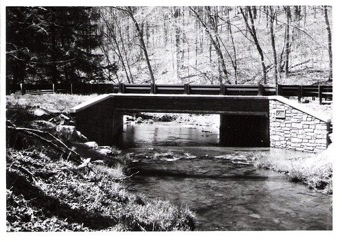

I've printed my first 4x5" negatives, on Adox MCC (8x10") and Ilford MGIV FB (9.5x12"). I've misplaced my grain focuser so I had to eye-ball focus which was sub-optimal, but the image seems sharp enough.
Working with a large negative... :3

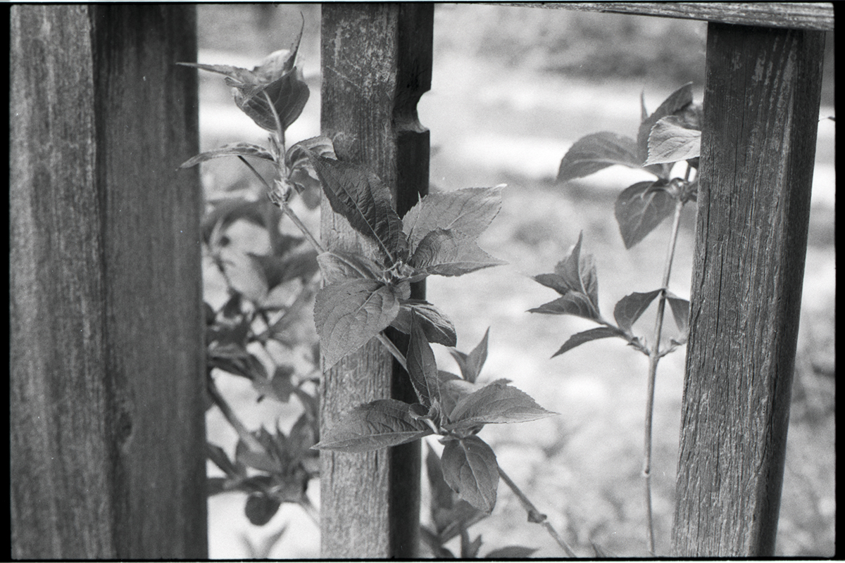

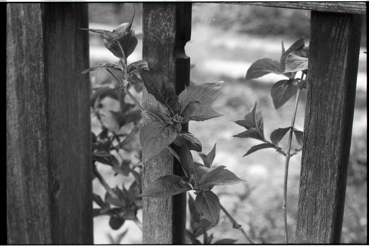

Here's an example of the Fomapan 200 film, processed in ADOX FX-39. Someone asked about that a while back, but I can't find the post.
The lightest picture is EI 50, the middle one is EI 100, and the darkest is EI 200 (box speed). I like it best at 50, honestly, but there's plenty of shadow detail in the EI 100 frame. I don't think I'd use it at 200.

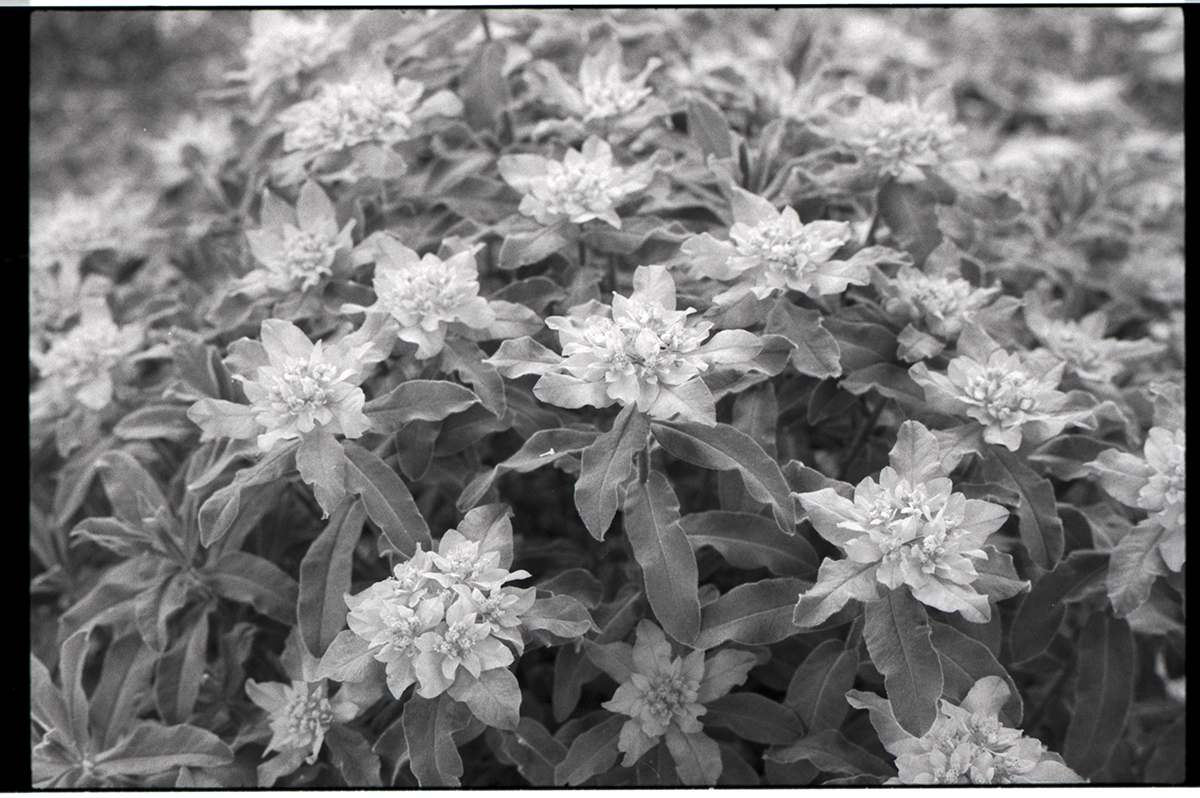

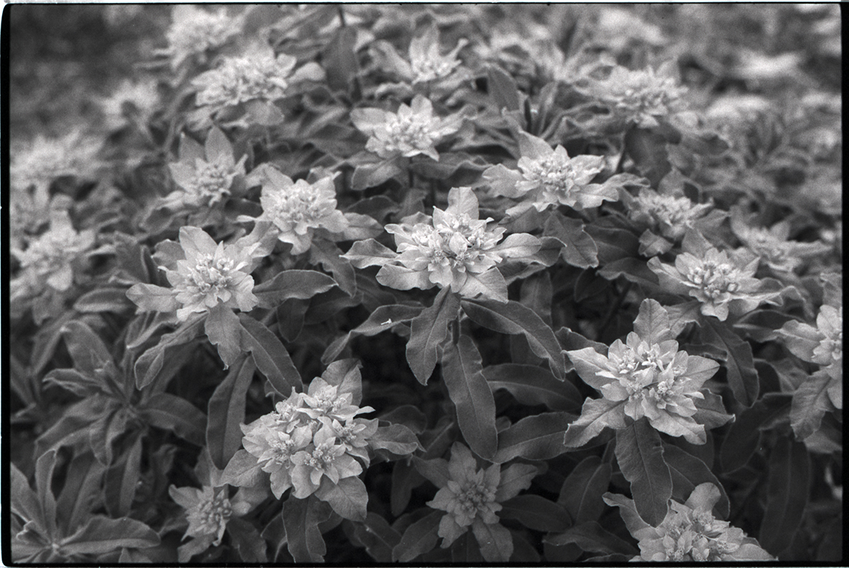

View attachment 156971 View attachment 156972 View attachment 156973
Here are two more examples. EI 100 and EI 50 - in that order left to right.
