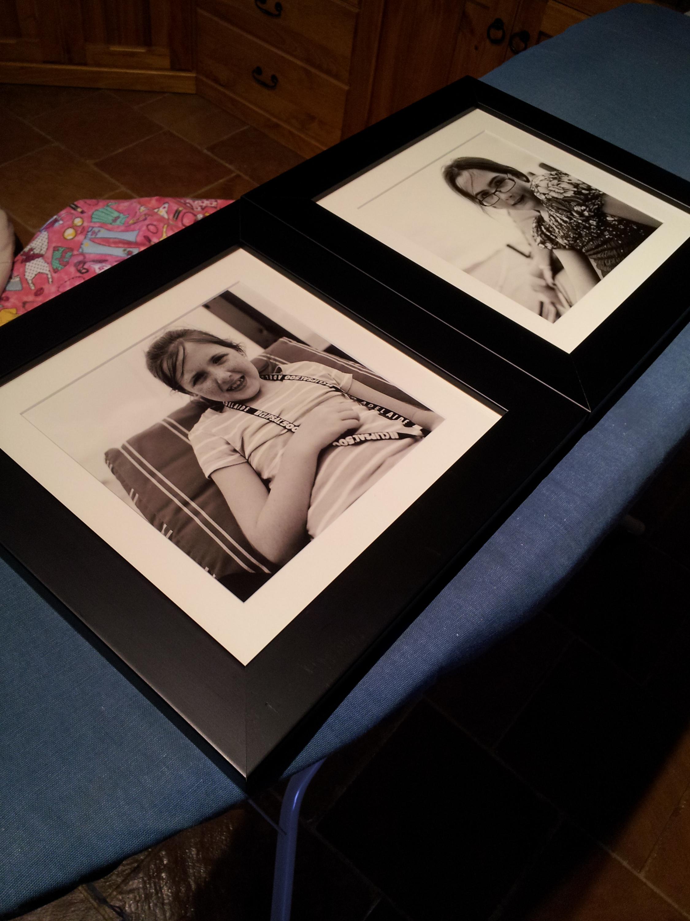

3 weekends ago, printed pics of my girls (2 negs, 4 prints of each)
2 weekends ago, toned and flattened (taping wet to a pane of glass)
Last weekend, matted and framed one set and matted only another set
All printed on Oriental FB warmtone, developed in Bromophen, toned in KRST
The results (Sorry for the crappy phone pic):
In hindsight, they are possibly a little darker then my (gasp) scans, but I am still happy (& so is my wife - the framed ones were for her! She started a new job and I wanted them for her office)
