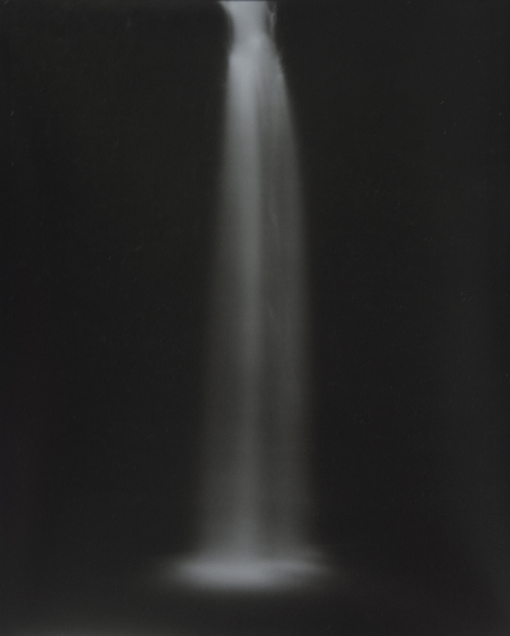

Horsetail Falls, Oregon
11x14 contact print on some old Ectalure
Sad thing it is that this was many months ago -- got to get a darkroom up and running!
