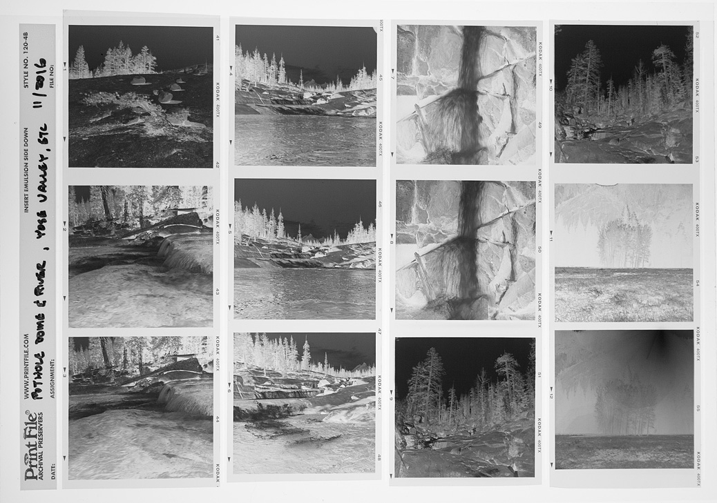

But now I have 6 new rolls of 120 (Tri-X and Acros from this weekend in Yosemite) and a backlog of too many 8x10 B&W architectural images to process in addition to my 4x5 Tech Pan! And far too many beautiful negatives, waiting in their sleeves, unprinted, and crying for attention! Such nasty First World problems...

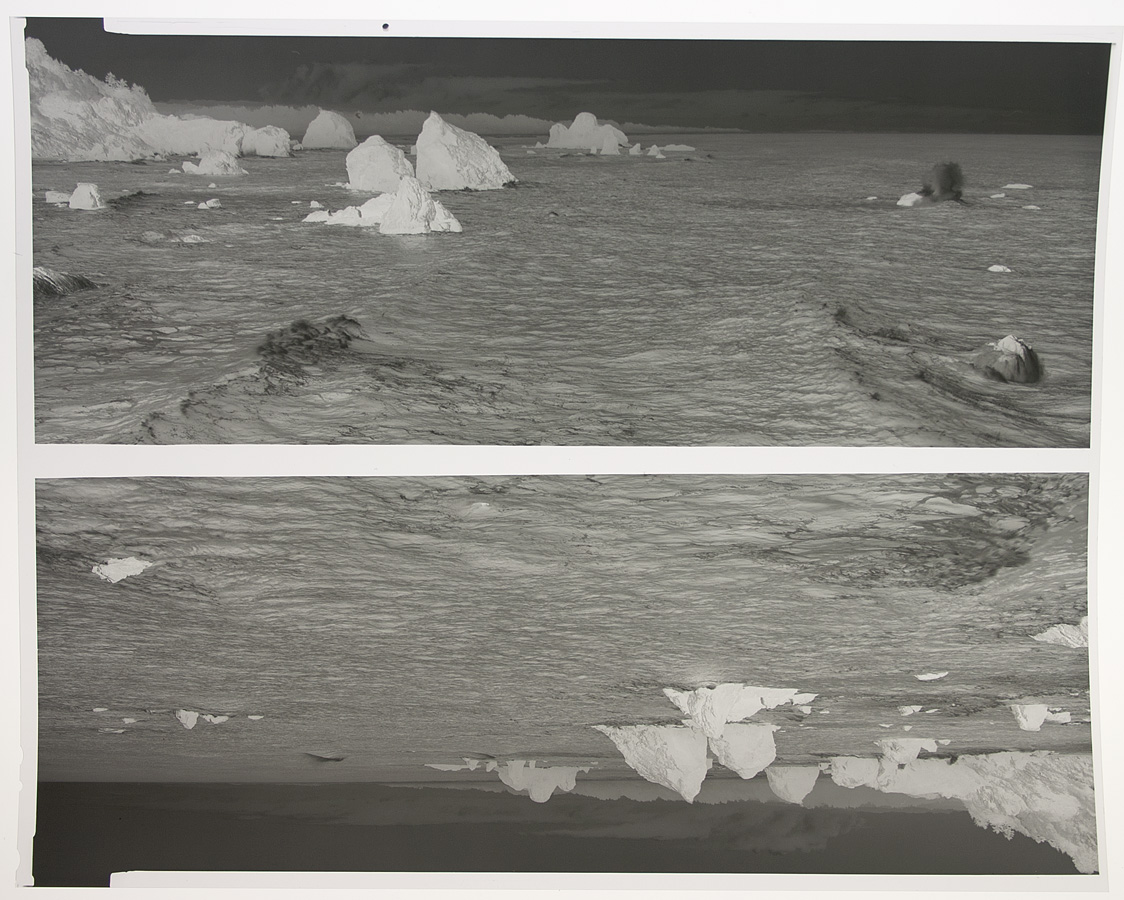

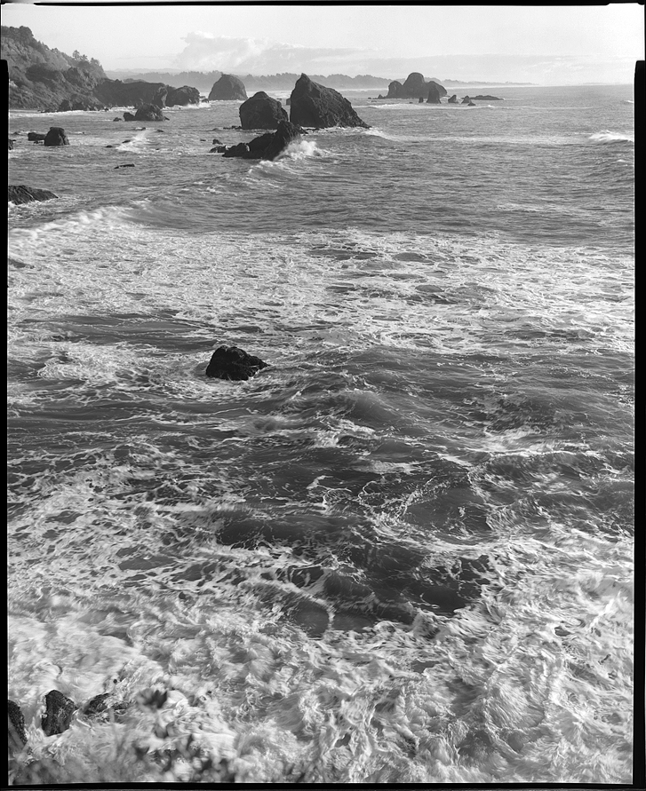

Silly me! I developed five 8x10 negatives...some architectural work of a home out in the woods. Got sort of excited about them, so I loaded another four negs from (I thought) same project. They ended up being some 8x10 and 4x10 images taken along the coast just as 2015 was ending. Nice surprise, but I would have given them a little bit more development if I had known. I just loading up another batch in the Jobo -- I think it is the rest of house images, but I won't be surprised of any more sea scenes sneak in! I'll develop them tomorrow when I have room on my drying wires (along with 4 rolls of 120 from a recent Sierra/Yosemite trip). Whatever the 8x10s end up being, it will be nice to have the rest of my 8x10 holders ready to be dusted out and filled with film! Nine holders already loaded with FP4+ and ready to go...eight to dust out and fill! One nice holder recently bit the dust and I might have a few more holders hiding somewhere, as I thought I had around 20...enough for a week trip.
Got 4 rolls of 120 400TX developed yesterday from my Veterans Weekend in and around Yosemite -- looking good! Time to cut them up and get them in the print files! I digitally copied one of the 8x10 images I develpoed two days ago and inverted it in PhotoShop...just to get an idea of what the image was like -- might make a platinum print of it, or one of its companion 4x10 of about the same image.
Edited to add an image of two 4x10s on an 8x10 sheet of film of the scene above. FP4+ in Ilford Universal PQ Developer (1:20) in an Expert drum (3005)...and an example of the 400TX in HC-110 (Dil.B)
