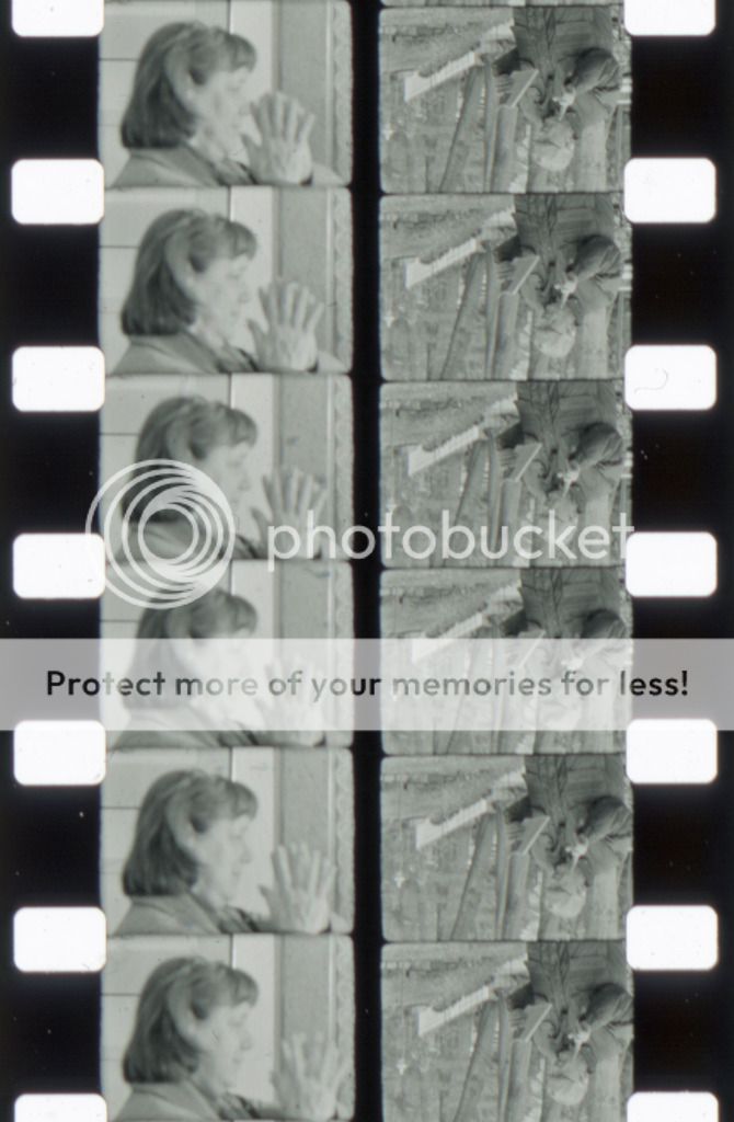

Regular 8mm Fomepan R100 movie film reversed.

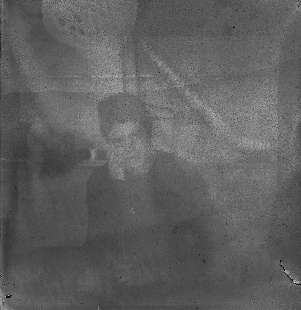

Old fogged Kodak paper cut square and loaded into a Richoflex VII. This is a scan of the negative.

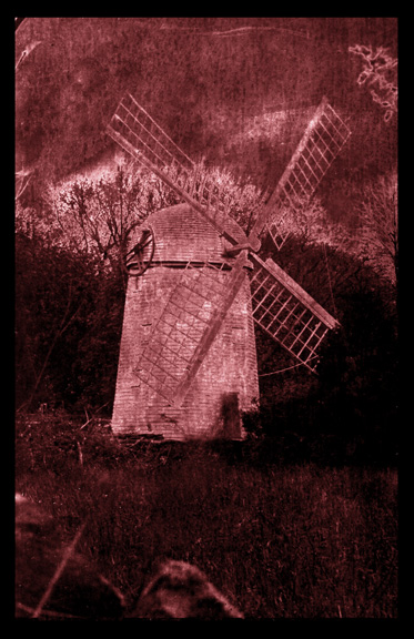

Today I am making a real salt print. What I mean is that I'm trying to make a nice print instead of just more tests. I was a bit shocked when I looked at my notes and realized that the last time I made one was in early September last year. That's when I ran out of my old batch of Lana Aquarelle and discovered that my big newer batch doesn't work. I've made over a hundred test prints since then, and am thoroughly tired of it. I've learned a huge amount, especially about arrowroot sizing, but 5 months is a long time without having a nice print in hand. Today I will print a calotype I made back in August, I've custom-cut a rubylith mask and will tone with gold-borax if it comes out well. This will be the first time I've printed a calotype using UVBL lamps instead of the sun, I hope that doesn't create some kind of karmic curse.... I'm so stubborn that if the print looks nice I'll probably make another copy when the sun comes out ( and I *know* the deepest darks will lock in better with a brief hit of real sunshine ).
Test strip and the first copy I've printed this century. Strangely enough the Neutol and Ilfospeed I've had since then still worked.

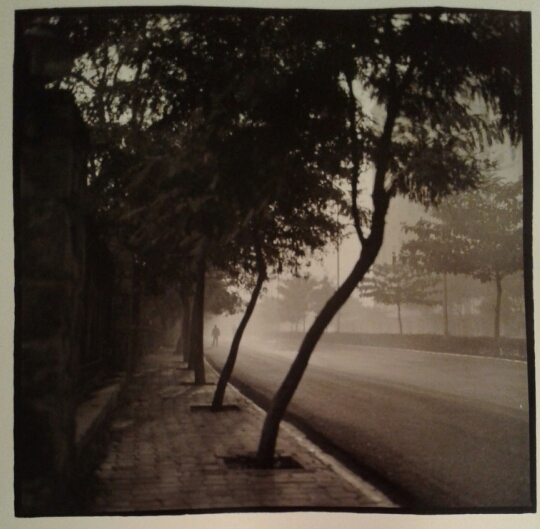

I'm just washing three snowy ladscape/abstract prints on Agfa MCC 1 (single weight!) from an equally old TMY 120 film. Very pleased with the result.

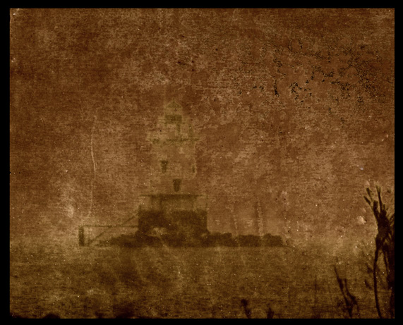

2 local relics made with a pair of xerox OHP negatives sheets of photo paper and 10? hours in the sun.
