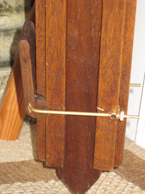

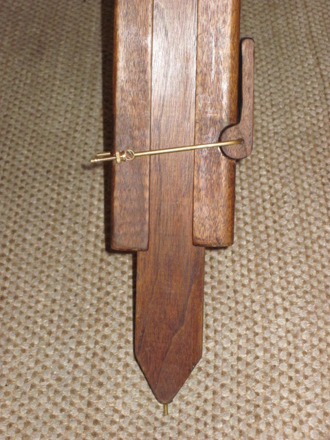

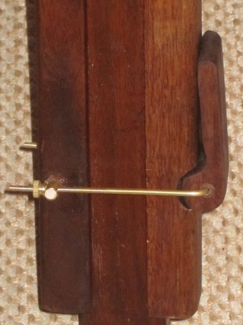

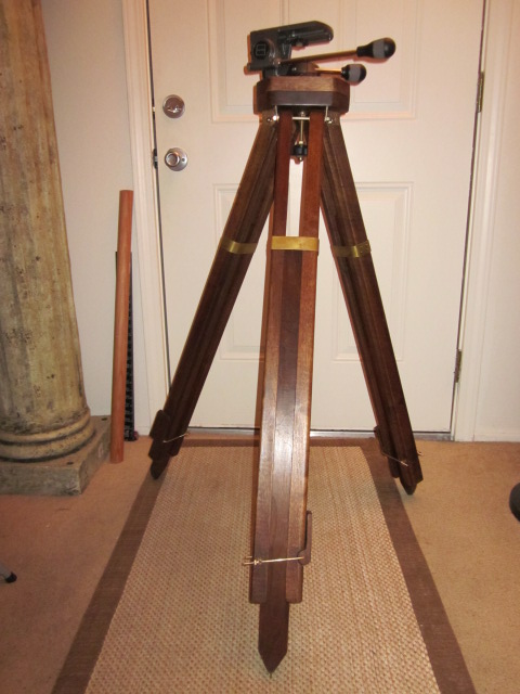

Today I rebuilt the leg locking device on my 11x14 & 14x17 Tripod. I designed a way to lock the legs initially that worked okay. When I was up in Yosemite last weekend I took out the 14x17 and needed to raise the tripod and one of the legs would not lock down. So, I made the cam-lock system for this tripod as well. I used this locking system on the tripod I built for the 8x20. It is a simple but very effective and relatively easy fix for the tripod. You can easily adjust the tension with the knurled nobs.
