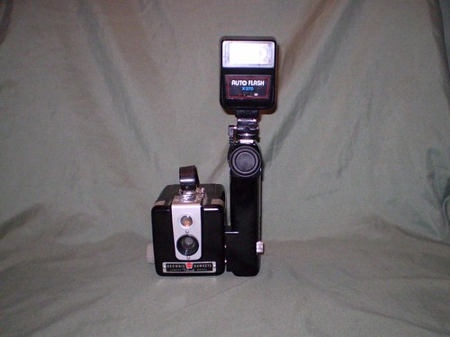

Not so much of a fix as I modified the flash for a Kodak Brownie Hawkeye Flash to use an electronic flash.
More at my Flickr page.
