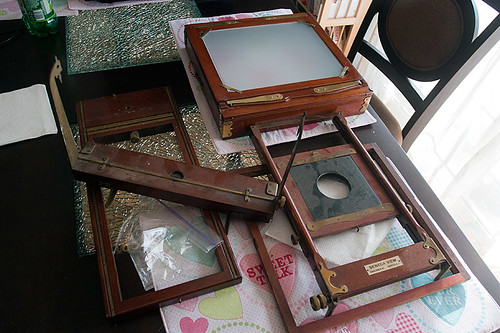

Last night I mounted my 24" Artar to its nine inch lens board for the 14x17. Before this I mounted the 24" Nikon to its nine inch lens board along with the Packard shutter. Now I just have to finish building the camera. Oh, I almost forgot mounted the aluminum barreled 19" Artar the other day to its six inch board. Going to use it on the 8x10, 11x14 and 14x17. Need to finish my reducing board tonight.

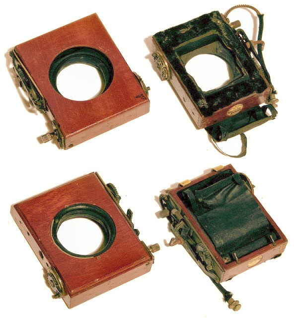

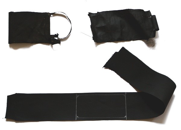

Made two new shutter curtains for a couple of nice Thornton Pickard shutters.
This curtain is for the shutter on the left which now just needs a new lens plate. Both have the speed indicator - as per my avatar :D

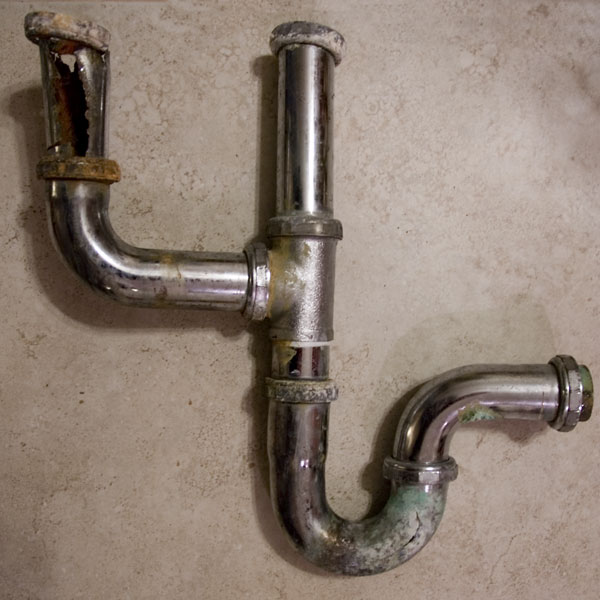

Ok, Ok, I know it's not a camera, but still a very important repair. I replaced the p-trap assembly on my friends darkroom which is where I print since I don't have a darkroom of my own. I'm amazed at how badly corroded the old p-trap assemble was, seems that the thin gauge brass didn't like the darkroom chemicals. I replaced everything with PVC hoping it will be more chemical resistant.
