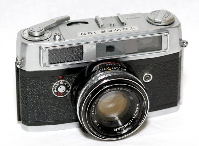

This weekend I finished up and processed the test roll from a Tower 18B (aka mamiya ruby) that had shutter issues I recently resolved.
A sample image (Fomapan classic 100 developed in XTOL)
and the camera:
