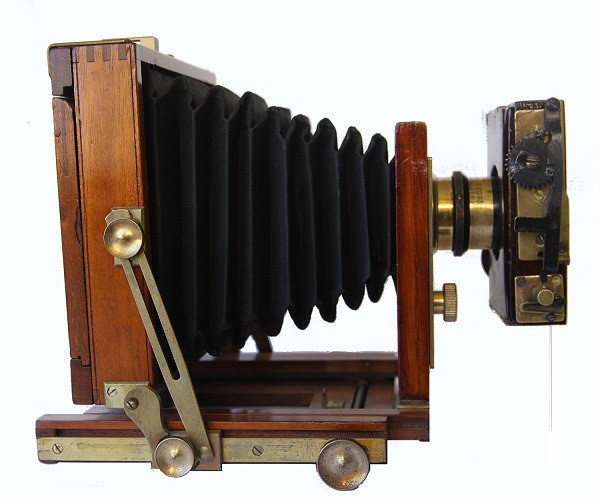

The Quarter plate camera finally now has a working roll film back adapter and a Thornton Pickard shutter for the original lens. The roll film back wascourtesy of WadeD. There's also a 150mm G Claren fitted to another newly made lens board board.
So off to meet up with other board members for a day outwith it for a trial run :D

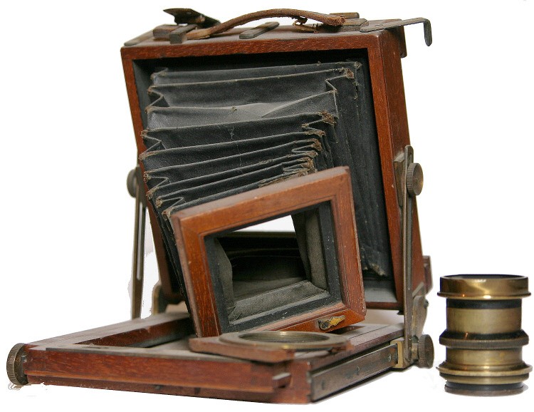

Made two lens boards for my Houghtons "Duchess" half plate camera, waiting a final French polish before one has a 1913 165mm f6.3 CZJ Tessar in early Compur fitted and the other a Thornton Pickard shutter which has an eraly Ross 8"x5" lens attached (it's marked by format not FL which is approx 12"/300mm).
