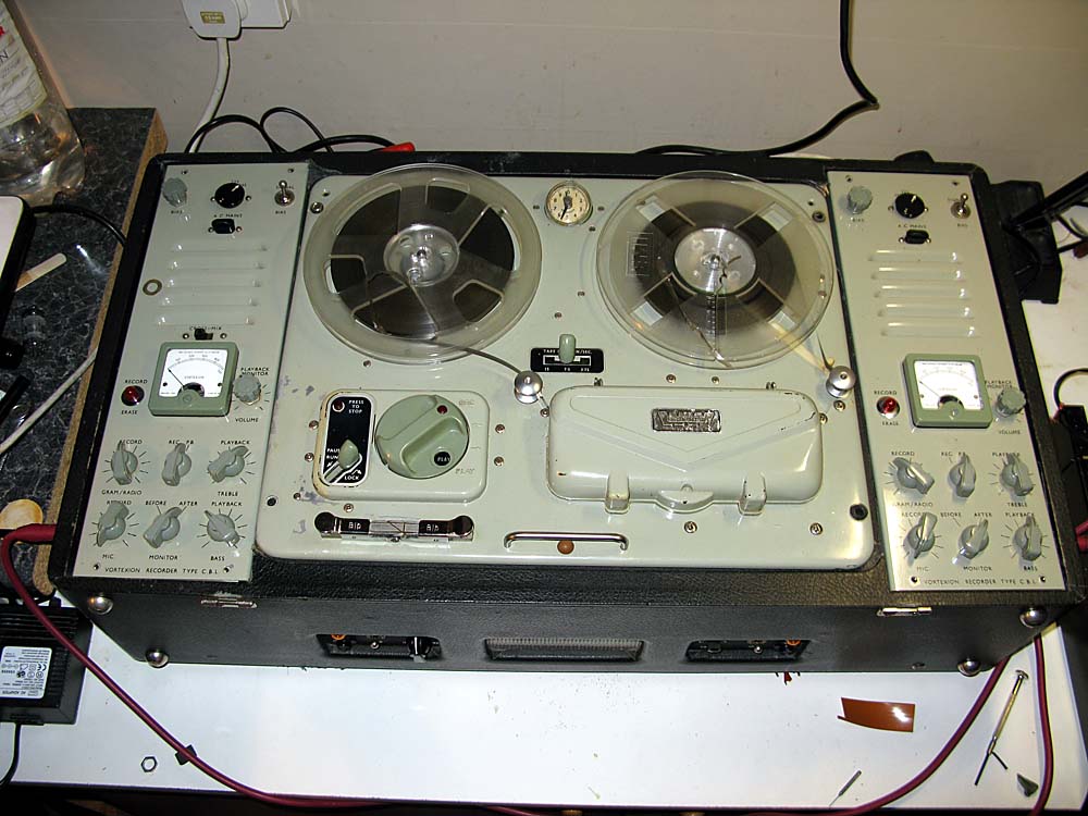

Finally got this working today:
Steve.

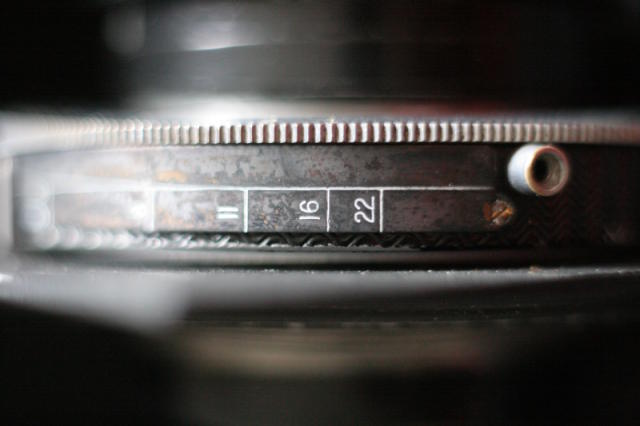

Took the F-stop scale off a 1950's Compur shutter as the numbers were difficult to see. Soaked the old paint off in thinners and cleaned out the crud in the engraved lines & numbers. Wiped some white enamel paint over to fill in the afore mentioned lines and numbers and left to dry. After giving the scale a quick rub down with very fine wet & dry, it got a 30 second dunk in KRST. Having giving it a thorough wash and left to dry, the KRST has turned the brass a satin black which sets off the white numbers quite nicely - Could probably do with a further treatment in KRST and a thin coat of lacquer..

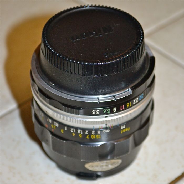

Not sure I would call it fixing, but I just did an Ai-ectomy (or would that be Non-Ai-ectomy?) to a Nikkor 55mm f3.5 macro lens. I finally found my fixture for holding the aperture ring, so that saved a lot of time, didn't have to remake that. Slapped it on the rotary table and knocked off about .068 and eyeballed the edge 1/3 of the way between f16 and f22. Lens meters closely with others on my F3 and now I can fit it on a D3100 to hopefully try d!qit1zing a huge collection of old family slides quickly (so tired of scanning at a snails pace). Now I'm set and practiced up to modify a Nikkor-S 50mm f1.4 that's still on it's way in the mail.
