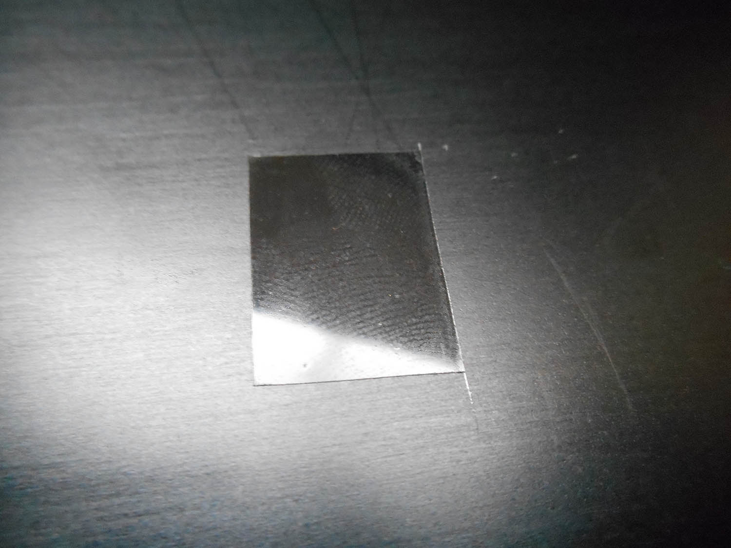

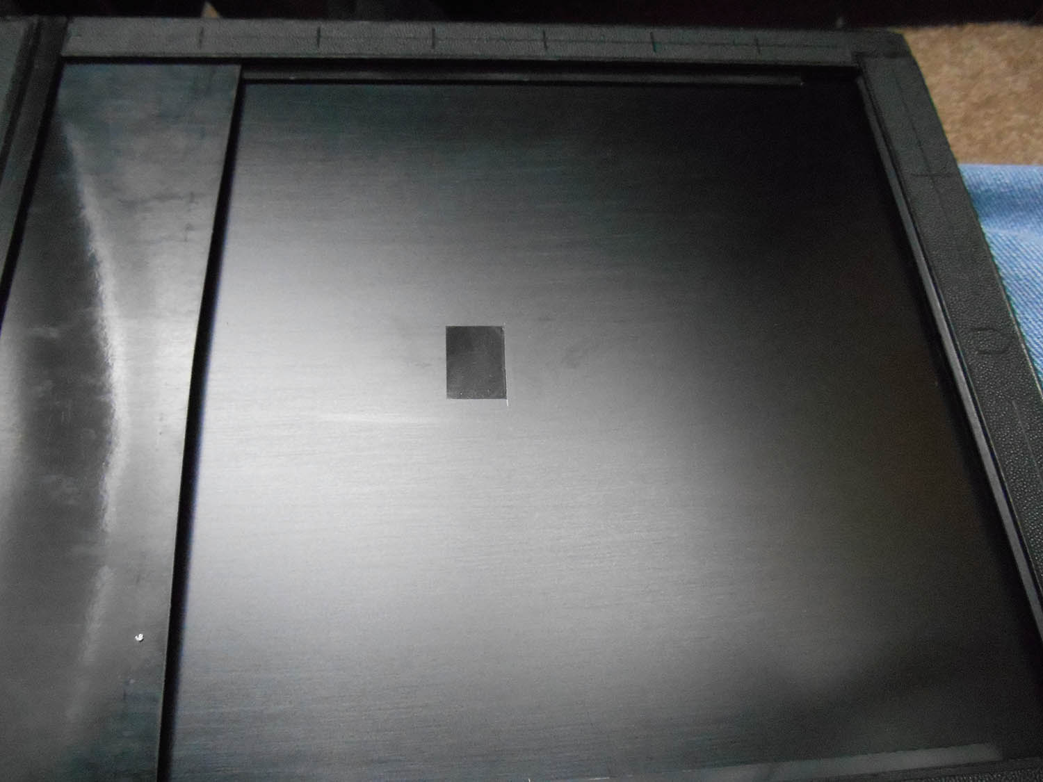

The two film holders I got so far, came with what looks like double sided sticky tape put in the center of the holder. I can see this would help make the film flatter when exposing, but getting the film out proved a real issue when I tried. One of the holders came with film in them, so when I tried pulling the film out, it was still stuck to the tape. Granted the tape isn't so bad it would never come off, but Im debating whether I should remove the tape. I don't want to be bending or wrestling with pulling back out the sheet of film while its in the dark bag. I threw out those two sheets of film I had in the holder.
So what do you think- should I remove the tape? At first I thought the holders came like this, but on inspection of a second holder, the tape was not all there.

Get rid of the tape. Tape is not a bad idea, but if the film is left in the holders for awhile, sticking and tape residue on the film is probable. I believe I used some acetone to dissolve the remaining adheshive.
I used a double-sided tape with a low-tack side I put towards the film. I was having 8x10 film shift and/or buckle during long exposures. This particular cure was not worth it.
OK. I had some Acetone and some Qtips, so I removed as much of the tape as I could and used acetone to clean it up with what remained.
The correct tape is a 3M ATG tape with permanent adhesive on one side but Post-It adhesive on the other side. I've used adhesive holders for over 30 yrs now with no problems. Haven't even had to change the adhesive, nor has any of it transferred onto the film. I've given details elsewhere. Look up Adhesive Filmholders. But you do need the correct tape or you will have problems. There is also a technique to applying it. The reward is significantly sharper prints if you make enlargements. I wouldn't worry about contact prints or just a modest amount of enlargement.
No. That's the wrong tape. You want 3M no. 928, preferably one of the wider sizes. Holders have to be modified by removing the retainer fins to allow the film to drop down and rest on the adhesive rather than sliding in behind the fins. Try to acquire an expendable Lisco or Fidelity plastic holder to practice on. The fins are easily removed with a steel straightedge and sharp box knife. Of course, once you've altered a holder, there's no going back. The tape needs to be rubbed down firmly and very evenly before removing the top liner. If you goof that up you can peel it away with a plastic putty knife along with acetone. Don't get any acetone on the plastic parts of the holder, but the aluminum septum in the middle will be unaffected. Most of the septum should be coated with tape oriented vertically, not just a spot in the middle. Do not let the tape strips overlap.
