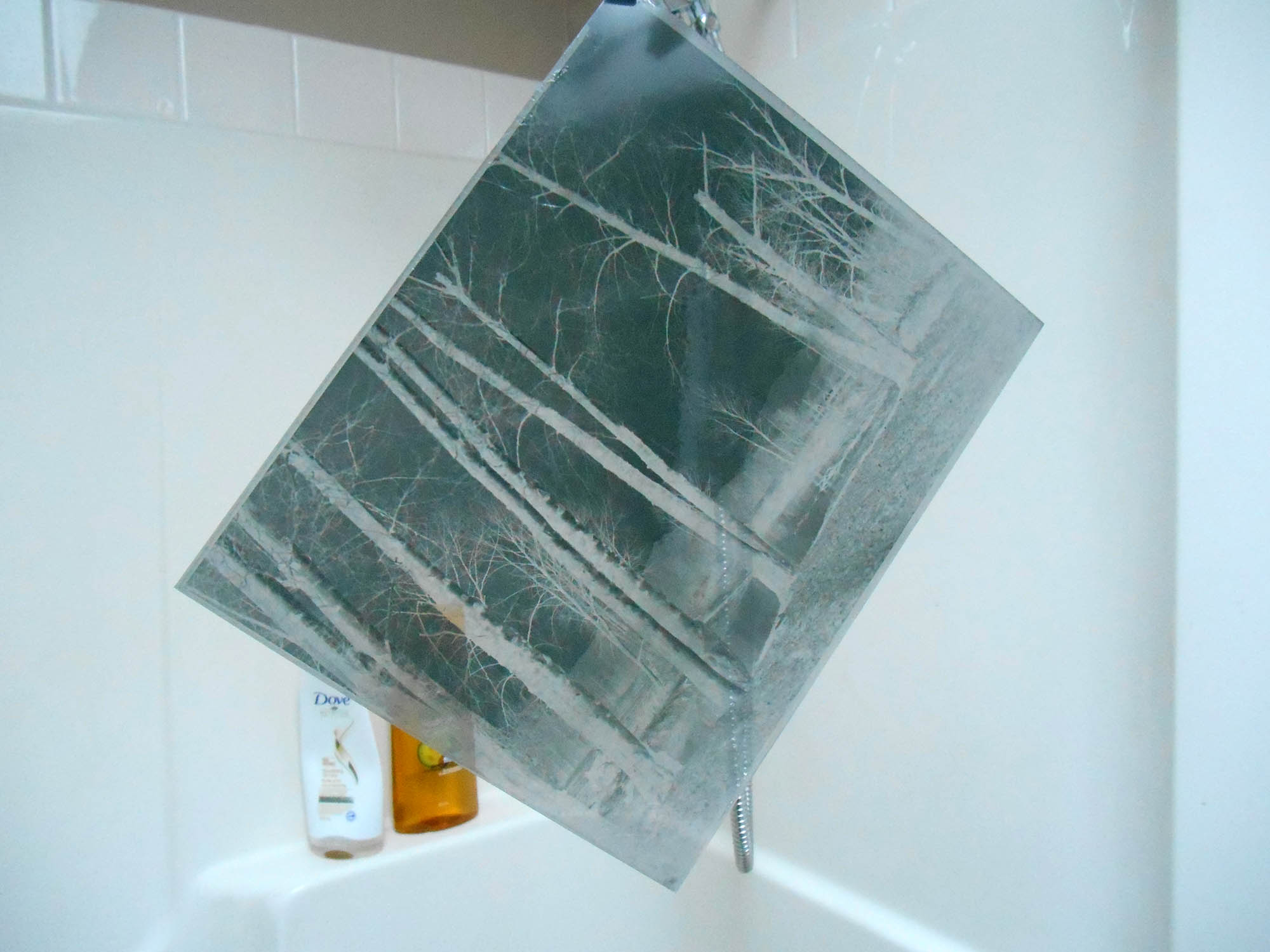

Well I shot my first 2 sheets on the camera today. The lensboard I bought wasn’t fitting into the camera properly. I'll have to get some wood shaved off it to fit. I had the board that was given to me with a modified adapter, so I used my Fujinon 210mm 5.6 lens which is wide angle. Took my two shots. The rail wasn't rolling too well when I tried to bundle it all back up.
Nice shot. Congrats. How does the Dove developer work out? I bet it's better than that smelly stuff Kodak sells.
