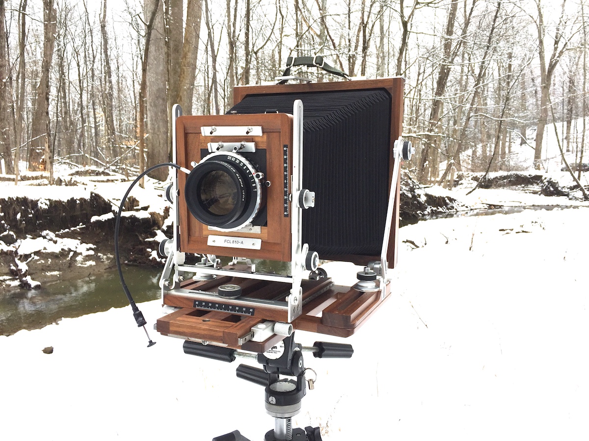

Well my 300mm f5.6 Fujinon lens came yesterday.
Fujinon 300mm 5.6 is my go-to lens recently. It is a little on the big side, but I only carry one lens at a time. I have a lot of 8x10 lenses. You may get others lenses too. But one could also have an entire 8x10 photographic career with that lens.
(Oh, I see you have the "L" lens. I have never owned that one, but I'm sure others can chime in with their experience with that lens.)
The same lens as ic-racer shows has been my go-to lens for 8x10 for a long time...my only 8x10 lens for the first 15 or so years. A FujiW 250/6.7 is seeing almost equal use these days. I got use to the size of the 300/5.6 when my back was 25 years younger...but I did notice the jump to the FujiW 360 -- it would look pretty sweet on that camera above!
If I take the 360mm, I leave the 300mm behind and keep the little 250/6.7 in the pack.

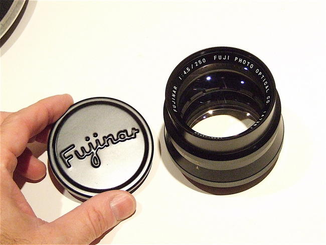

Those L series are tessar type with smaller image circles, maybe like the older Fujinar tessar lenses. I have a Fujinar tessar lens, but have only used it for enlarging with it stopped down where it is extremely sharp, so can't comment on how it renders images on film, though I have wanted to try it to see.
