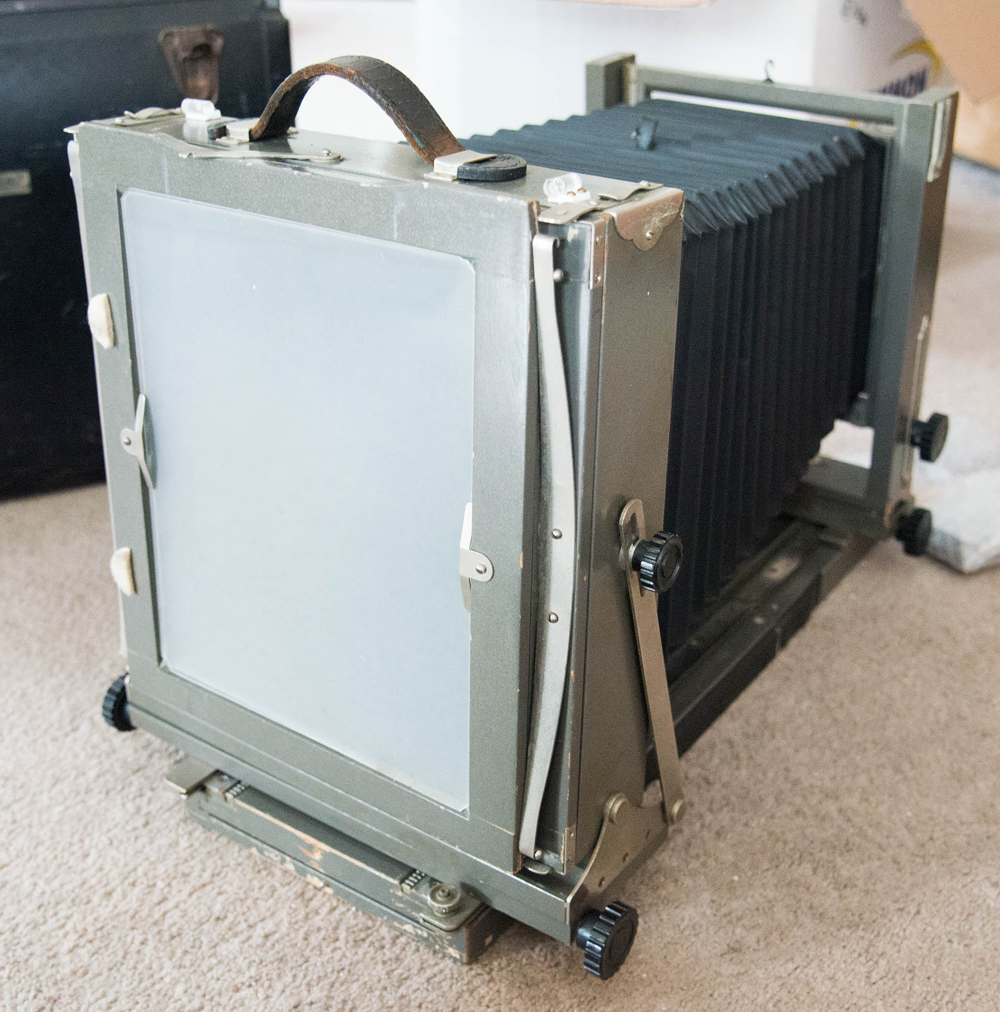

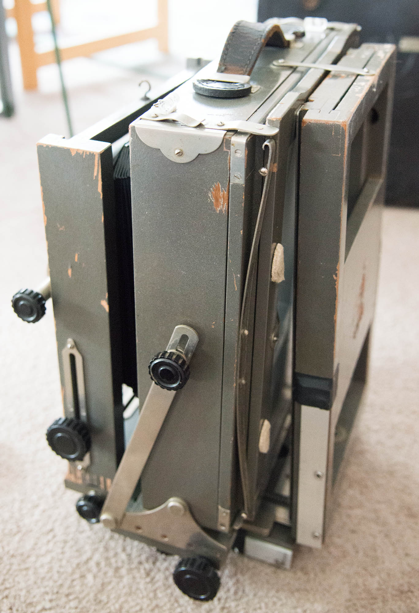

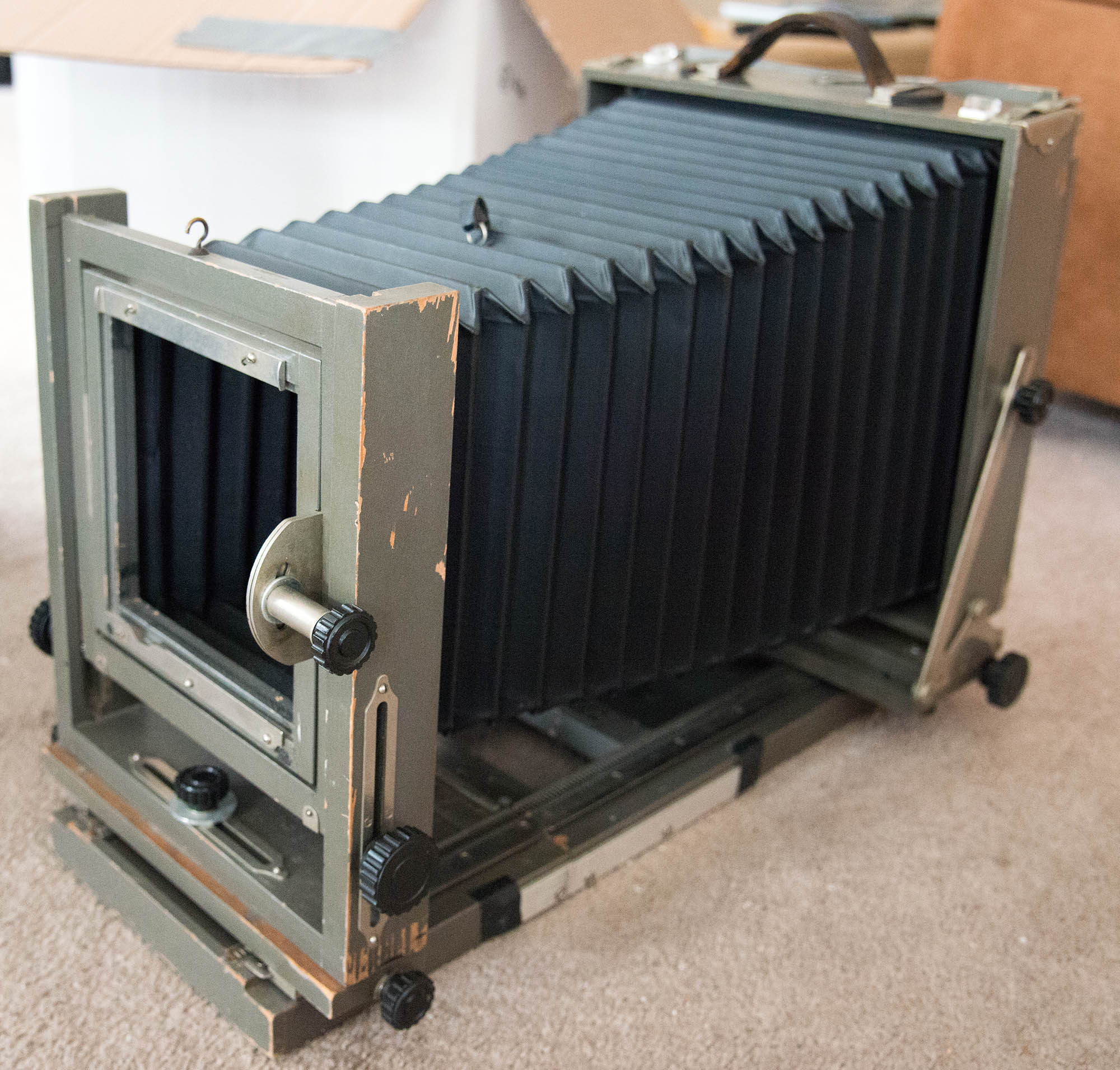

I received the camera today! It came in undamaged condition and it all looks as it should. Next step is to get the 5x7 back next month. Then later the accessories needed.

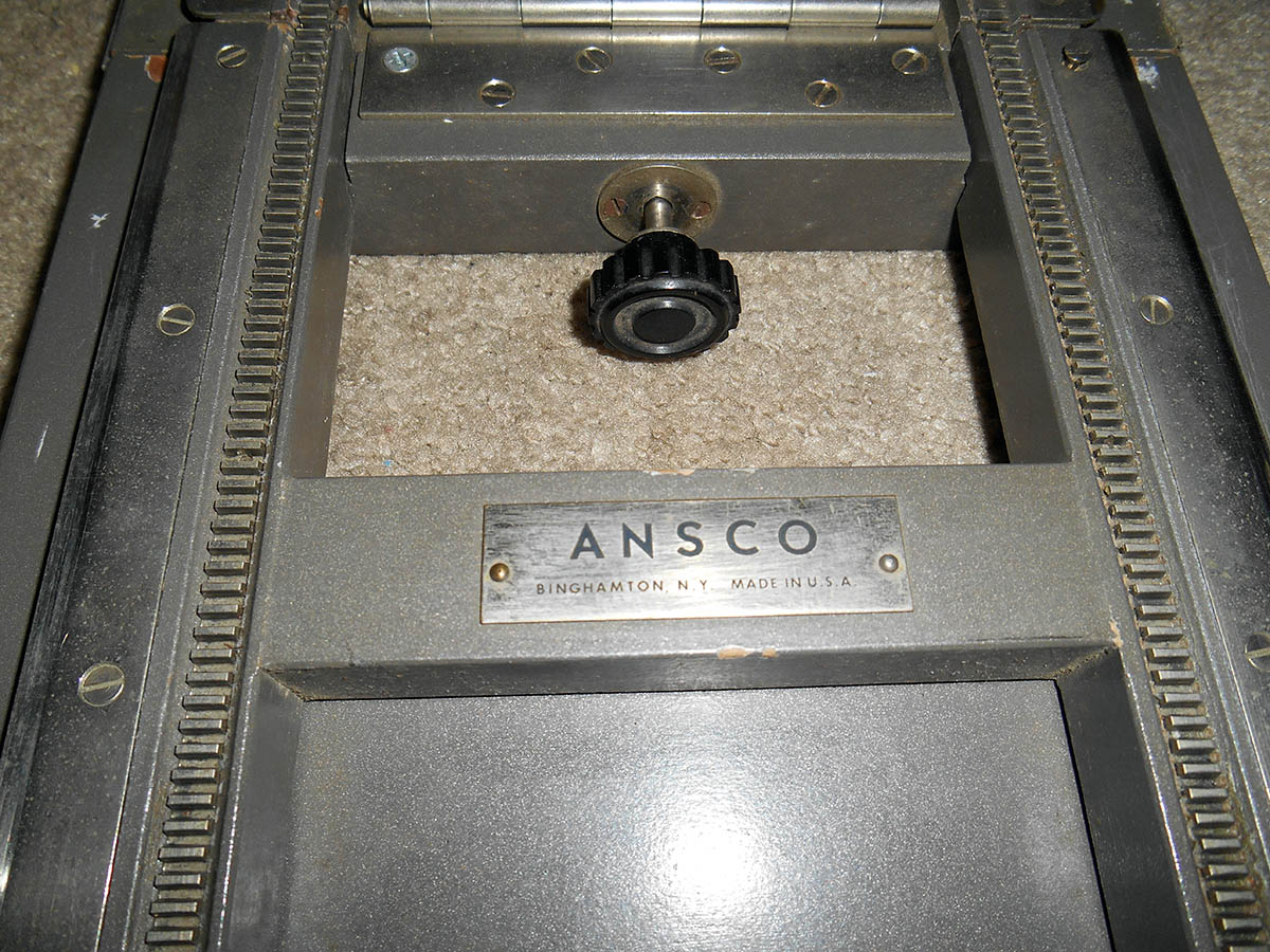

I have a question after receiving this camera. For the life of me, I can't see a serial number anywhere stamped on this thing. Where is it supposed to be? The metal Ansco plate on the bed platform doesn't have a number on it, so I am at a loss where else it would be.
I think I found the number. It was hiding under the rear sliding rail, next to the hinge. Its a really low number (*79). I find it hard to believe they only made a few hundred of the USA version.
