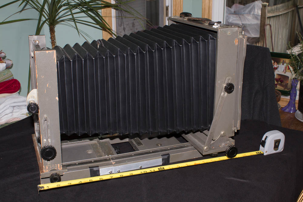

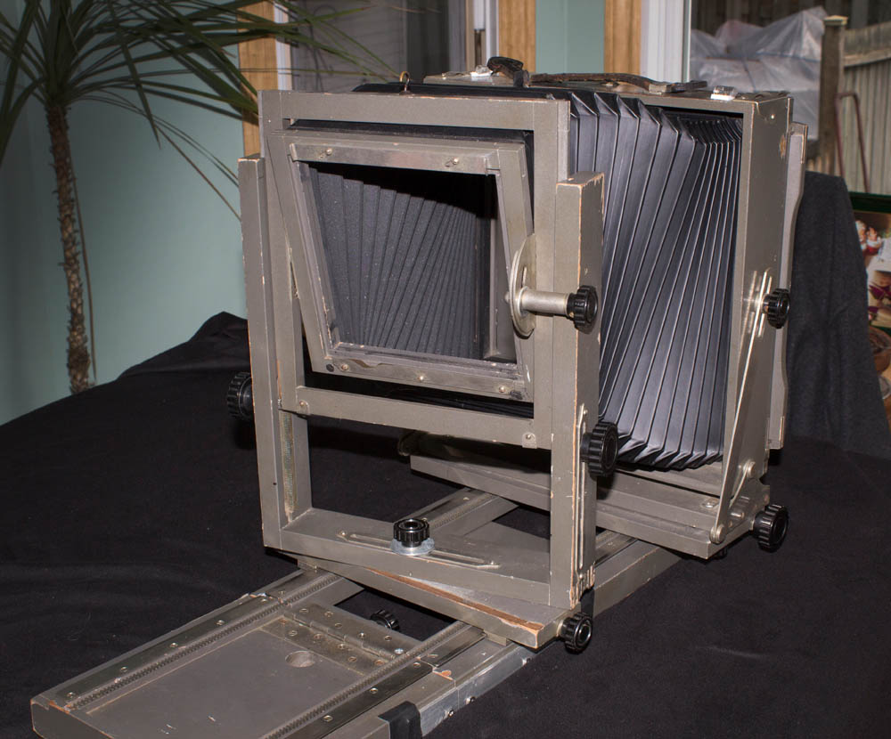

I've made a deal with someone for an inexpensive Agfa Ansco 8x10. Comes with a 5x7 back too and possibly a lens too. I still need to get the small stuff.
Let us see te camera when you have it. I have 2 Agfa Ansco 10x8 a Commervial View and a Universal View, the latter is a cheaper version no extension rail no front tilt (some have), no front focus.
They don't usually have front swing, this Commercial View was a feature requested by the original owner, be aware that the far left bottom thumb screw allows additional extension, and is on the Commercial and Universal..
Ian
That's an Ansco camera made after the US Government took over Agfa Ansco and moved LF camera production from Bingham. The cameras were redesigned so features differ from earlier Agfa cameras, still a good camera tough so have fun with it :D
Ian
