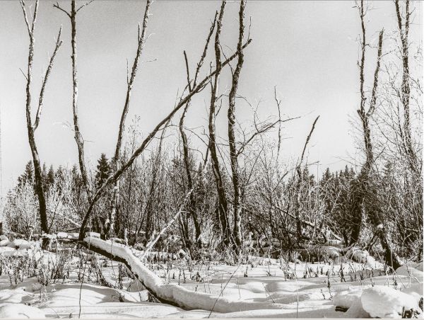

Check out this gallery on my website most of them are Classic FB paper with various toner combinations. If you see something that looks like what you are going for I can tell you how I toned it.
Anthony, I had a look at your nice website and think that the look of this image would work for my prints. Although I am planning to use it for a warmer scene. I'm definitely not a winter person. :D
Can you share the magic behind this print? Thanks in advance.
adelorenzo
Mar 10, 2012
1,420
Whitehorse, Yukon
That is the Ilford IT-8 Pyrocatechin toner formula that Ian Grant posted earlier in the thread. (The formula is also in the Darkroom Cookbook.)
You bleach in dichromate bleach and then redevelop in a pyro developer. You get nice brown tones in the shadows and midtones, the highlights are less affected.
This will also affect how the paper responds to other toners if you follow it with sepia or selenium you will get a different result than just toning a straight print.

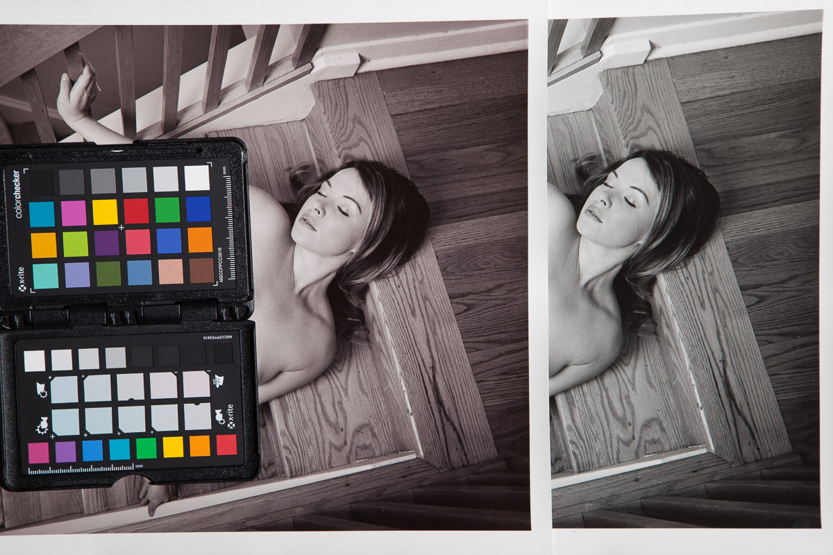

I did some more experimenting with toning Ilford FB Classic (neutral) as I found a half full bottle of Agfa New Viradon toner. This is a polysulfide toner that can be used as a direct toner (without bleaching first). I made a working solution of 1+39 and toned some test strips. As I expected, the toning start at the high lights and as time progresses it gets into the darker tones. In the end, I toned one print for 5 min. This print was previously developed in Eco Pro paper developer, stop, fixed and washed without the use of wash aid. This is recommended in the book Way Beyond Monochrome 2nd edition on page 504 in a side note to the Polysulfide Toner Formula.
Here is a photo of the toned and untoned print. The toned print is not bad. However, I would prefer a more subtle toning of mainly the dark tones and less in the highlights. Like a warm tone paper after selenium toning. Also the brown is a bit purplish so colour wise not the greatest to my taste. Plus the Viradon is really stinky so toning indoors isn't fun. :sick: And at -15 C, outdoor toning wouldn't be fun either.
I might try the Ilford IT-8 Pyrocatechin toner next as adelorenzo suggested. @adelorenzo ; what do you use for the Hydrochloric Acid? I can get this at Canadian Tire. If I diluted that further down from 31.45% to 10% for Stock B, would that work?

Why is it that a warmtone paper like Fomatone responds so aggressively to toning while Ilford Multigrade does not? Its all just silver by this point isn't it? I've toned a print on Fomatone in Selenium 1:10 and within only a few second it had gone from its usual cream colour to an almost copper tint. The Multigrade on the other hand only shifts a little bit from greenish to purple'ish (to my eye).
Untoned Multigrade on the left, toned Fomatone on the right. It is a little more reddish to the eye very much like aged copper. Its not actually HCA in that tray, just clean water.
Untoned Multigrade on the left, toned on the right.
