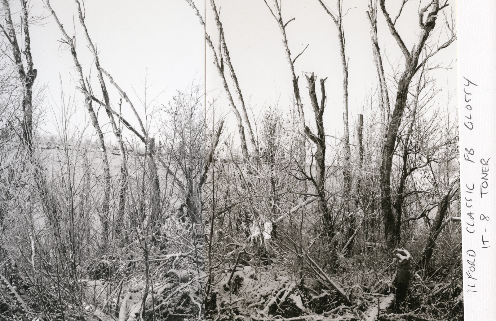

I finally ran my tests based on the tonality Adelorenzo images above. Processed MGFB Classic Glossy in Ansco 130, +stop+Ilford rapid fix and let it dry for a few days. I cut two images in half , one with low contrast and another with high contrast.
Bleached using aged Bromoil bleach which contains Potasium Dicromate, Copper Sulfate, and Potassium Bromide. The image bleached fully as usual except for the deepest tones and they went to a medium brown. Washed after bleaching for about 5 minutes.
I then prepared Pyrocat M 10A:10B:1000W at 75*. Pyrocat M has a small amount of Metol(2.5g/liter) and is mostly Catchetol (50g/Liter).
I put the bleached and washed halves into the developer. After a couple of minutes the dark tones came back but the middle tones and highlights were a muddy gray bleached blah tone.
I left it the developer for a full 15 minutes before the highlights came back. I probably had too dilute a developer but I was only working with 2 halves of an 8x10.
Lo and behold my results are similar to Adelorenzo - A shift to a nice warm rich tone yet not really brown like you get with thiourea, with light staining in white areas. Most noticeable in mid tones and dark tones.
I will scan and post photos when dry.

This is my latest attempt using a Pot-Ferri bleach on a low contrast image until all but the darkest shades are gone, redeveloped using Pyrocat M 5:5:500 for about 5 minutes. On Ilford MGFB Classic Glossy.
The scanner is picking up more color separation than I see in normal room light but i adjusted somewhat so you could see the staining of the paper on the right edges and still be close to the actual color effect.
It is warmer toward brown - olive, but not as strong a color shift as Thiourea 40T/60H would be. On a darker image it an even look a little richer brown.
