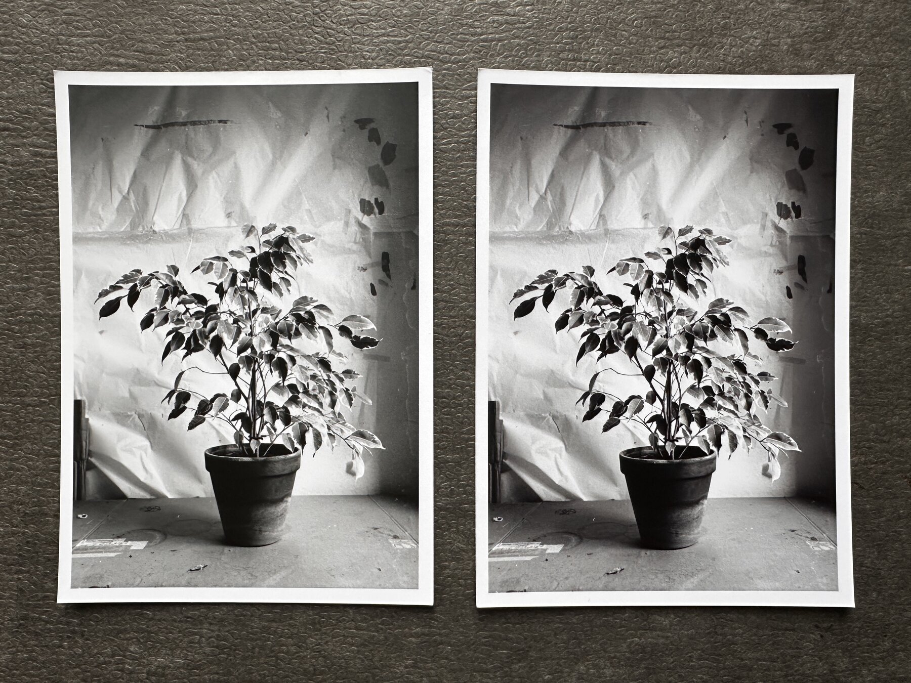

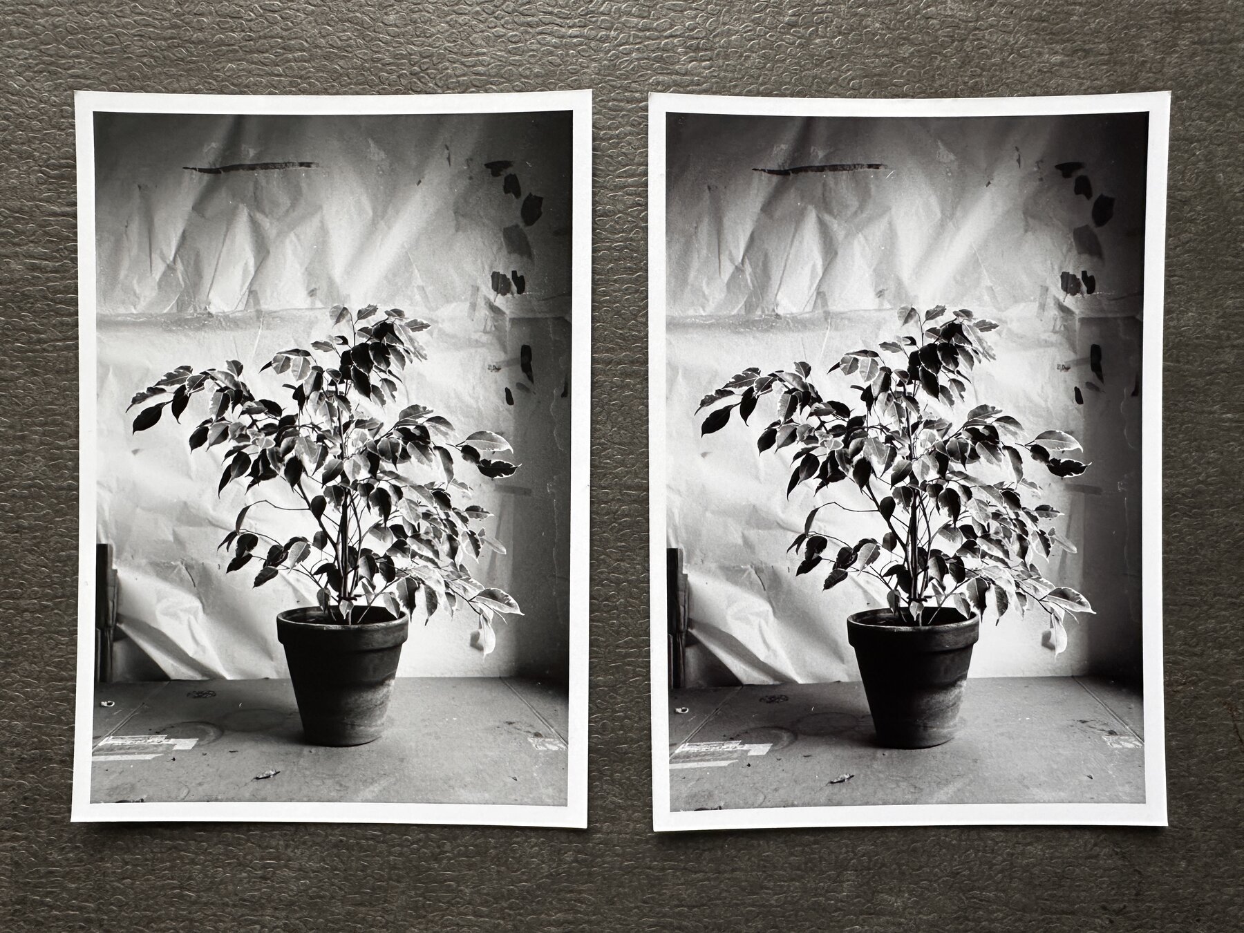

Before all the shops here raised their prices after Ilford's recent price hike (raising 20-25% here in Germany) I got packets of the MGRC in glossy, satin, and pearl - and just toned them using Kodak's Rapid Selenium Toner (1:19, for five minutes) the other day.
..you can't really see the difference between the three finishes well in those pics - posting them here to show that, to my eyes, all three tone very much the same 🙃

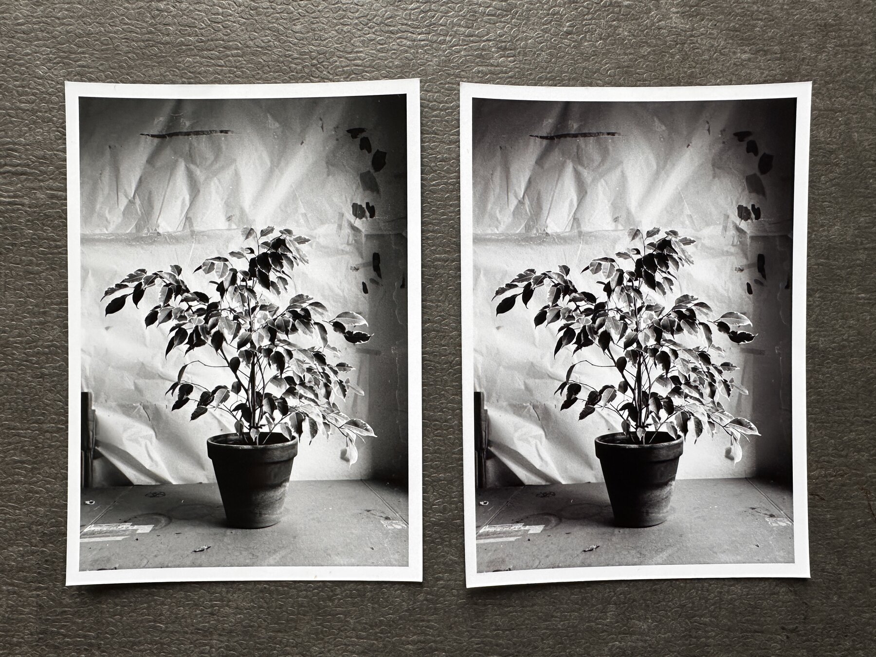

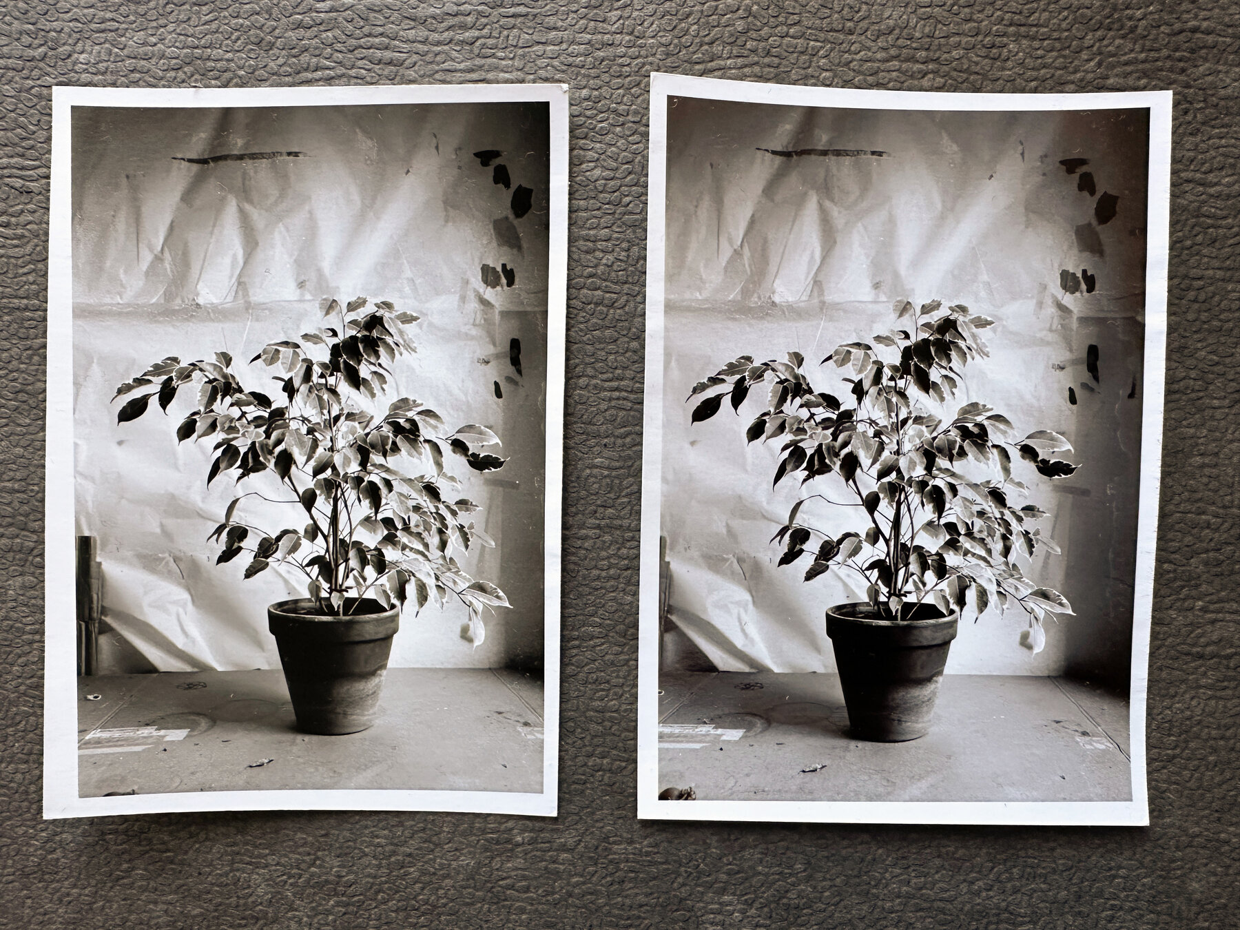

And here's the same negative, printed on Ilford FB warmtone (bit of a skewed comparison I know, alas the warmtone is the only fiber based paper I have right now).
Also in KRST 1:19 for 5 mins -
Pardon the wonky borders (and wonky prints in general), but those are literally my first FB prints ever, and I'm having a hell of a time having the (badly curved) paper lay flat in my easel (and of course dry flat) 😀 ..more to the point though - you can see that the selenium toning is comparable to that of the RC paper, in regards to color shift and dmax increase.
As a sidenote the FB was printed with exactly double the time, and half a grade higher than the RC (so 7 seconds with a MG3 filter, instead of 3.5s with a 2.5)
I think they're lovely!
It might be the image or it might be that I'm more sensitive to what selenium toner does, but I see a distinct difference between the warmtone print that's selenium-toned, and the RC prints with the same toning. The warmtone has toned considerably more, which is also to be expected.
