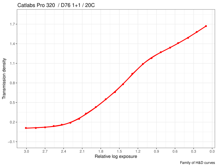

Okay, to bring this thread back to its original topic (I apologize for my earlier departure), I have a first curve with, what seems to be, the right amount of exposure. The toe is what I intended, which means the first two steps of the step tablet are B+F density, and then it starts climbing. This was 8 minutes in D76 (Kodak) 1+1 at 20C in a rotary processor. This is just raw data, no analysis, yet. This is it from me for now. More, hopefully, next weekend.
You're a champ. And is your estimated film speed still ~80?

You probably did not read this thread, including my earlier posts regarding film testing. You would know that this is the first curve in a series (of five). In a conventional film test, the choice of developing time is, mostly, arbitrary. You want to have a decent spread, say, from around 4 minutes to maybe 16 or 20 (for D76 1+1, anyway), depending on the film, developer, temperature, agitation, etc. The point of the test is to arrive at a series, a progression if you will, which will allow the photographer to choose whichever time they prefer for whatever purpose (e.g., to pull, push, etc.). The data will indicate which time will do what to the film curve, and, thus to the negative, without much guesswork. Tone reproduction analysis, which will follow, includes the final print.
Also, if this film is underdeveloped, as you say, then the "correct" development time will likely produce a challenging negative. This one, I am guessing (I have not yet done the analysis) has the Contrast Index well above 0.6, which is already, for most people with a condenser enlarger, not ideal, at least for a conventional silver gelatin print. Twenty percent more development is likely to push CI to well over 0.7, and that would be hard to print, even on grade 1. It would also be hard to scan because the highlights would likely contain very little information (I am talking about a typical outdoor scene, with a typical luminance range). It might be the "right" time if one wishes to push-process the film, or for negatives containing a low-contrast scene. I am guessing you're also talking about a typical scene, though, yes?
Based on this graph, the CI between zones 2 and 8 is about 0.71, so it appears that the roll was overdeveloped, because ISO CI is 0.58 (IIRC). Interpolation of CI-values suggests that 6.5 minutes will yield a CI close to 0.58.
Also, I presume your step-tablet has 0.15 steps, but the red dots in the graph are spaced slightly closer together. Any idea why?
Also, I presume your table has 0.15 steps, but the red dots in the graph are spaced slightly closer together. Any idea why?
Thank you!
The step tablet is not perfectly linear, so they dots are not spaced exactly .15 apart, and the densitometer has some inherent error. Once the analysis is done, the cruves will be modeled statistically and all those non-linearities will be accounted for.

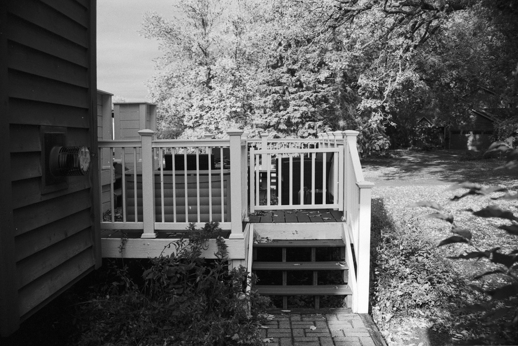

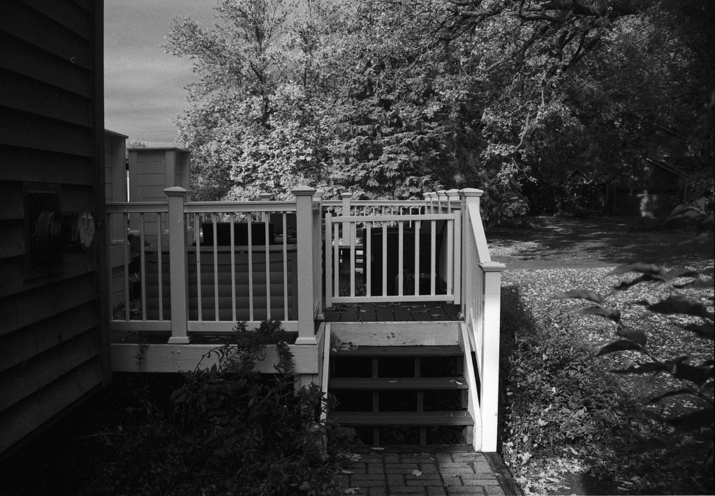

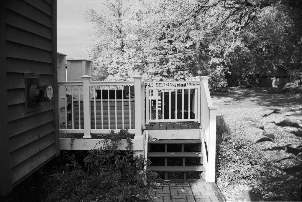

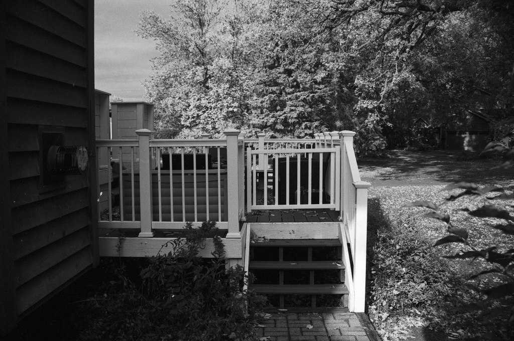

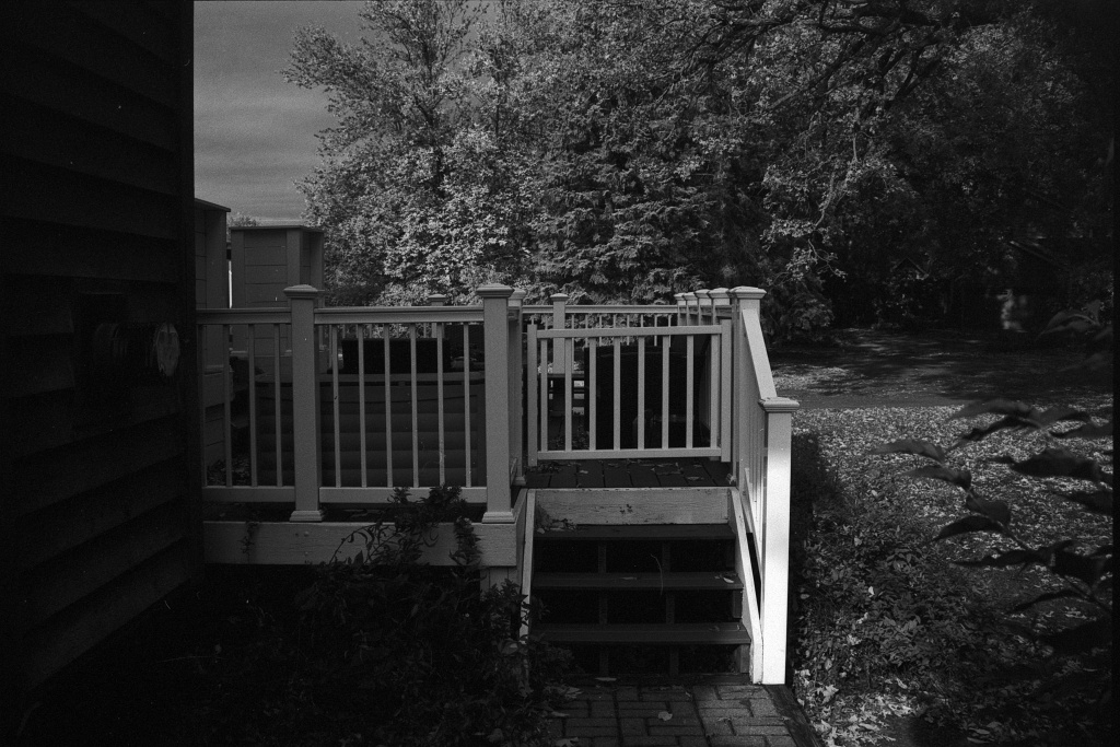

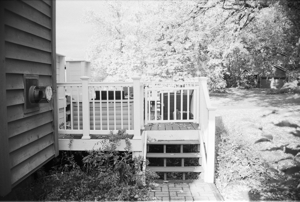

Well, I did my version of a film test yesterday. I divided up a 35mm roll into three cannisters and shot one roll using the method of determining ISO in the John Finch video linked to earlier. But I don't have any paper on hand to run that test so that will have to wait. Then I shot a sequence of what I thought would be a wide range of light values in one image. It was a lightly overcast day with occasional moments of direct sunlight. The scene is on the shaded side of the house with the post at the bottom of the stair in direct sunlight. All photos were taken while the sun was shining directly on the stair post.
I set my ISO manually to 200 based on the recommendation in the box label for use with HC110 and used the compensation dial on my Pentax ZX5n to go from a -.5 to a +3 in half stop increments as shown in the photos below. The Pentax was set for matrix metering. I developed the film in HC110 for 10.5 minutes as recommended.
Notable colors in the scene: The sky is lightly overcast, so mostly white. The house is a medium blue. The house across the street is a dark brown. The tree on the left has turned a bright yellow. The chair behind the railing gate is dark brown, with a woven texture that is visible starting with the 200 ISO setting. The railing is a smooth white pvc plastic.
I scanned the negatives on an Epson v850 with no adjustments. I find I like the moodiness of the 200 ISO shot, but the 200 +.5 is probably most accurate. The longer exposures have blown out highlights and darker elements such as the house across the street are too light. Of course, everyone's monitor is different, so you may come to a different conclusion. In fact, now when I view these on my phone, I would choose the 100 and 100 +.5.
After reading what Matt wrote about more exposure and less development, and watching the second John Finch video, I wish I had also shot the last third of a roll and developed with a shorter time.
ISO 200 -.5
ISO 200
ISO 200 +.5
ISO 100
ISO 100 +.5
ISO 50
ISO 50 +.5
ISO 25
