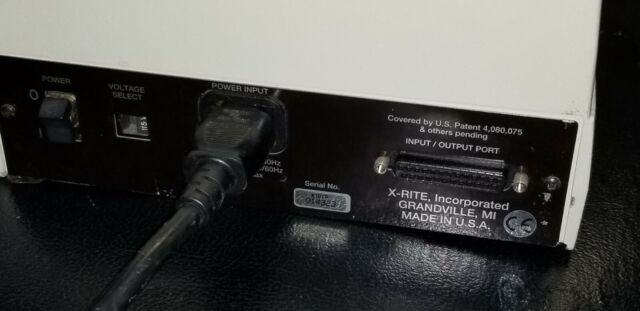

Wow. I think I've seen one of those on eBay some time ago. Mine (X-Rite 810) has what looks like an old serial port connector at the back, but I doubt I could connect it to a modern PC.
Actually you can connect a serial cable to any modern PC. You must buy a serial-to-USB adapter for 10-20 USD, and then your X-Rite should be able to squirt measurements directly into a text-file or spreadsheet.
Here are the adapters available on Amazon.
Awesome! Are you familiar with this connector form factor? It is larger than the standard PC serial port, or am I misremembering?
I appreciate all your replies. One thing we should remember is that we are all viewing and rating photos on this website based on what we see on our monitors, phones or tablets. I have my laptop hooked up to an external monitor and usually view this site on it. But if I view my test photos on my laptop screen, my preferred exposures would be a full stop slower, and a couple of people have also noted the same exposure. But the detail is in the scan regardless of how our screen displays it. The only way to positively agree on an exposure is to be in the same room looking at a print under the same lighting.
Given today's scanning technology and software, I could have adjusted any of the photos in my test to produce an acceptable image, and I think that's what most young photographers expect to do these days. So having an exact ISO evaluation isn't as important.
Wow! That's a blast from the past! Assuming that's RS-232 (serial), you can buy an adapter to convert this ancient large connector to a modern small one. Here's an example.
Fantastic. You are right. I just confirmed it by opening up the manual, which has been sitting on the shelf all along. So all I need is a RS-232 to serial cable plus a serial-to-USB adapter, yes? I owe you one. This is going to simplify things a lot. Thanks!
It's not entirely true, but for most people, RS-232 is a synonym of serial. Around 1980, serial devices used that big connector, and later, folks switched to the smaller connector. So that 25-to-9 cable plus a serial-to-usb adapter should get the data across, relegating your fountain pen to the display case. But I suggest reading whatever the manual says about serial-transfer to see whether X-Rite put any gotchas in there. It should also specify baud rate, data bits, and parity-bit settings to use.
