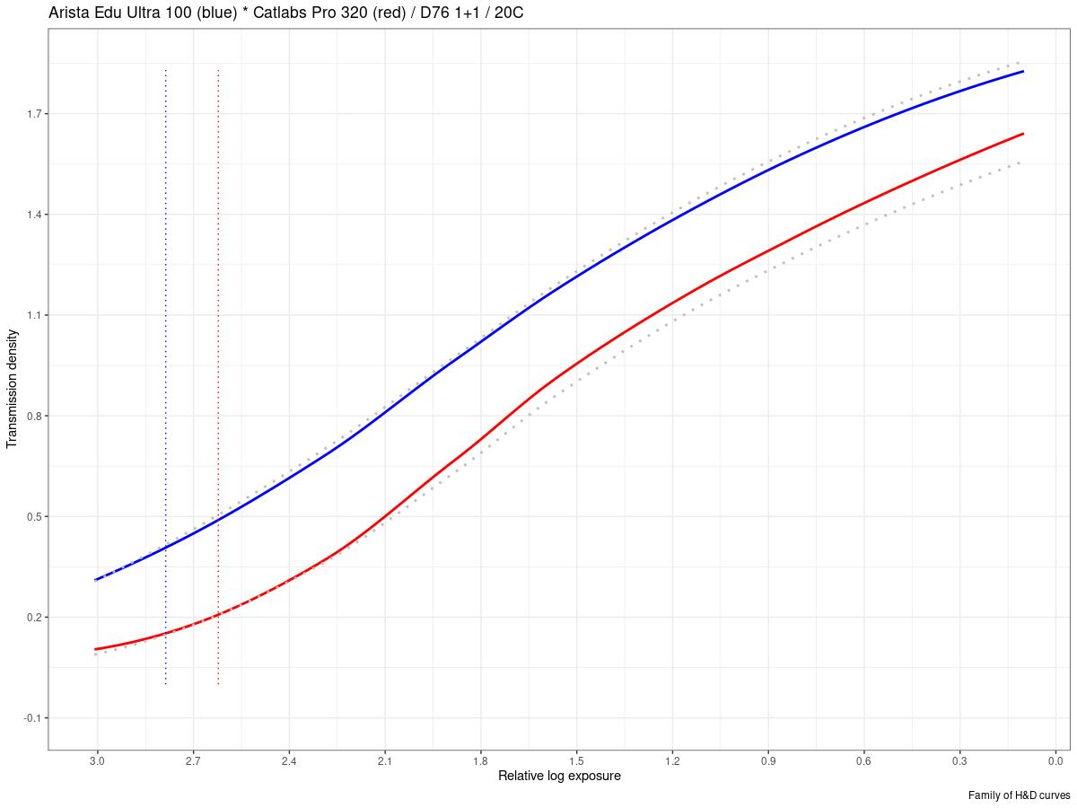

@aparat. Kudos for performing these sytematic tests. However, I have a question re: your determination of film speed from the logE-D curves as shown on your post #53 above
Skipping other "details", the speed is based upon the point on the curve at Base+Fog+0.1. But your measured exposures do not reach low enough values to measure Base+Fog.

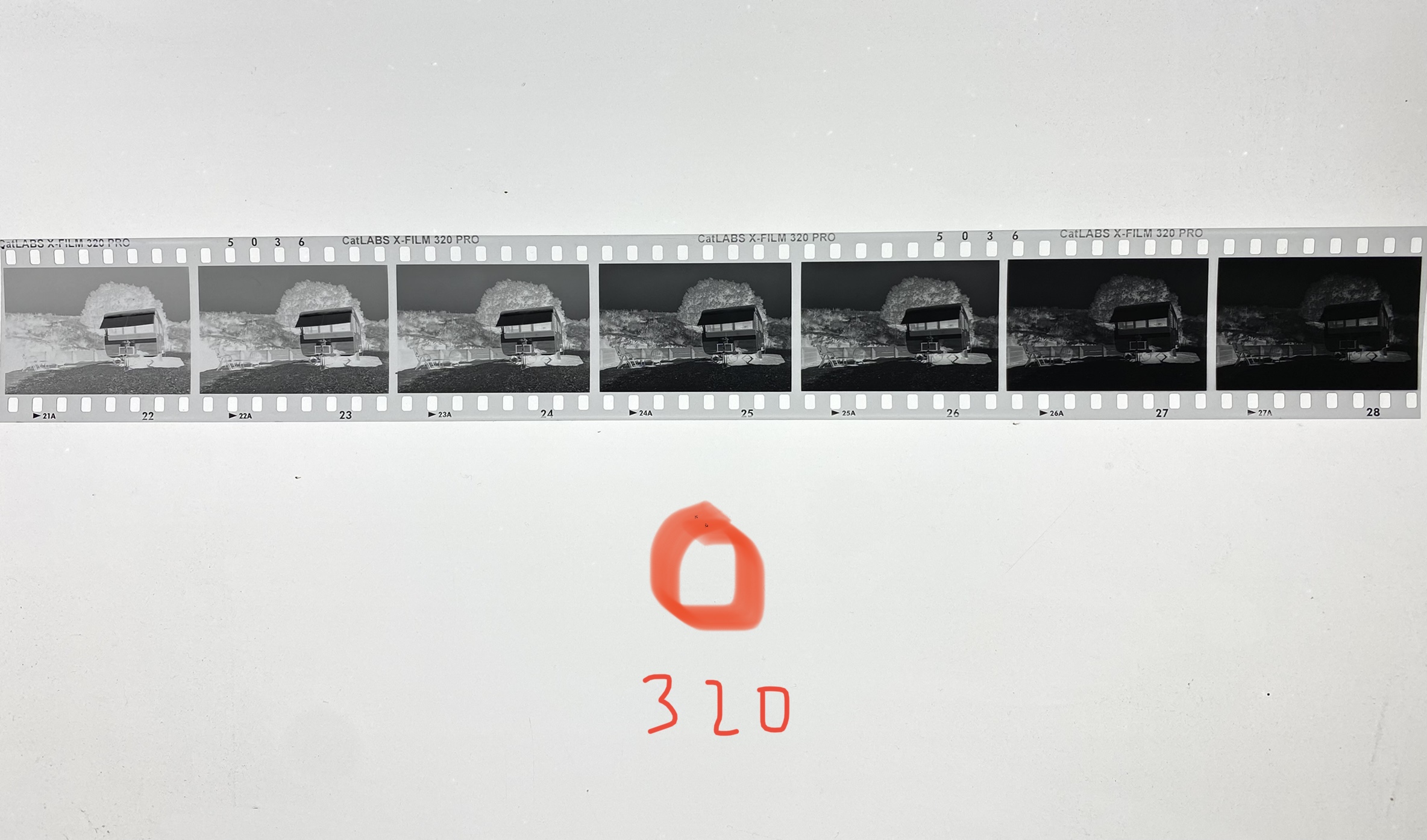

Here's the set. Three stops either side of the "0", or 320 ISO on my Sekonic meter. Somewhere between 320 and 640 for these would be pretty nice. 200/160 is a little crispy.
Thanks for sharing that! I inverted your image in Photoshop to try to judge the lighting conditions and it helped as I have an easier time looking at positives than negatives. Anyway I think you're getting decent shadow performance of that left wall at 160 and 80. Controlling the highlights at those lower speeds would be an enjoyable experiment. Good fun, this thread.
Perhaps it is the graphing software, not showing the whole dataset. Which brings up the point, is the software available? I have constructed my own EXCEL spreadsheet to automatically find the parameters, but it is very much like a house of cards. One click in the wrong spot could destroy its function and take weeks to figure out. Not a fan of any Microsoft product.
To me, those look over-developed. Which isn't particularly surprising, given that I expect that was what was being targeted when CatLabs arrived at with its recommendations. Negatives that I find to be under-exposed and over-developed. Those sort of negatives appear to be quite popular now.

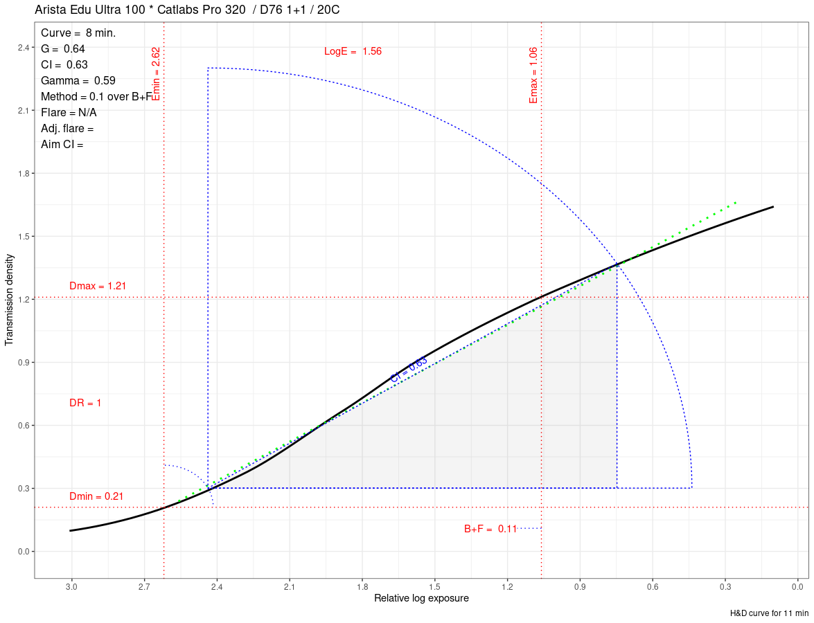

I find Ilford "Relative log exposure" more intuitive as more exposure results in higher negative density. Kodak, Foma and many other film manufacturers use this convention.
Yes, I happen to agree with you. I've seen it done both ways in the literature. Please, see below for a more detailed explanation.
Could you post your software to a new thread? Some of us would appreciate being able to compute ISO, CI, etc., from densitometer measurements. I hope the software is written in a popular language with free compilers/interpreters such as Python, C, C++, or even Fortran.
Yes, I will be glad to do that. I originally started writing it to offer a free, web-based, alternative to Win Plotter, the excellent Windows application meant to be a companion to the Phil Davis BTZS textbook. That was three years ago. Then, my illness got suddenly worse and I was bed-ridden for close to three years. I started getting somewhat better earlier this summer and decided to resume working on the program. Now, I am not so sure I want to only follow the Win Plotter conventions. I think I'd like to offer alternative modes of analysis, so that's my focus now. As to the language, I am planning to use Shiny, which is a (mostly) JavaScript library meant to bring data-driven analysis apps to the web. The back-end can be written in R or (more recently) in Python. Currently, Shiny has the best compatibility and features for R, so that's what I am working on at the moment, but that may change. I still have a lot of work to do.
Am I correct in understanding what you said about the measured exposures do not reach low enough values to measure B+F that there was too much exposure? You have a very good eye. Yes, ideally, the toes would be longer, but this was just a test run to establish how much exposure the Catlabs film needs to produce well-formed curves. There will be more analysis coming after I buy more film. The Catlabs B+F is 0.1and the exposure does produce this density on the first step of the step tablet, which is then plotted. The Arista film's B+F is 0.3, which is high. I am not sure why it's so high. I just bought this film fresh and ran the test twice to be sure. My old Arista negatives are around 0.28. The first step of the step tablet reaches the density of 0.31, so it is 0.01 higher than B+F, which is within the margin of error for my densitometer, so I just let it go. Is that what you mean?
So, the the Catlabs film, B+F is 0.1, the speed point density is 0.2, and for Arista it is 0.41. The relative log exposures for the speed points are 2.79 and 2.62, respectively. This setup is not professionally calibrated, so the results are probably only within 1/3 stop, as @Romanko pointed out. Also, please note that these numbers come from measuring the "ISO" predicted curves (curves that have the G of 0.62), not the actual curves. Hope that answers the question.
Hey, this looks fantastic! You have everything one needs to do film testing, nicely and clearly presented. I hope to make the software available at some point, but I am still far away from the finished product. There's currently no GUI at the moment. Once I have something presentable, I will share it.
This is a very interesting progression. Thank you for including it! It seems Rodinal 1+25 time, temperature, and agitation provided by the manufacturer work out perfectly for you. I wonder whether the 1+50 of 19 minutes gives the same contrast. Have you tried 1+50, by any chance? Also, I cannot tell from this picture, but is this a scan or a photo on a light table?
I haven't tried 1+50 yet. It would be my preferred dilution for this speed film, but 19 min seemed like a very long time, and the 9 min for 1+25 seemed more reasonable, so I started there. Once I zero in on what the film can do, I will try 1+50 next.
The pictures is an iPhone shot of the negs on a light table.
I agree they are over developed. I just shot a half roll at 320 and reduced the development time by 10% (still with Rodinal 1+25). Results are marginally better, but very marginally. Highlights are still pretty brittle.
I am thinking that a compensating developer might help to tame this...I have some Diafine I could try.
But, I am also thinking that this is a losing battle - I think the film is just plain high contrast. There are better films if you want a wider tonal range.
I can see using this film for a particular look, in particular circumstances.
I'd still like to see more results with a meaningful amount of more exposure, plus less development.
Matt, I agree and I am working on it. I should have a family of curves ready sometime next weekend. They will be based on what seems, empirically, to be the "correct" amount of exposure for standard film testing. I will also try to take a few photographs to go along with the data.
I look forward to both.
After posting my comment #76, I thought maybe you had measured B+F outside the step wedge, in an area totally not exposed (which is the correct way). Or, as suggested by ic-racer in post #78, "Perhaps it is the graphing software, not showing the whole dataset."
But the numbers that you state above (blue text) show that you just take as B+F the lowest exposure point in the step wedge. Most obvious is "The Arista film's B+F is 0.3" (blue curve). I find it hard to believe that the blue curve, if measured further to the left, would not reach a density level of 0.2. Can you please, if you have not already done so, measure B+F in a film area that was totally un-exposed?
If true, that would mean that the Arista film's speed point is further to the left, i.e. its speed is higher; and, even if the absolute photometric calibration is not correct, that would also mean that the Catlab film is even slower relative to a "ISO100" film.

@aparat. But your measured exposures do not reach low enough values to measure Base+Fog.
They do not need to be, if for instance one has established already the B+F-density in a seperate test, outside a sensitometer. It then would be sufficient to have graded exposures above that level and below the qualification level.
Did you read the whole of my post?
Did you read this from aparat:
Implying (pending confirmation by aparat himself) that he derived the B+F from the curve(s) as displayed, at the leftmost point.
Do you really believe that the blue curve (Arista) if extended to the left (by proper measurements as outlined above) would not go below D=0.3? Hardly any sign of the toe region beginning.

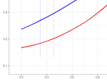

Thanks for your questions! It's great to have them, they bring more detail into the thread. Let me see if I can answer your questions. Yes, the entire data set is plotted here. And, yes, I always measure B+F on a clear part of the film. My "sensitometer" has a piece of opaque plastic off to the side of the step tablet to make sure it is not exposed. See the image below, clear film patch marked with an arrow.
The Arista film, as I mentioned earlier, has a very high B+F, of about 0.31 - 0.32, subject to the error of my sensitometer. So, the toe is very short. The first step of the step tablet does not reach B+F by approximately 0.01, which I ignored because its within the margin of error. Simply put, the Arista film received too much exposure to produce a well-formed toe. However, the Arista is only meant to provide a point of reference for the Catlabs film exposure. That was the whole point, namely, to establish the "right" amount of exposure for the Catlabs film and to compare it another popular film, which I'd tested before and whose performance I am familiar with. I concluded from this initial test, that I need to reduce exposure by about 1/2-2/3 stop to get a long enough toe for precise analysis.
And, yes, you are correct, the Catlabs Pro 320 does, indeed appear slower than the Arista Edu Ultra 100 by about 1/2 stop.
This may have gotten lost in this thread, but I ran the original test using a calibrated and certified sensitometer, giving the Catlabs film the "correct" amount of exposure for an ISO 200-320 film. I ran that full test twice, and spot-tested the film the third time, to be sure. I also compared those results to Neopan 400 and 400TX. The Catlabs film turned out to be much slower than either. You are absolutely correct that the long toe makes curve analysis very difficult and somewhat unreliable. However, I could not use my sensitometer to test the film further, as it does not allow for the change in illumination levels, only in duration. I would have to expose the Catlabs film for a calculated exposure of 2-3 seconds. Without knowing reciprocity data from the manufacturer, that would have been futile.So I constructed a DIY sensitometer to give the film a lot more exposure, this time for the shutter duration of 0.25 sec., so there's no contribution from reciprocity failure. The curve you're referring to, was obtained with that DIY device. I am including a more detailed plot of the Catlabs curve, so you can see more easily some of the important parameters.
How do I explain the apparent discrepancy between my results and those of others? I can't without running the full test yet again, this time, with the "correct" amount of exposure, such that we get a well-formed curve family. I am currently working on that, but it will take me at least a week or two to complete. I might also try to do a rudimentary spectral response analysis.
To sum up, in my tests, the Catlabs Pro 320 is consistently slower than both Kodak 400TX and Arista Edu Ultra 100. Once my test has been concluded, I will make available a full report, including multiple methods of measuring film speed and the raw data, so that anyone here can run their own analysis, with their own tools. Then, and only then, could we reach any sort of conclusion as to what the Catlab Pro 320 film speed is, what its performance is, in general, and response to development time, in particular.
