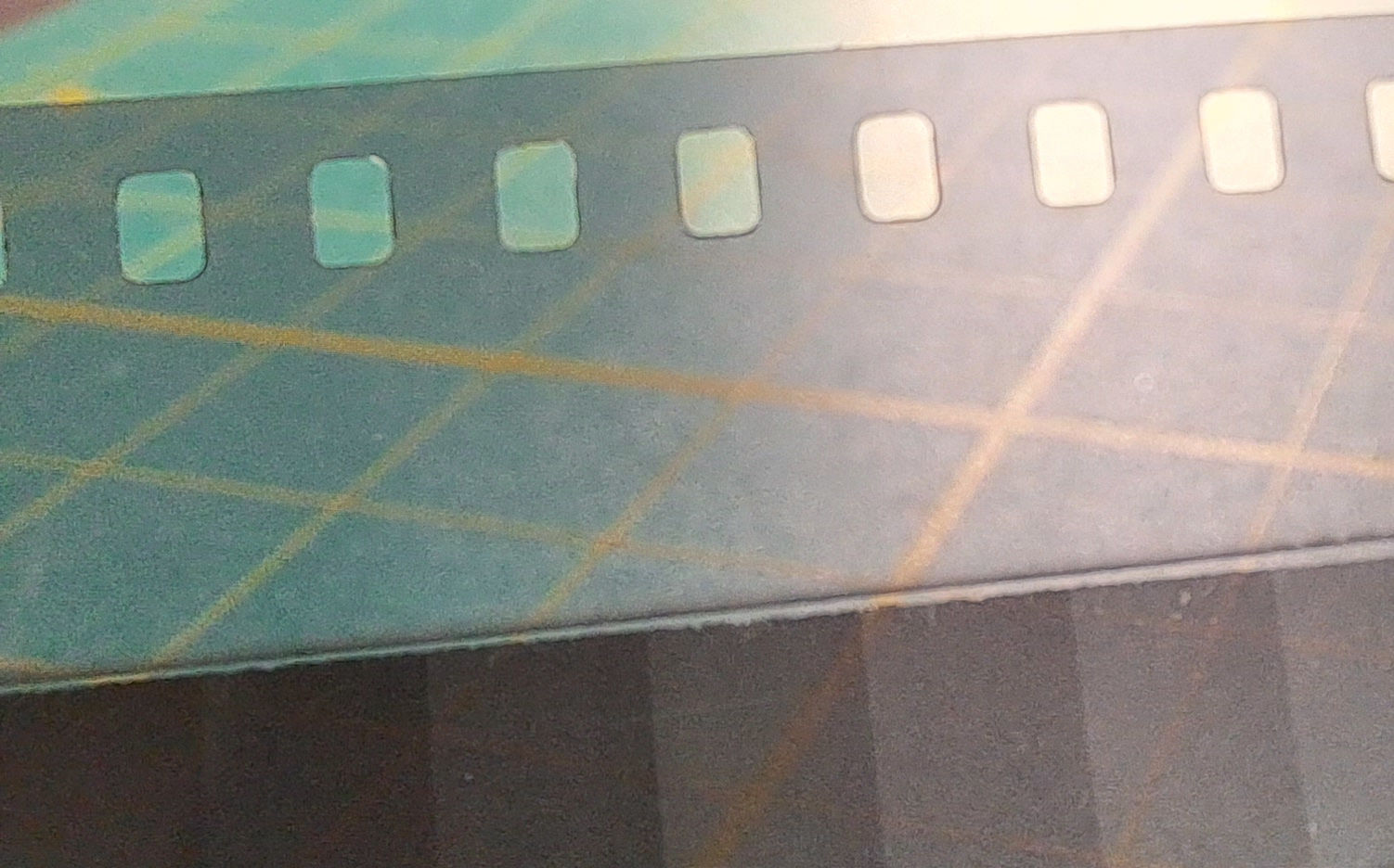

First roll out of the soup, drying. First impressions:
1. Speed seems to be around 200. Close enough for snapshot use, anyway. I shot it in my 1932 Leica II, so not the world's most accurate shutter. Next roll maybe in the FM3a.
2. A touch contrasty in Rodinal 1+25, in spite of the Elmar 3.5cm lens. Will try 1+50 for the next roll.
3. Base does pipe some light, so best to load in subdued light if possible, or burn off an extra frame when loading.

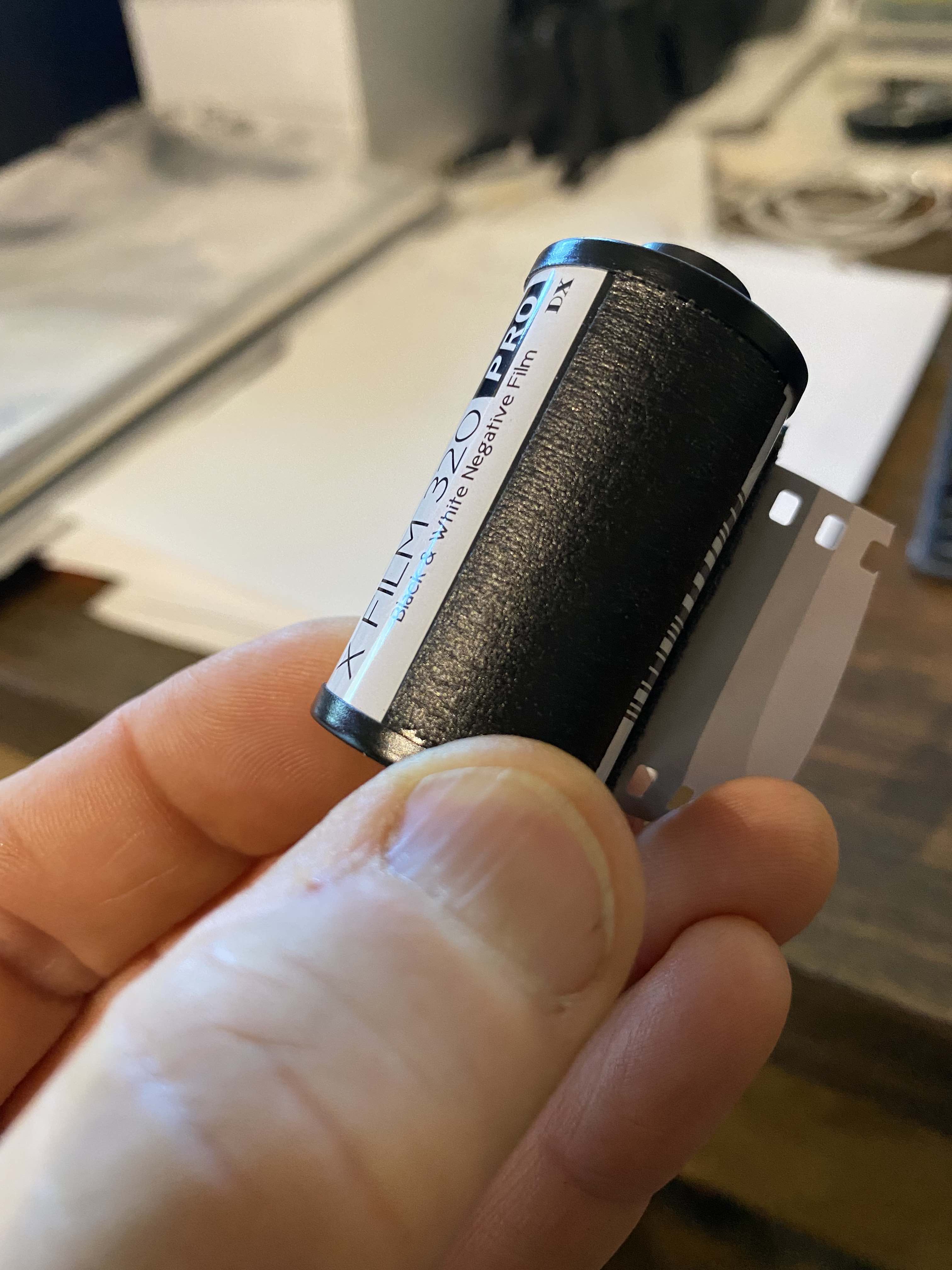

Oldwino just out of interest was the DX code covered and if so by what such as electrical tape, white label? Was the cover removable and if so what was the code underneath?
Thanks
pentaxuser
Thanks
pentaxuser

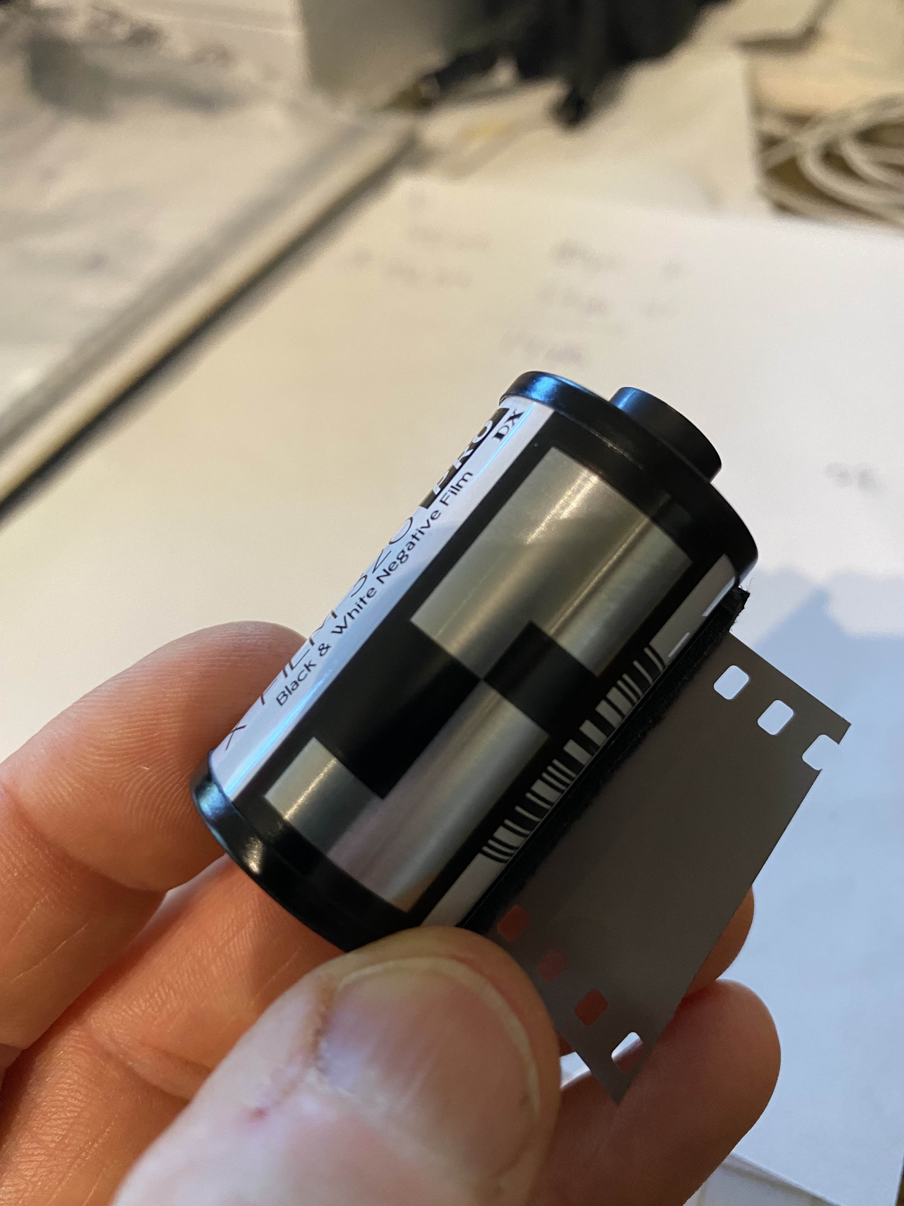

The DX code was covered in black tape. The cassette is printed with the CatLabs logo and info (ie not a sticker on a generic cassette), so I am assuming that maybe the cassettes were mis-printed with the wrong DX code and a piece of tape was the most cost effective solution.
I do not know what the DX reads as.
View attachment 318546View attachment 318547
If I'm reading the dx coding info that's on wikipedia (here: https://en.wikipedia.org/wiki/DX_encoding), its 640 iso, 24 exposure, +3/-1 exposure tolerance
I think you're reading that upside down, to me, it looks like 1250 ISO, 24 exposure, +2/-1
They have the cartridges on their website photo without the tape, it's the same. In any case, not correct for the film.
Oop, you're right, I was reading it upside down 😂

Thanks for that reply Oldwino. So that's 2 users with black tape and a DX of 1250 and if I recall correctly one with white tape instead but as that person was not in a position to check the DX code underneath until after he had developed each cassette he could not tell me what he code was underneath at my tome of asking
Did anyone ever make a film with an ISO of 1250? Certainly I cannot recall any such film. I suppose a DXcoding machine may have produced 100s or 1000s of cassettes with a wrong coding before it was noticed and CatLABS was able to get these very cheaply for its use

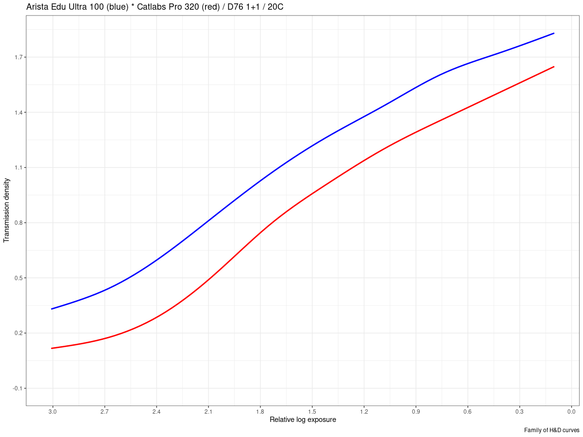

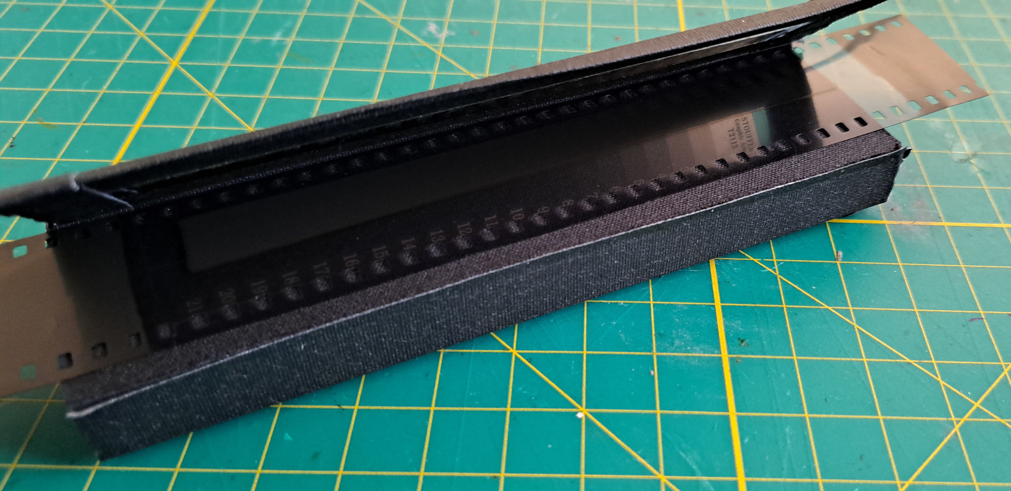

I have a minor update to make. I have been working slowly (not much free time these days), so data will be coming infrequently. I am also running out of my supply of Catlabs Pro 320, so I will have to buy additional rolls of 35mm in the near future.
My initial test was disappointing because the film ended up being severely underexposed. Analyzing film curves with such long toes is difficult, and their interpretation somewhat unreliable. Clearly, the amount of exposure needs to be significantly greater than that required for an ISO 200 film, at least under my experimental conditions.

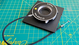

I am, therefore, running another test. This time, I am giving the film a lot more exposure than the recommended ISO 320 or EI 200. Unfortunately, it's not possible to do reliably with my calibrated sensitometer because I would have to use exposures in excess of 2 seconds. Without knowing reciprocity data from the manufacturer, such a test would be futile.

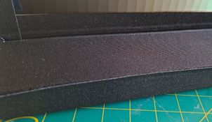

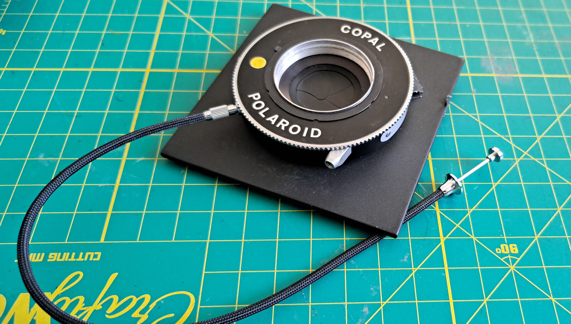

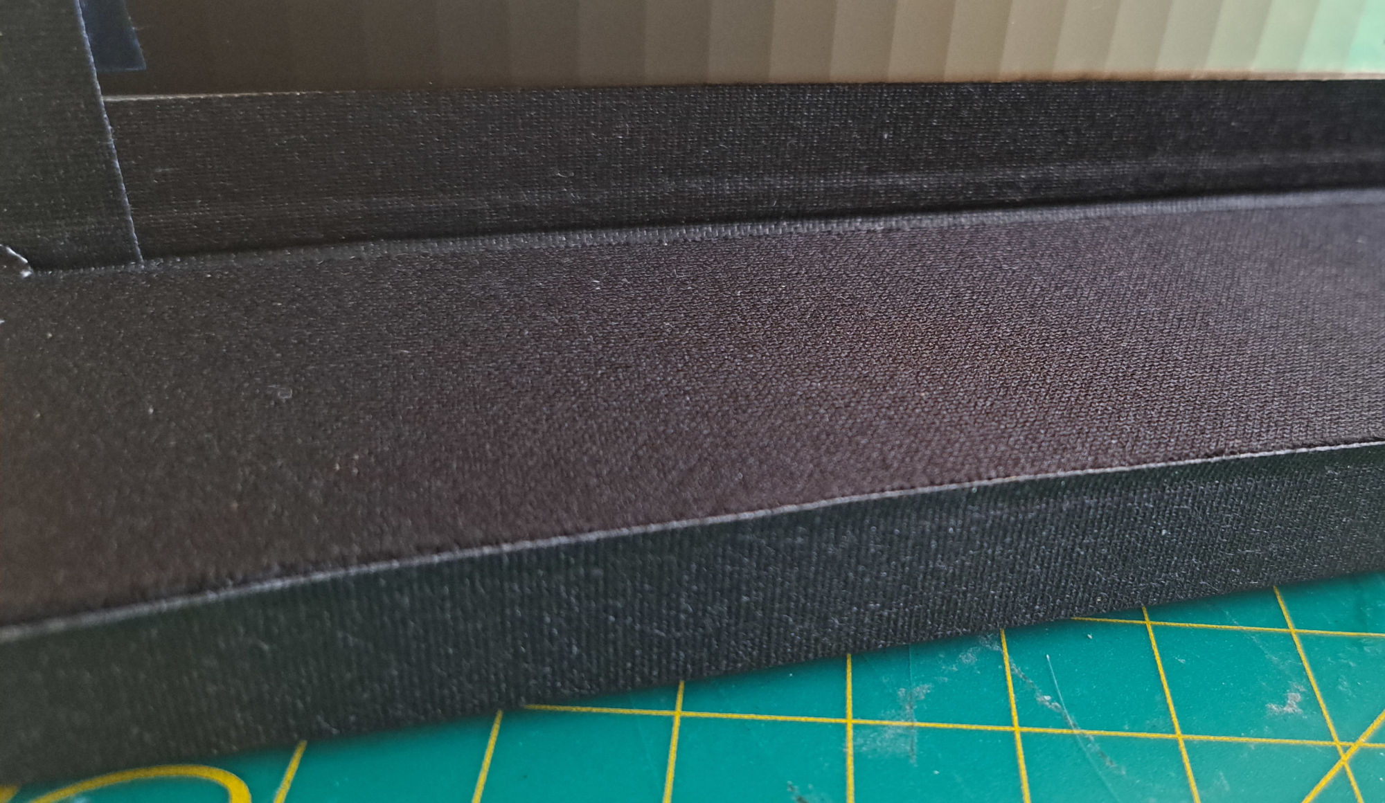

So I constructed a makeshift pseudo sensitometer. It is very simple, but I think, given my test results so far, it's reliable, at least, in giving consistent exposure from trial to trial. I am using an enlarger with a condenser head. Underneath the light source, I placed an 80A filter. Then, I have a recently CLA'ed Copal shutter installed on the enlarger lens board. Just a shutter, without a lens. I am using the shutter speed of 1/4 sec. I have tested it, and, indeed, the shutter is open for almost exactly 0.25 sec. I measured the light level on my enlarger base board to be around 23 Lux. I attach a few pictures of the contraption.
I must emphasize the fact that this "sensitometer" is not professionally calibrated. Therefore, its data cannot be relied upon to give absolute exposure values. However, it can be used, I think, to give a rough idea of film performance (including estimated film speed, CI, G, Gamma, etc.). But, more than anything, I think it can be used to give a decent idea of relative performance, as in, for example, comparing two (or more films).
To establish a baseline, I used a strip of Catlabs Pro 320 and Arista Edu Ultra 100 (both fresh). I used the exact same exposure and developed both in the same tank in D76 1+1 at 20C for 8 minutes in a rotary processor. I am attaching the curves of those two films obtained in this first test.
I think that this is roughly the kind of curve that we can expect from Catlabs Pro 320, given enough exposure. I think that current amount of exposure is appropriate to run a full film test. If you disagree, please let me know and I will be glad to adjust the exposure accordingly.
My preliminary findings from these two curves are that the "speed point" exposures are around 2.7 for AEU100 and 2.41 for CPro320, respectively, so the rough difference in film speed seems to be around one stop. In this non-calibrated test, I am getting around IS0 70 for AEU100 and ISO 35.7 for CPro320, if developed to the same average gradient of 0.62. Also, note, AEU100 has much higher B+F density than the CPro320, hence it is "higher" in the plot.
There's a lot more data coming...

Yeah. I saw that people are getting results they like by exposing at EI 200. I don't doubt it!
As far as the "actual" ISO speed is concerned, I am much less concerned about the actual film speed number and more about how one film compares to another, especially one that has been around for many years and one that a lot of photographers depend on for predictable results.
Thank you for the link to the video! That's a fascinating technique. I remember seeing something similar in an old video by Fred Picker a long time ago. It seems like it's particularly useful for an all analog workflow. Fred Picker got ISO 140 from 35mm Tri-X, developed in HC110, if I remember correctly. I am still unable to make prints in the darkroom, but perhaps another forum member could give it a shot? It would be great to have data from other people to compare with.
Could you please provide a bit more details how your sensitometer works? Do you have a calibrated step-wedge that you put in front of the film as is done in commercial sensitometers? Or do you have a slide that covers parts of your film as your make multiple exposures (similar to how you would do exposure tests strips for printing)?
