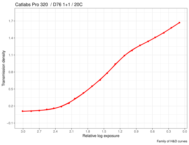

Okay, to bring this thread back to its original topic (I apologize for my earlier departure), I have a first curve with, what seems to be, the right amount of exposure. The toe is what I intended, which means the first two steps of the step tablet are B+F density, and then it starts climbing. This was 8 minutes in D76 (Kodak) 1+1 at 20C in a rotary processor. This is just raw data, no analysis, yet. This is it from me for now. More, hopefully, next weekend.
The lower slope in the right third of this graph means the film is "self-compensating" (a term I just invented). That means to get compensation, you don't need to use Diafine; this film compresses highlights for you. That aspect of this film could be beneficial because the human eye is less sensitive to shadow contrast than highlights. Therefore, it's best to have more contrast in the shadows, as that curve portrays. If that curve retains its shape when the film is not overdeveloped, I'll be tempted to buy some.
