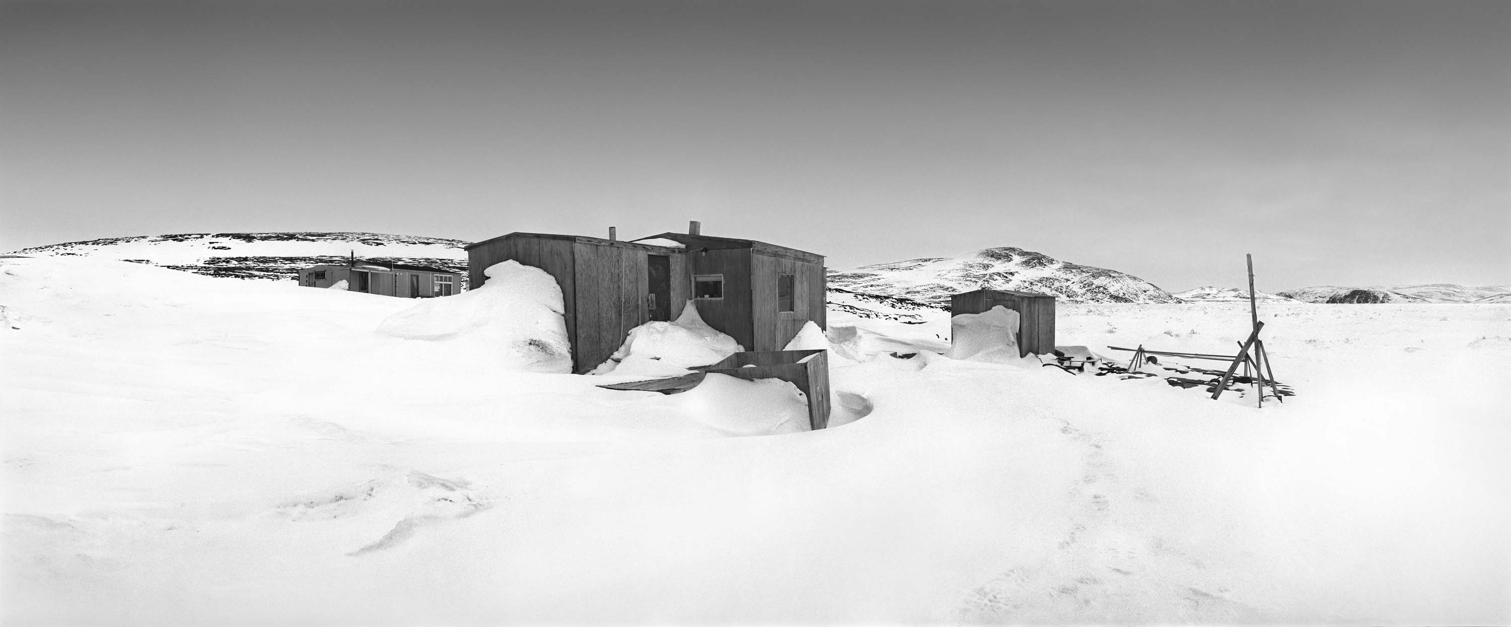

Where was that taken? Are those fishing homes by a lake?
Those were taken in the Arctic - they are Inuit fishing shacks near the Hudson Strait.

looks like one of the abandoned research stations of the Antarctic...definitely not a Calgary ski resort in the sunshine
Hah close. It's an Inuit village in Nunavik Northern Quebec

Great eye - yes that was taken with a Noblex 150UX :smile:

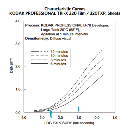

Maybe placing zone II around the left marker, and zone VII around the right-hand marker would provide expansion of snow tones without excessive density range on the negative.

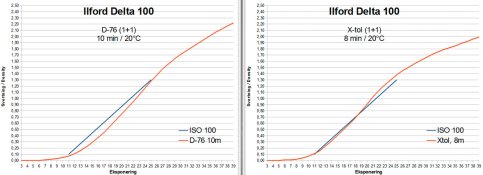

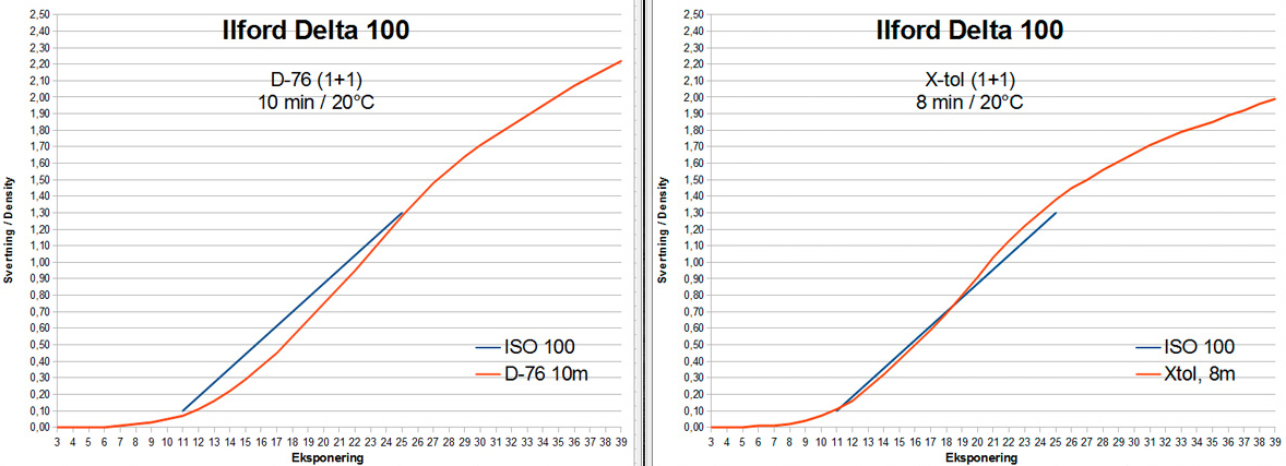

I worked extensively with Cone Editions in Vermont and we couldn't get any more separation from the negatives of the snow scenes no matter what curve was thrown at them; sadly the information just wasn't there. I had taken digital proofs with my iPhone before shooting them on film - and the iPhone was able to record the subtle changes in contrast - so they do "exist" - so there must be a way of recording them on film. What do you think about using one of those very high contrast document films, or Rollei Retro 80S ? How would the extended red sensitivity effect a whiteout winter scene ? I need to brush up on my knowledge of film density and the zone system.. Do you have a link to that Xtol information?
Xtol 1+1 and Delta 100 seem to cause quite serious highlight roll-off if you start to push your exposure up the scale - I've attached screenshots of the comparator curves available here. There are caveats - I recall finding some of the Fotoimport results have been developed for slightly wayward times etc, but they do give a useful snapshot. The other point is that as you extend development times you'll steepen the midrange and enhance the roll-off, exaggerating the results into the highlights that are already causing the muddying of details in the higher scale which you are currently dealing with. It also explains why I was a bit puzzled by the Xtol results you were getting compared to what I know Delta 100 does with D-76 and Rodinal. I would however say that my suggestion of TMax developer stands for what you are wanting to do - but that T-Max 100 and T-Max developer might together act to kick the tonal separation up a notch - again the Fotoimport results may seem a bit confusing, but if you adjust the dev time for TMax 100 so the midtones match (9-10 mins, going by Kodak's data, I reckon - see pg.8 and pg. 9), you'll get significantly stronger - even exaggerated beyond linear - highlight separation than Delta 100 and TMax developer give. It's for situations like this that TMax 100 was designed - it just requires a bit of common sense in its usage, rather than the often very casual/ outright sloppy approach people had to the exposure & processing of 100 speed films in the (now quite distant) past - TMax is older than I am!
I'd avoid the Rollei film - it's an Agfa aerial recon film that is a fair bit slower than box speed at sea level - and it doesn't seem to hold linearity through the highlights particularly.

This is great advice, thank you. Now that we finally have snow In Montreal I'm going to shoot a few test rolls and report back!

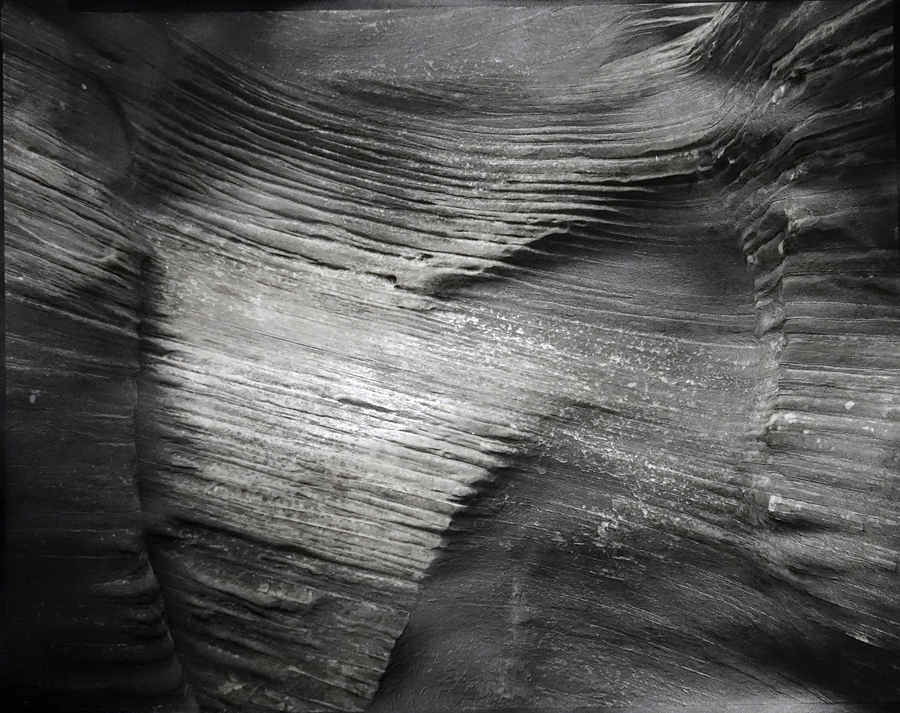

I had missed this post -- Copy Film 4125 is a unique product...I treasure my remaining 8x10 sheets. I have used it to greatly expand the density range when photographing scenes with little range...but usually of darker values instead of snow scenes. It just does it so nice and smoothly, it seems. Exposure has more affect on contrast than development.
Wonderful film...RIP.
8x10 carbon print. Many Pools Canyon, Zion NP, 2018. This scene was not necessarily flat, my meter read 9 to 12, but I prefer much more contrast to match the process I use.

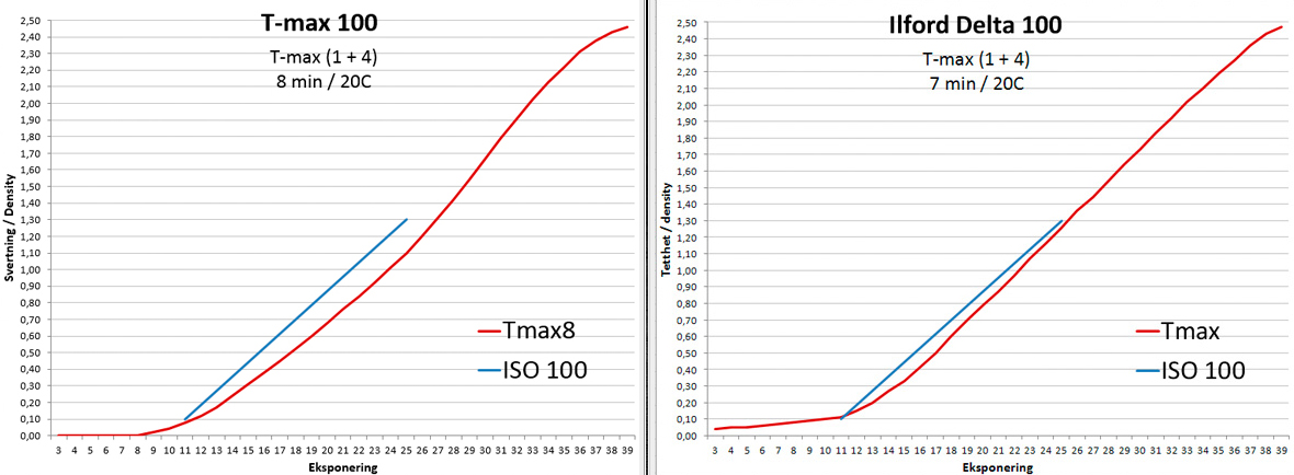

None of my local shops have T-max 100 in stock so I had to order some online. I did notice they have the new fuji neopan acros II. Would that be a good film to try? And if so with what developer?
Fuji seem to have published some data for Acros II - it looks like it does upsweep a bit in the highlights, even in D-76 (Microfine is more or less Perceptol/ Microdol-X, Super Prodol is more or less Microphen from what I recall). Might avoid Xtol as it seems to be intended to dampen highlight density to make negs 'easier' to print.
